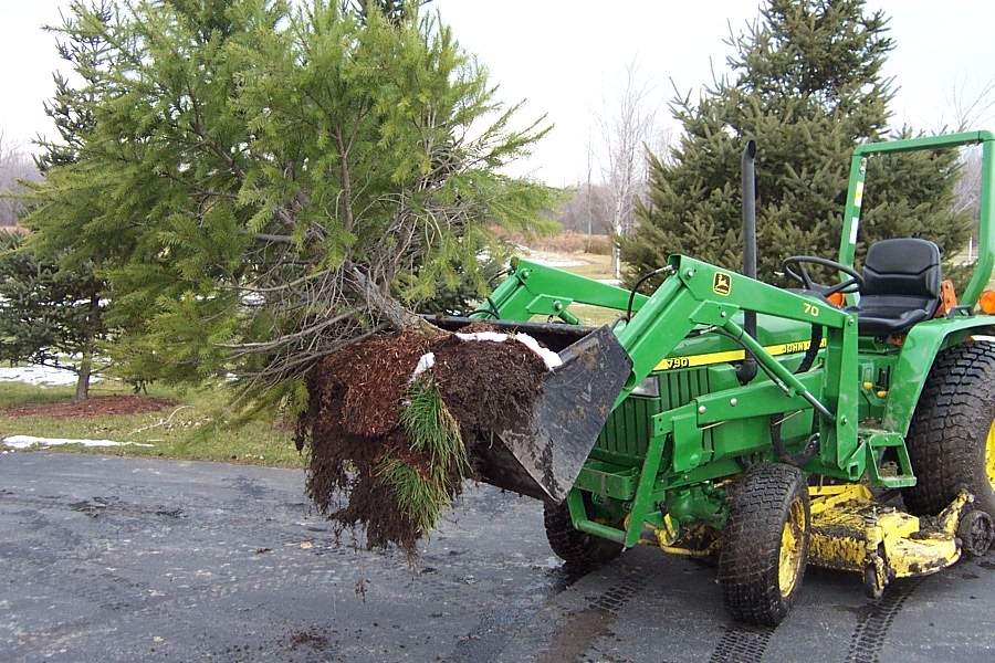

Greg,
Here's a shot of a tree I transplanted two weeks ago. This was pure FEL action. I now have a toothbar and am dying to try it out!
