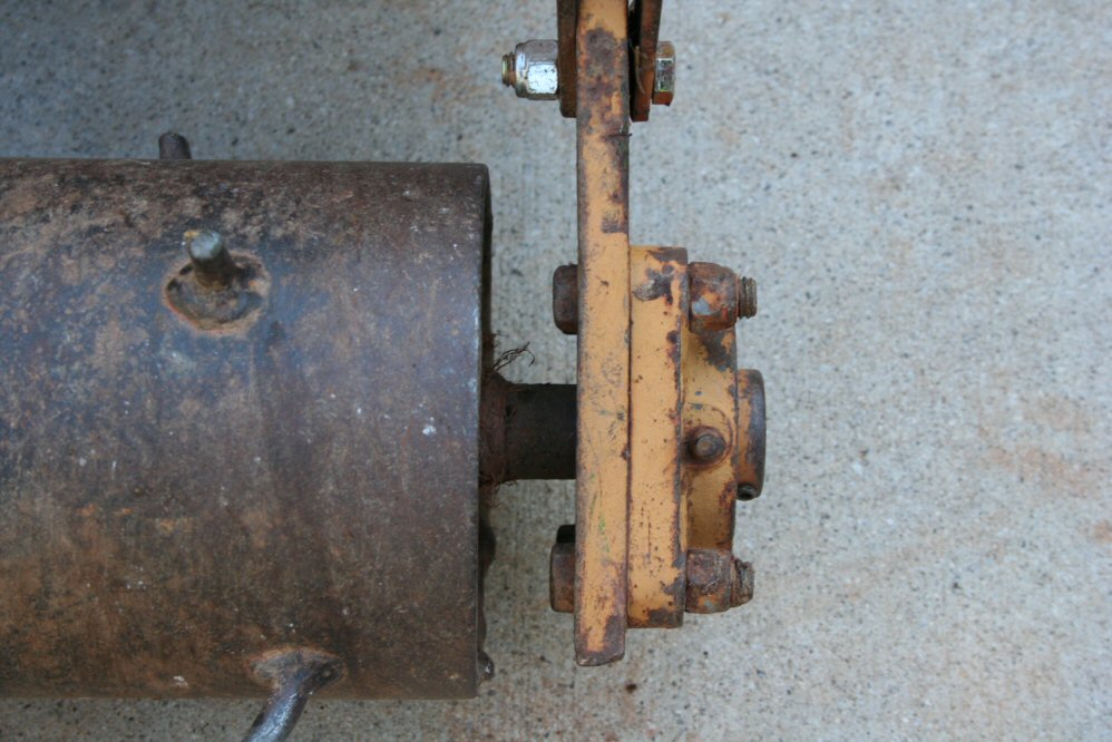

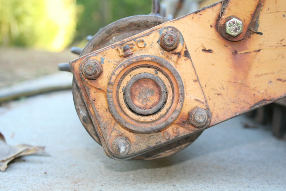

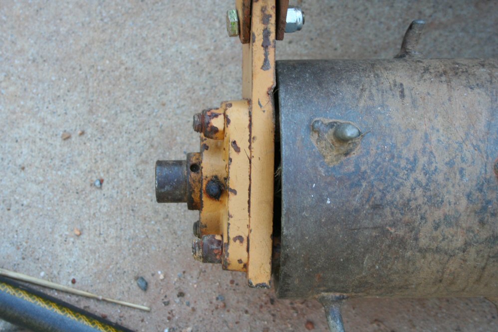

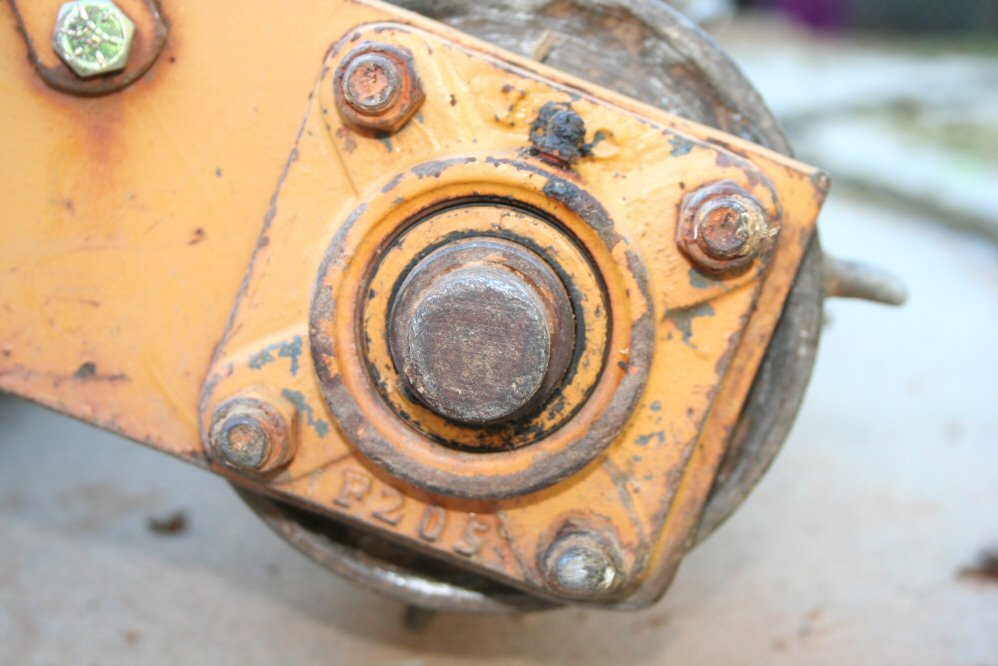

The only real problem I can see with it is the roller has been installed off center. On one side, the roller shaft sticks through the bearing about a 1/4" and on the other side, it sticks through about 1 1/2". It still works fine, but the roller hits the arm and has worn a groove in it.
I loosened the set screws that hold the shaft in the bearings and hit it a couple times with a 3lb sledge hammer, but it didn't move at all. I can't see any way to get a puller on it so my question is how do I get the bearings off the shaft?
For what little I will use it, I don't want to pay a shop to do it, but I also don't want to continue until I tear it up.

After looking at the pics, I would start by torching off the bolts that hold the bearing block in place on both sides. Then (last pic) try driving a chisel-prybar between arm and bearing block. You may have to take a grinder and dress up the end of the shaft, it may be mushroomed, see if you can heat bearing race next to shaft and work it off. If too much effort involved, probably better to just cut bearings off, dress up shaft and install new bearings.
Might be able to grease real good and just use it as is. Does the roller turn at all?
   / Removing roller bearings from Bush Hog pulverizer
The bolts come off. I've had them all off and they came off pretty easily. I think I'm going to try a bearing splitter before I do anything that'll cause damage.
I'm sure the bearings need to be replaced, but the roller stiller turns without any effort. The biggest reason I want to remove/replace them is that the roller rubs the arm. You can see that the bearings weren't installed at the same place on both sides. If you look at the left top picture, you can see where the roller touches the arm. I don't have a picture of it, but the roller has worn a nice semi-circular groove in the arm.

I think you are on the right track. The bearings just need to be slid over or replaced. Looks like they need to move over 3/4" or 1". Heating the bearing and then use a press or pipe over the shaft to move the one bearing inward. The other bearing that needs to move out will be more difficult to get behind. Try to apply the heat to the bearing and not the shaft. Could the bearings be held in place by a set screw or collar with set screw?
There are set screws, but I got those out. I'm going to price new bearings and if they're not too much, I'll just replace them. Otherwise, I'll try to pull the one side out enough so the roller doesn't rub the arm.
