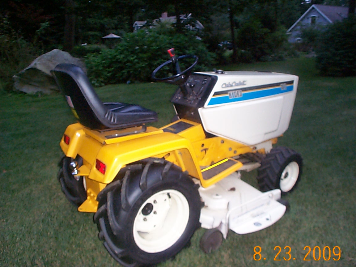

I did that on my 1811 - see the pic - I was lucky to find a guy on CL that had a 3205 that he got with lug style and he wanted turf so sold me his rear tires plus his front lug tires on the wheels for $250.
It rides a little rougher but the traction is better. It's not a hard job to R&R the tires - just use some bead sealant on the new ones when you put them on it will be easier.
