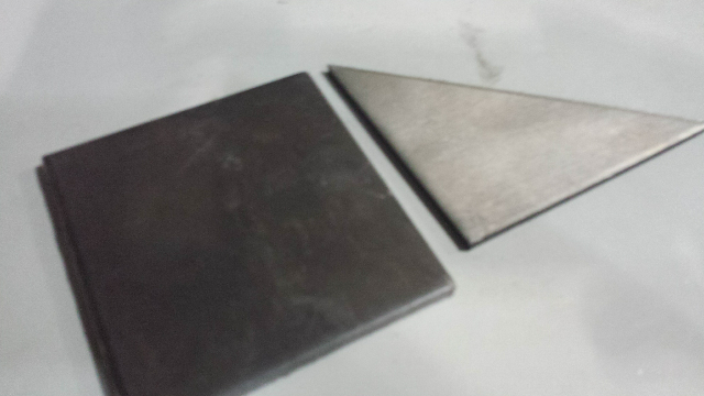

I soaked a piece in red vinegar at work today for about 4hrs. Already started working. Ill ?show a pic in the morn. If all goes well i know a family friend that works at a restaurant supply place and gonna see if she can get me 5 gallons of the 20% stuff. Its already working good on the edges with the 5% acid red stuff in short order, so i know its gonna be a homerun! :)

Well here's my results with the 5% stuff. Worked like a charm and wiped right off. Left it overnight.

Yep the 5% works pretty well. Am going to check out Walmart today for the 20% stuff and see how that works. Maybe they have a sale on apple cider vinegar! Thanks for those tips. For the time being I am not looking into other possibilities. Vinegar is cheap, safe, and does a good job.
