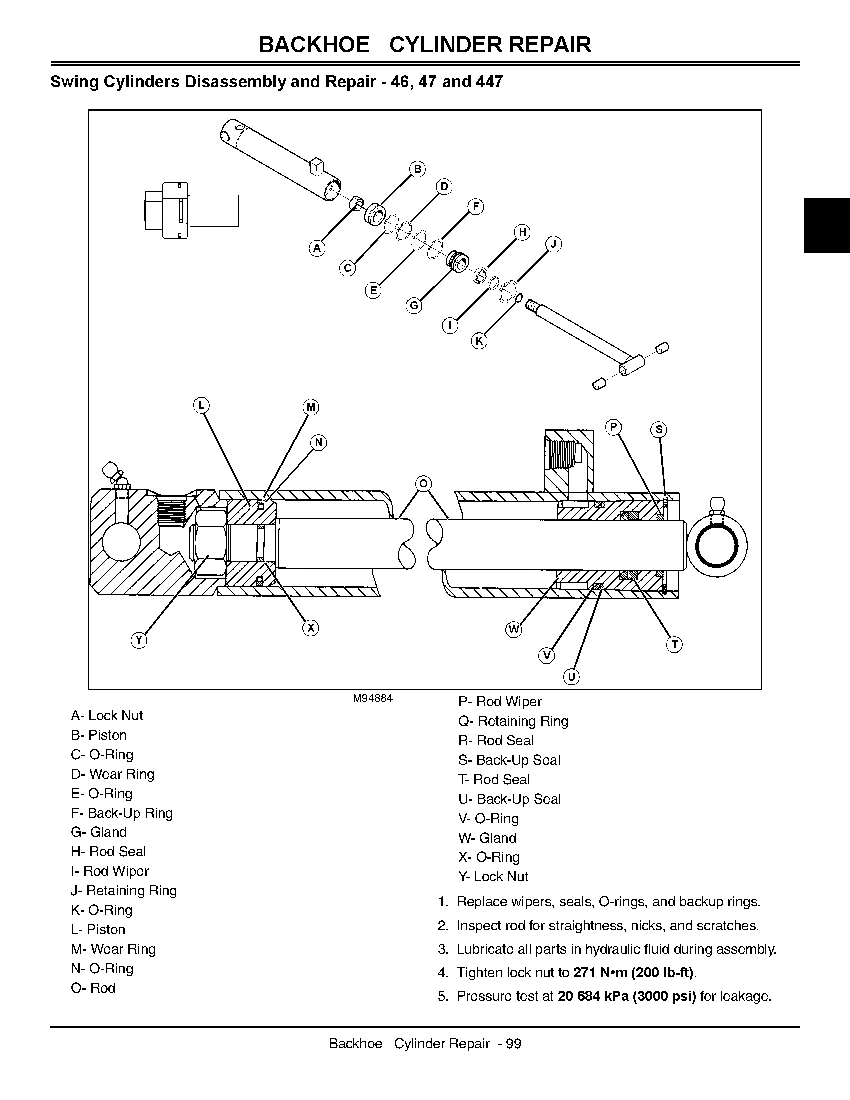

Hey all, i need to have a hydralic cylinder repaired on my 447 backhoe, the one that moves the boom side to side, bottom left if your looking at the hoe from behind the tractor. it looks like it shouldn't be hard to take off, just remove the pins and hydraulic lines. are there any hang ups i may encounter, any tricks i need to know about. i've worked on cars for years, but never tractors, trying to do all my stuff myself on this one. thanks again. oh, its leaking so i think the seals need replaced. any input would be greatly appreciated. thanks

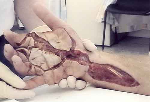

Make sure the system is depressurized before you crack open any fittings.
You don't want to risk a hydraulic fluid injection injury like this picture that J_J posted in another safety thread.

What they said. Since you are going to R/R it yourself, are you going to rebuild it yourself also?
I would suggest doing both cylinders while you have it apart.
