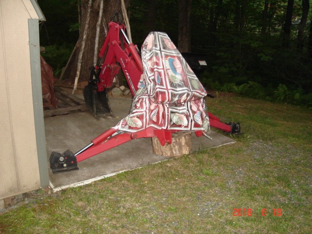

Phil is correct... those down rigger arms will settle, so best not to rely on them to hold things up. I also use a chunk of a log to put under the BH. Last winter, I had the down riggers fully retracted for storage; this will work, as long as your base is stable.
If you have hydraulic line extensions (or even better-- longer hoses; great idea, Phil!), you can back up near the BH, connect and then use the hydraulics to raise the BH for re-mounting. I won't lie, re-mounting the BH can be tricky -- it just takes practice. I also have a concrete pad to set it on, which makes it easier, but I've also set it down (on the log piece) on the ground, too.

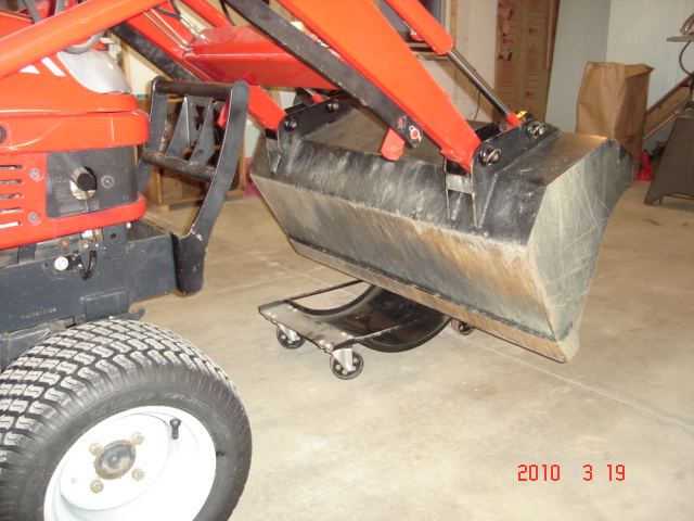

The bucket loader (FEL) is very easy to remove and attach, again if you have a concrete area to do it. I use a flat 4-wheel dolly, which allows me to position it in the garage after removal. After setting the two storage legs down, I lower the FEL on to the dolly. I now have it down to 3-4 minutes to drop it or re-mount it.

Here's a few pics of "storage" mode-- hope this helps.

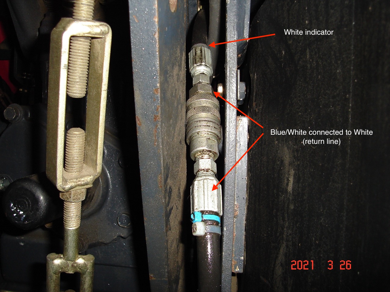

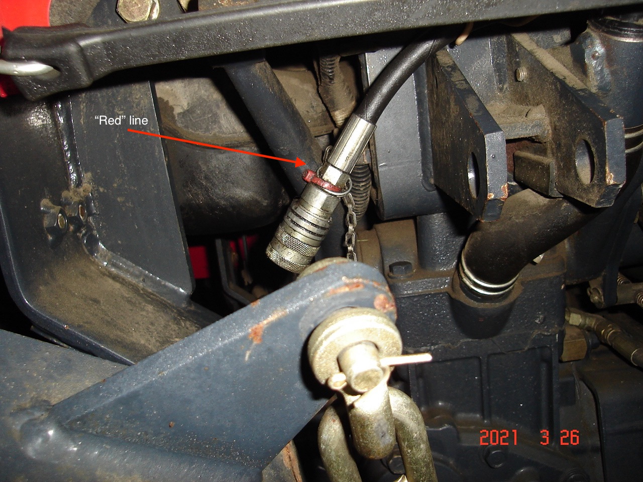

There has been some discussion on this forum about how, on some GC2300s, the color indicators were either left off, incorrect, or just different. On mine, I have red, blue, and white on my BH lines, with BOTH a blue and a white on one of them.
When the BH's off, the red one (female connector) is tucked up and out of the way so it won't get caught by the 3PH arms as they move up & down (with MMM or 3PH raising & lowering). The blue/white line connects to the white one that goes back into the tractor frame; that's called a "return line" and it's necessary to have those two connected to be able to use the MMM or the 3PH.
Here are some pics of mine:
