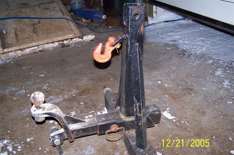

I cleared a building lot last year and hauled logs / downed trees with a pair of logging tongs. (Northern Tool has them) and chain. Also had about 500# counterweight in the bucket. Used the attached homemade 3 pt hitch to hook the chain to. Was much easier for me to cut them up with them all in one place. You can drag them by wrapping chain around them also. Others have used a skid plate or metal sled to set one end of the tree on then chain the tree to the sled and chain the sled to the tractor and pull away.
George
