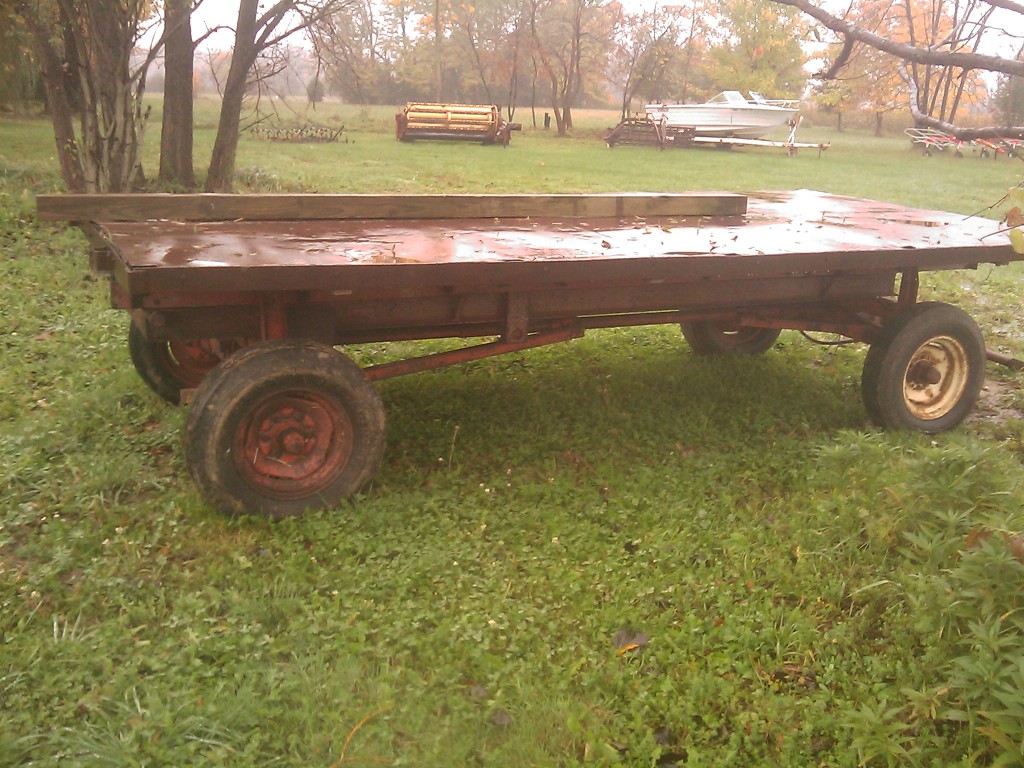

Some pictures of it:

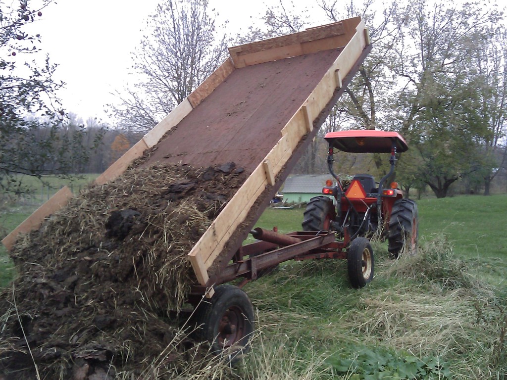

Dumping some wonderful manure (the reason I want to still use it as a dumpwagon):

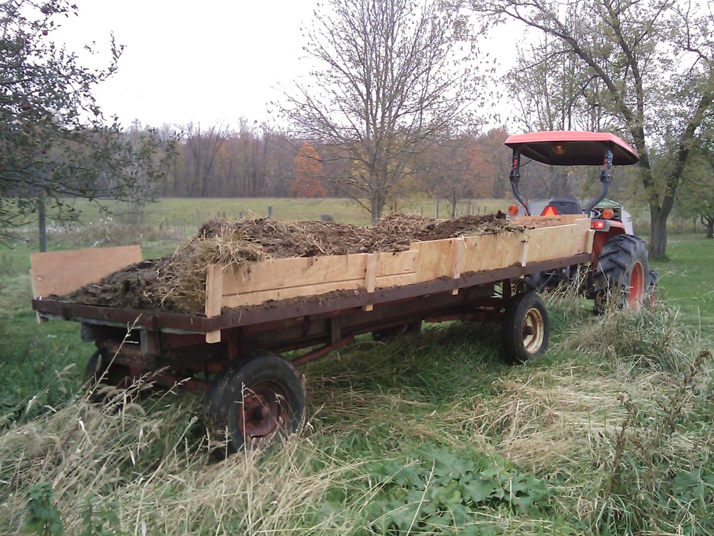

Some short sides I made for it:

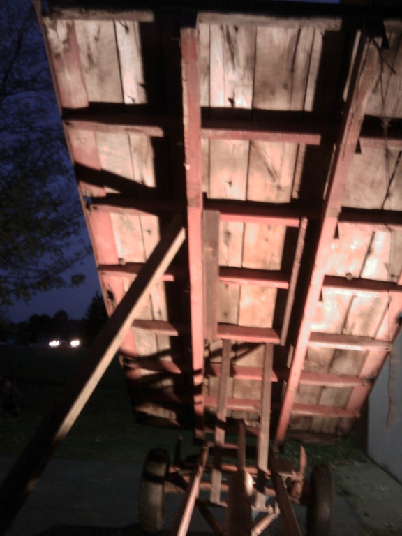

The underside (before I made stops to keep from dumping too far)

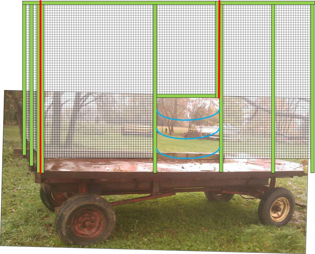

Drew up a rough design for one side and the back:
Green boxes are 2x4s
Red is where the sections join
Blue is the chains for the side openings
Debating if a board across the bottom of the mesh will be needed. Will probably build without and go from there. Easy to add a 1x6 after if needed.
