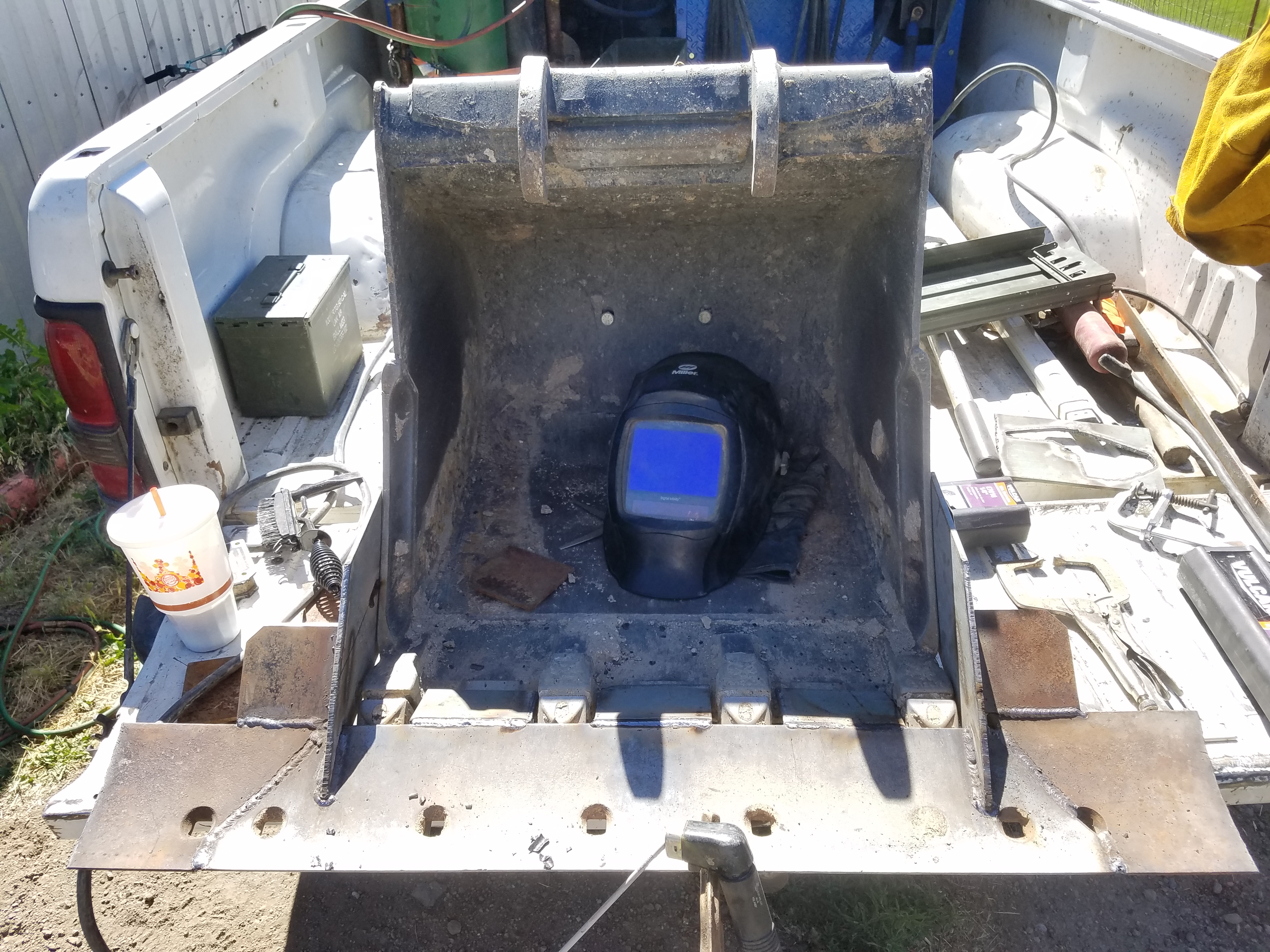

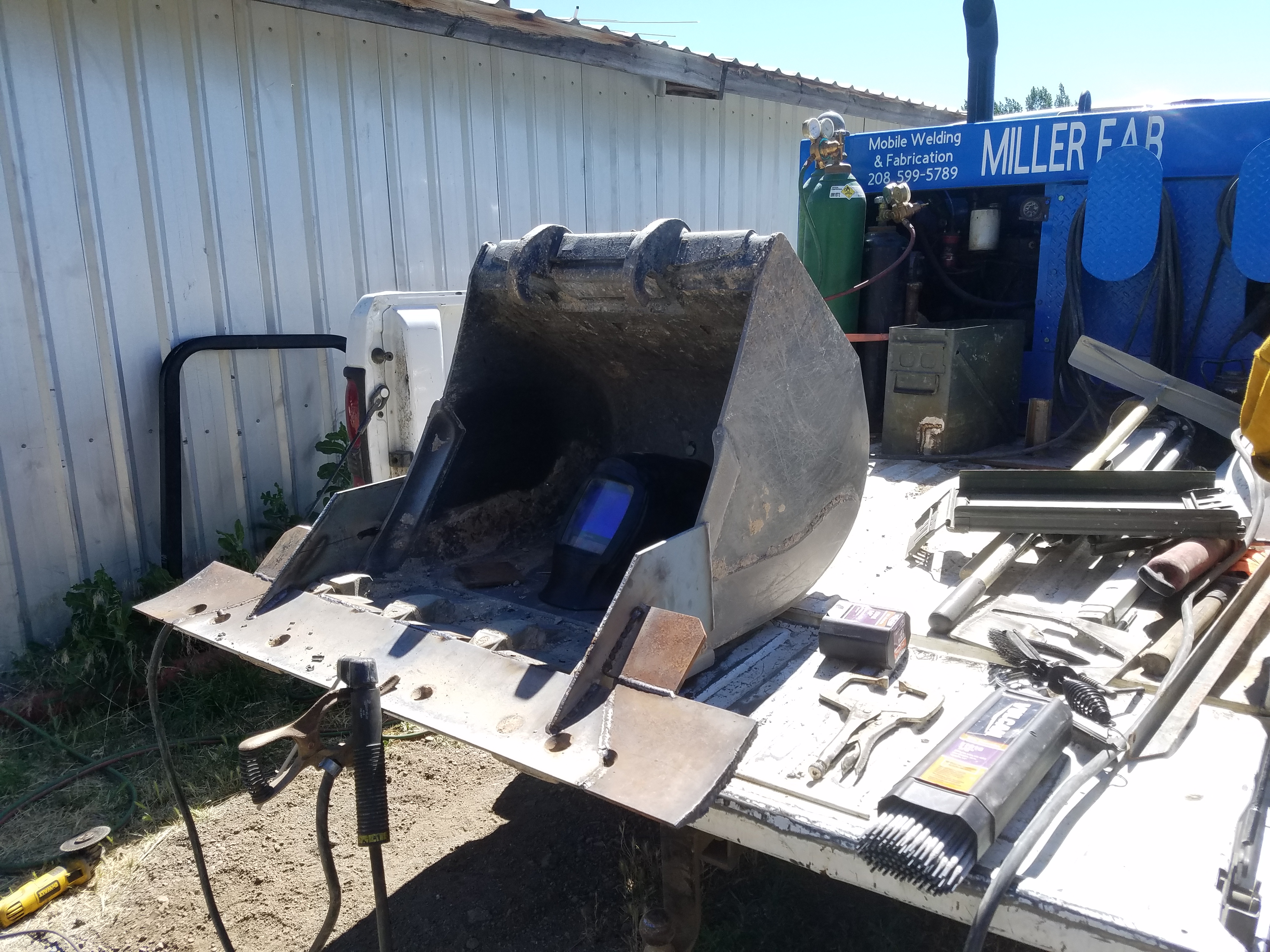

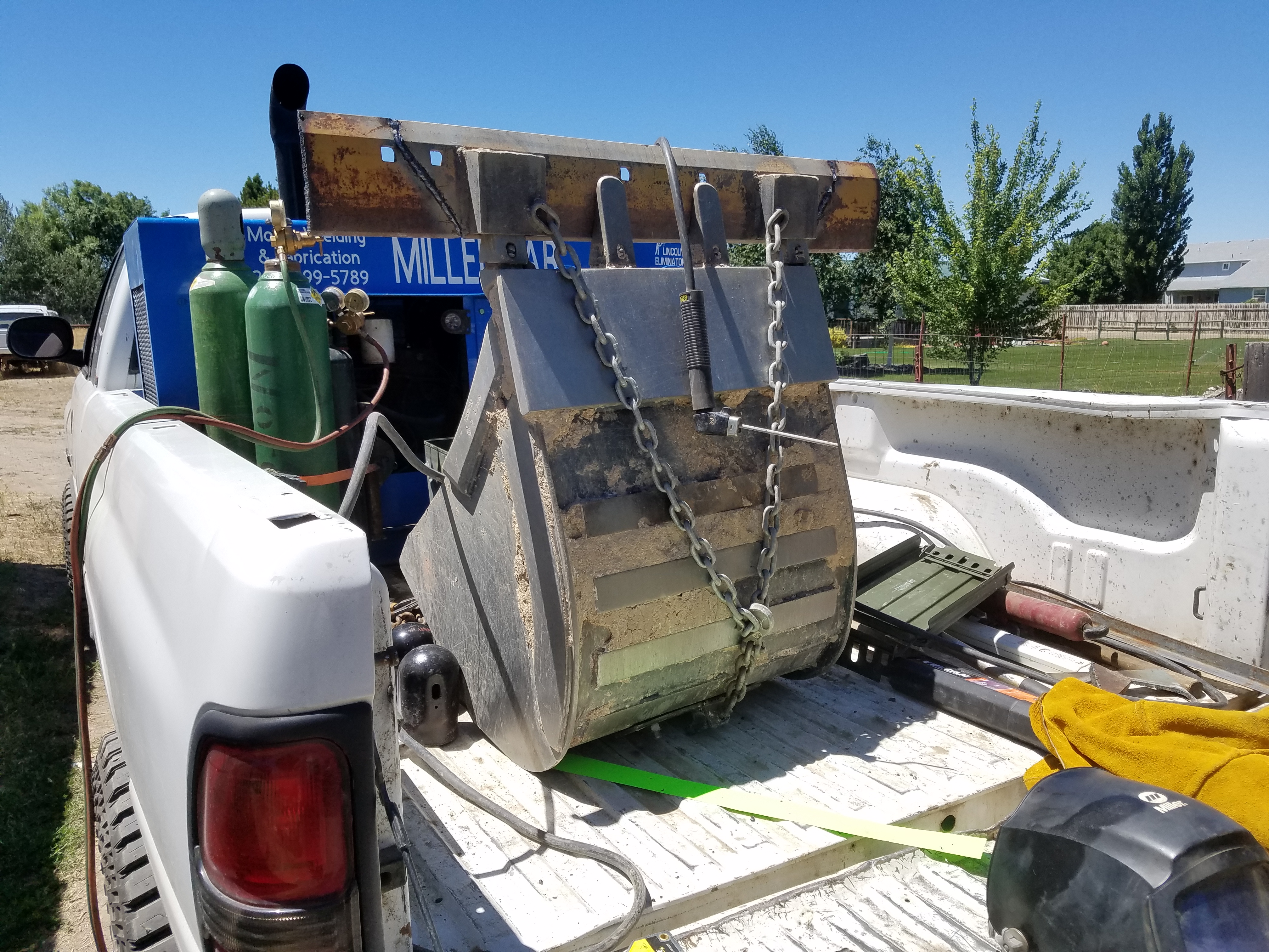

I did just blade taperd ends at 32" it worked so well but i found ot could use some improvements. I couldnt see the taperd ends grading around pipes, lots of material coming through teeth. Also noticed it packed alot of material on the blade.
So i scabbed a bunch of misc stuff i have around together. Exstended it to 42 plated between teeth and added small wings
Miller big40 did the rod burning and man it runs amazing.
Ive spent the last month doing dirt work for plumbers on a huge retirement home commercial building. The main tool is a bobcat excavator due to skidsteer not fitting between pipes.
This blade save so much time now i hope its even better
