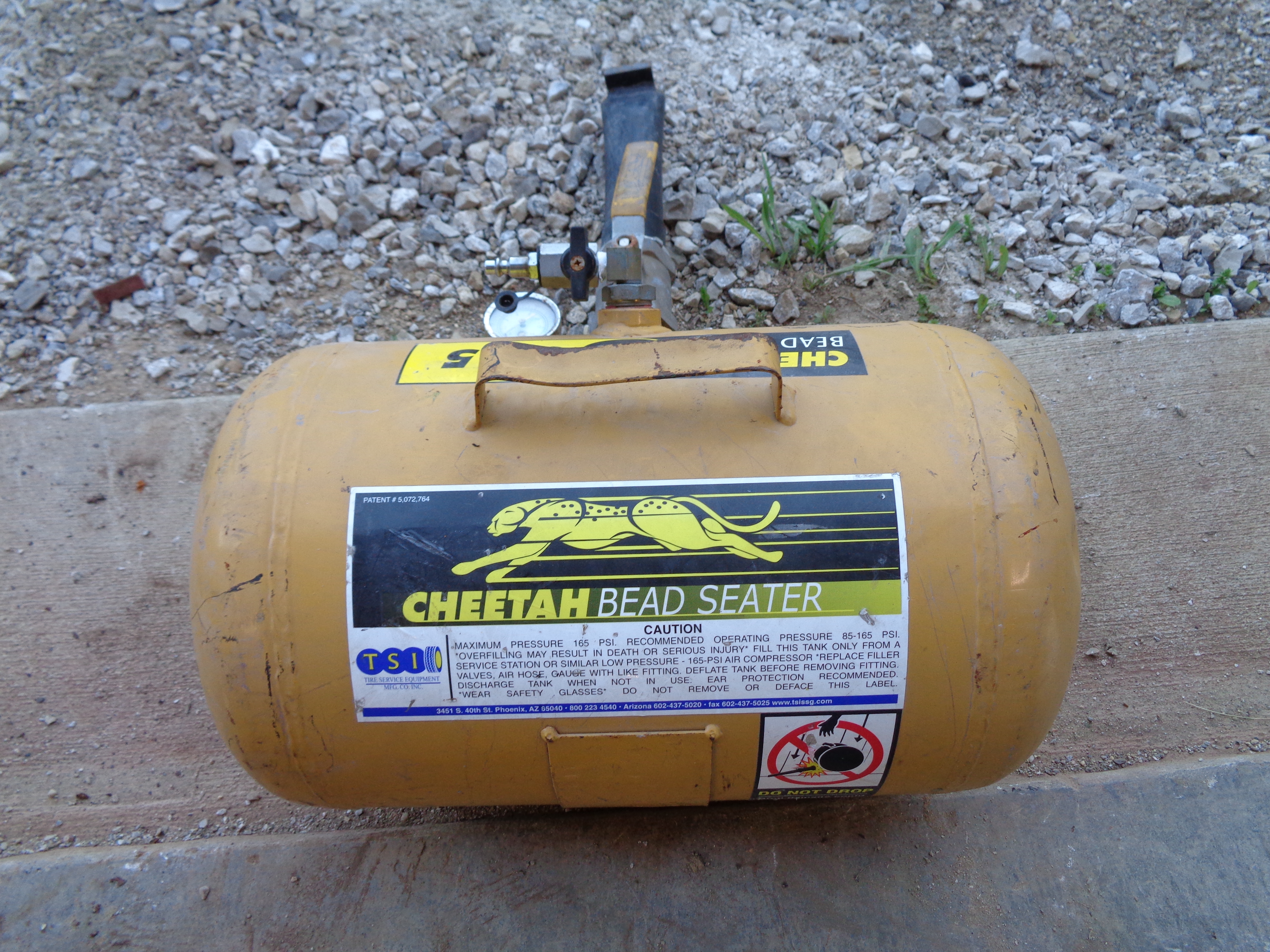

Baby bites when using tire tools is your best bet. I have 4-5 tire tools, some split rim tools that work great, it doesn't take a big tool to mount even large tractor tires, although I do have some for the really big one's. Splurged a while back and got a set of motorcycle tire tool to do GT tires, haven't used them yet but will soon.
Front garden tractor tires seem to be a bigger PIA to work on than anything. Getting them on & off not so much but getting them to seat. Broke down 5-6 years ago and bought a used bead seater tank. Got frustrated one hot summer day and came in for a drink. Was looking through FaceBook Marketplace for bead seater tanks and a guy had just listed one a few minutes before I started looking for $40. Messaged him and he was just 12 miles away told him I would take it and was on my way.
Came home and aired it up and popped the tire out on the rim in a few minutes, whereas before I spent an hour trying to get it to seat. Well worth the money..!! I've done more than a few for myself, and some for neighbors & friends.

Yep, did that, didn't help the tires were pretty squished and nearly touching in the center. Bounced them a bit to widen them out, then hit it with the bead seater tank, popped it out in an instant. Saves a lot of time and aggravation..!!
