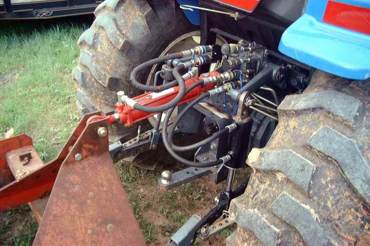

Laminarman, Yes you should spring, it is everything you are imagining. here is a photo of the hydraulic cylinders (T&T)operating a box blade and connected to two remotes (not in photo). Not only can you do the side to side ("tilt") and forward and back ("top", kind of like nodding your head), but the arrangement also makes it very easy to connect you implements.

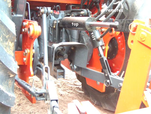

The total cost for your tractor (remotes and TnT) should be about $950 to $1000. It's not cheap, but it's worth every penny. /forums/images/graemlins/grin.gif
See the attachment for my installation on my TC45D.

Jim...... looks like that one hose over the red cylinder is getting ready to go to the big hose heaven. When they start to crack like that, it is time to have the replacement ready to be put on. If you get the replacement hose and have it ready, then the old one will last forever. If you don't have a spare, it will blow on a Saturday afternoon after the parts store closes and Monday is a holiday. You have a lot of projects to do and a broken down tractor..... Experience speaking... /forums/images/graemlins/grin.gif /forums/images/graemlins/grin.gif /forums/images/graemlins/grin.gif /forums/images/graemlins/grin.gif

Jim, replace that hose before it blows. We see serious injuries from hydraulic oil being injected right through the skin into the muscle or onto the eye. One advantage of socks over hoses in addition to ultraviolet protection is mitigating that high pressure spurt. Besides, you can pump a lot of oil out of a transmission/oil pump pretty fast, especially if it's not squirting on you ! Also it can be <font color="red">HOT </font> /forums/images/graemlins/frown.gif
Infection inevitably follows and I've seen some disfiguering/disableling consequences. It would seem to me a longer hose so the bend is not so acute and/or some angled fittings would help.
