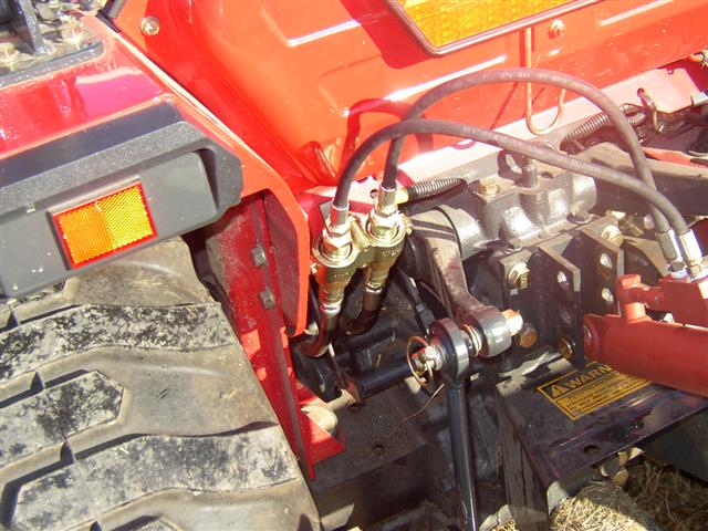

I added a remote to my 3015 to operate a hyd toplink. I mounted the valve so the handle would be in the factory position. It was challenging to figure out where to mount the quick connects... didn't want to mount them on the fender.

pic of the quick connects

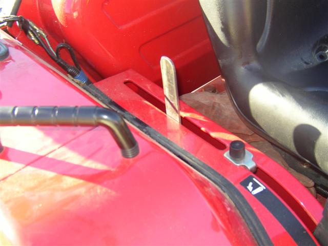

Lots of nice pictures to. I have the 2615. hst What i would realy like to see is how you mounted that valve. Also were did you get your quick hitch from ?

I posted some pics of the valve location. I just wanted the handle in the factory position so I worked from that angle

Is that an OEM remote or did you make it up yourself? I have the Cub version of your series and when I priced the remote kit from Cub it was somewhere in the $500 range, (valves, hoses, etc.) You did a nice job. If I remember the Cub remote mounted just above where you have it, in a vertical position. Are two disconnects all that is required for rear attachments or is that all you needed for your top link? Thanks for the info.
   / Remote valve on my 3015
It's a homeade setup. Materials ran me about $250. My main goal was to have the handle in the factory location and I worked backwards from there to locate the valve. 2 disconnects are for double acting cylinders.
