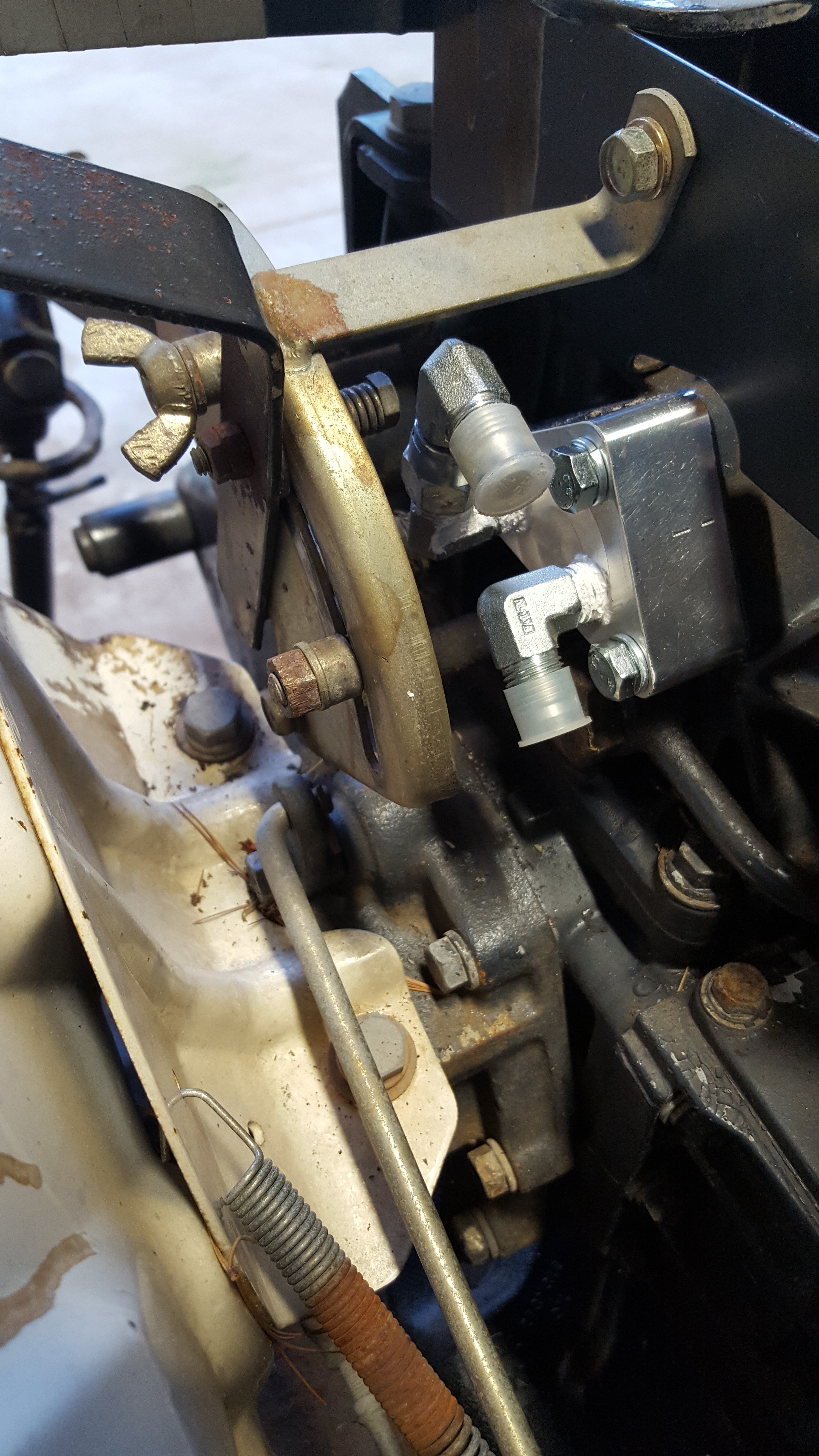

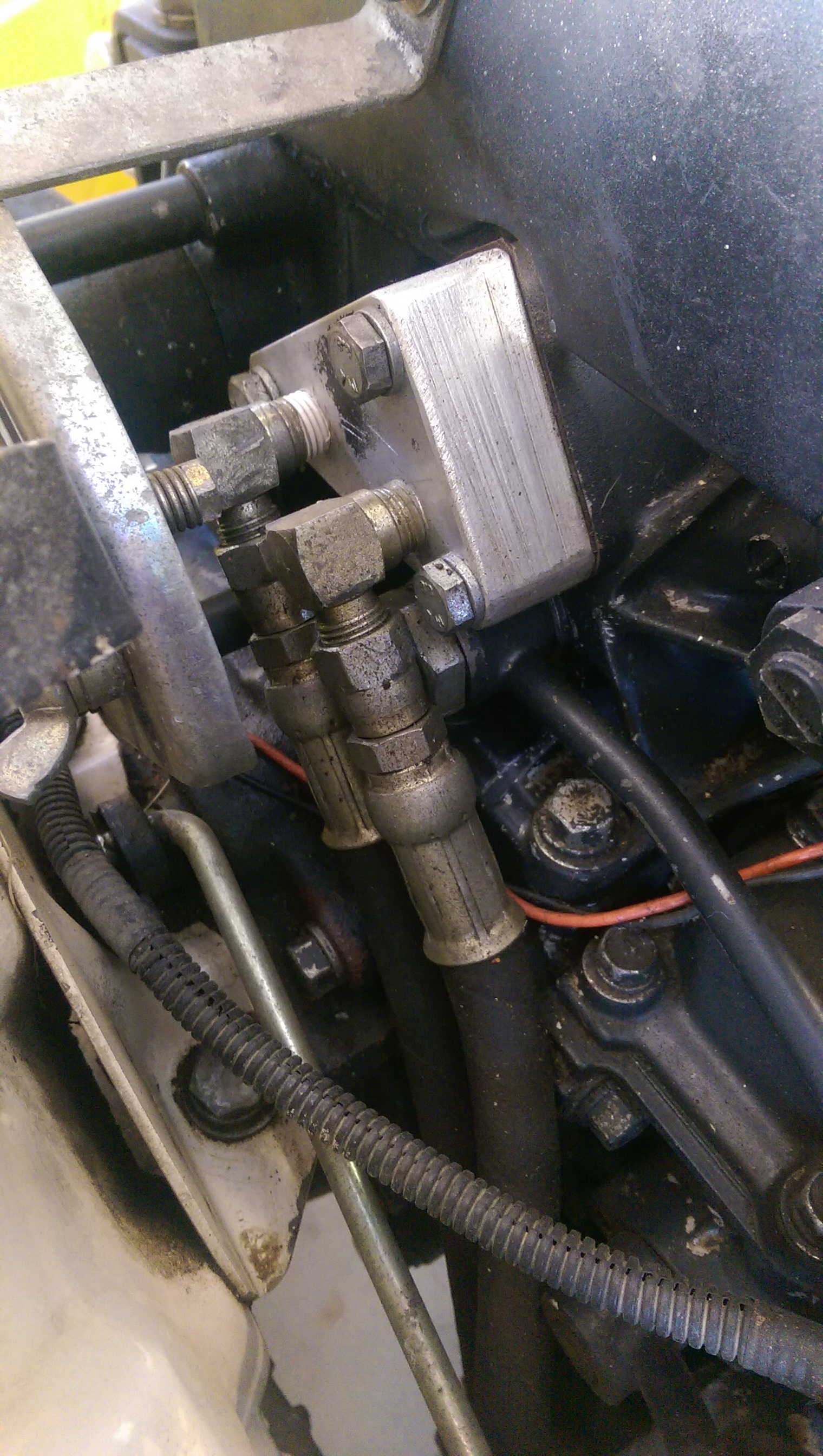

Duh!, I can't believe I missed the most important detail. It is a H1502. I am having the manifold made locally and I will have it next week.
Thanks
James
   / Remote manifold block?

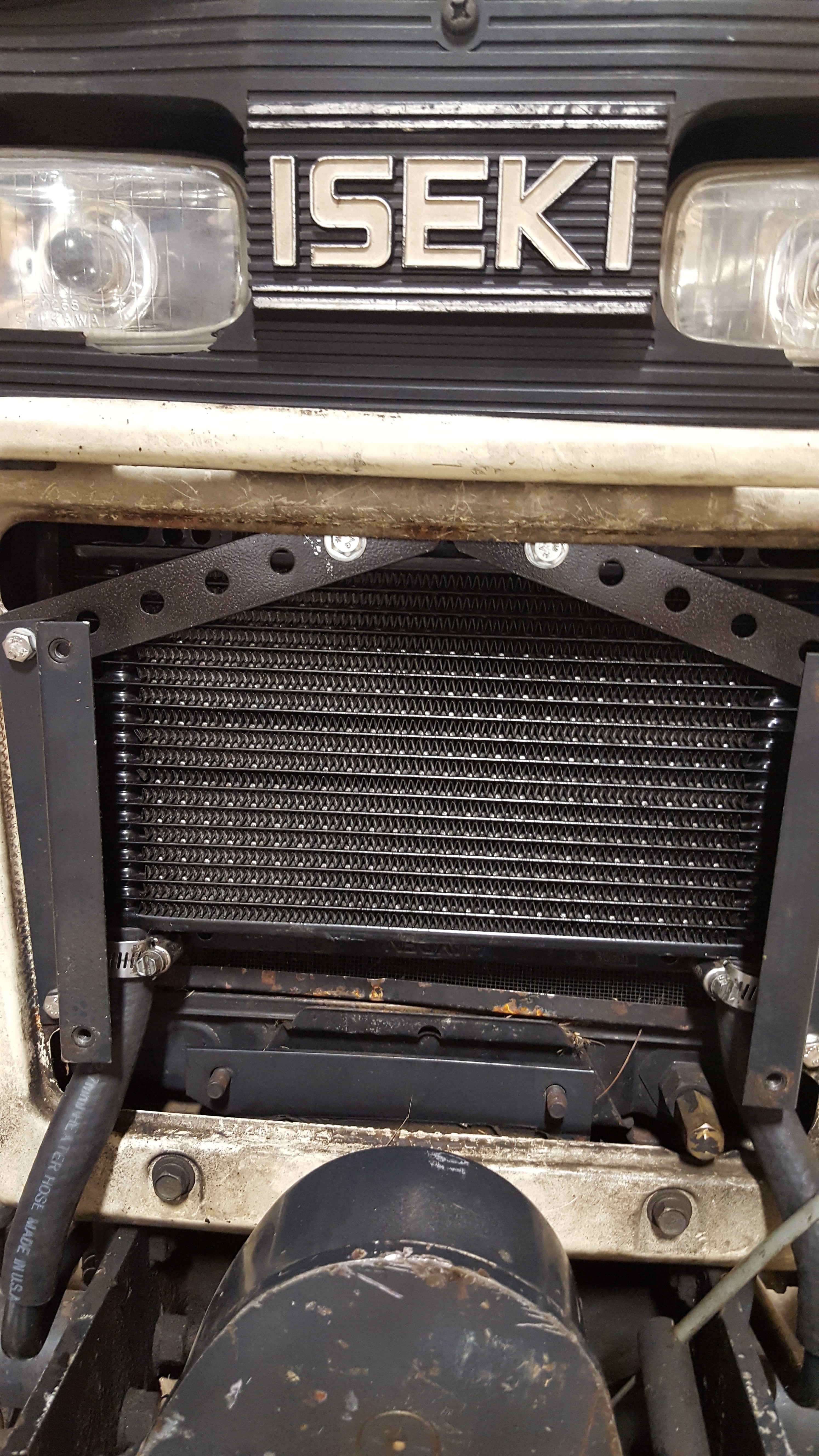

I had a manifold fabricated and it is ready to go. I also installed a transmission oil cooler since it was missing when I got the H1502.
