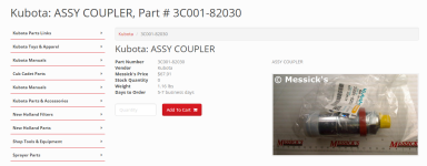

Are you needing male or female part of connector? Messicks lists female part for under $70
The way min is set up, I have female threads on the remote hydraulics. It had a fitting which I thought was 3/8" oring boss X 1/2" oring boss; then it had a female thread quick connector X 1/2" quick connect with the internal collar.
Tx Jim, I couldn't see the attachment when I originally replied. I really can't tell from the picture, but it does look like the correct fitting. I'm a little concerned buying it though, since it doesn't have any specs.
When I called the Kubota dealer, they said there were 2 types depending on my serial number. I was out of town at the time, so I tried giving them the Parker part number. I gave up on them once they told me they only use Kubota quick connectors.

#9
Decided to go to dealer and as if by magic they found one on the shelf not tagged for $87. They thought the threads were either 14mm or 22 mm. If metric, they are some where between 9.5mm and 12.7mm though. Anyways, thanks for all the advice guys.
