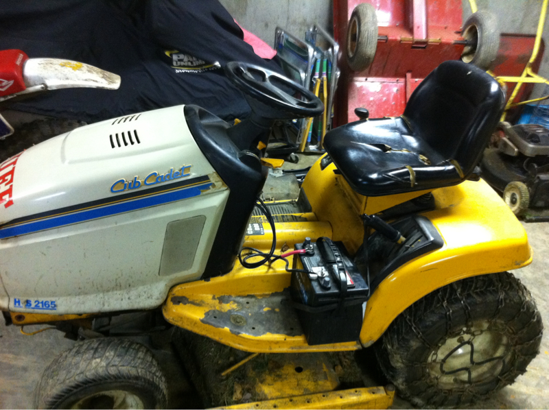

I have since bolted it down to prevent movement. But this seems to work well

then where do you put the spare 1g gas tank you carry? :)
that's where I put mine to prevent long walks.. as mine always runs dry at the end of a long row out mowing the roght of way.. :)
