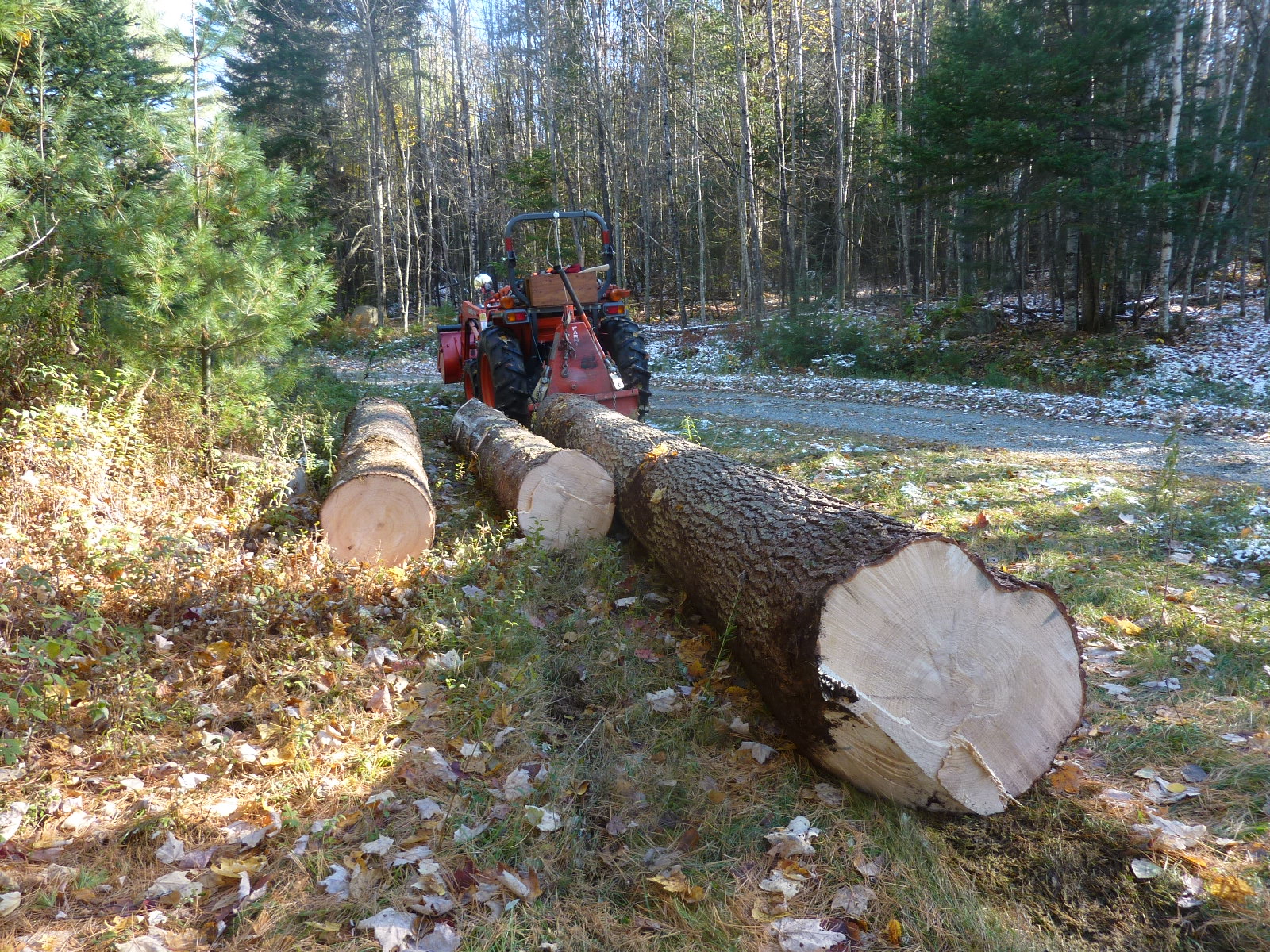

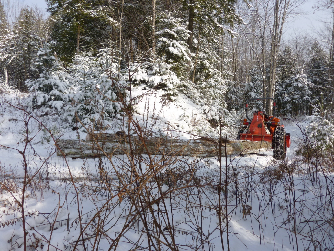

What you say is probably true in general. I can tell you are way more knowledgeable than me but having said that I will risk giving my opinion. You make it sound to black and white. It sounds like you are saying the steering brakes are useless on a modern tractor and that if you dare use them you will cause damage.
I strongly disagree. I agree with SDT and Fallon. To me the steering brakes are there to use and I use them - alot. I work in the woods, summer and winter. My dealer advised me against chaining up the front while working in the woods with the rears chained. He said the fronts need to slip some compared to the back. There are a few things that make it hard or impossible to turn w/o the steering brakes. A heavy hitch on the rear lightens the front end. A long hitch of logs on the back act as a rudder that trys to keep you going straight. Packed snow or ice or mud gives the front tread nothing to grab so the fronts can't pull into the turn. Try turning up hill with any of these conditions - a no can do w/o using the steering brakes sometimes - at least on my little L3010. Almost 2000 hrs, most in the woods, with constant use of the diff lock and the steering brakes. No problems - knock on wood.
I would not own a tractor that did not have convenient to use steering brakes.
