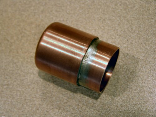

Rick the first time I sprayed myself with hydraulic oil was the last. /forums/images/graemlins/mad.gif I went into my copper house plumbing odds and ends and made this simple gadget from a copper cap and a short piece of copper tube. I place it over the end of the quick connect, point the open end away from me, and use hand pressure against the copper cap to release the hydraulic oil pressure. Simple and clean, works every time. I toss the gadget back into my tractor tool box to keep it handy for the next go around....

That's an excellent fix. I'll make one up this weekend. /forums/images/graemlins/cool.gif
