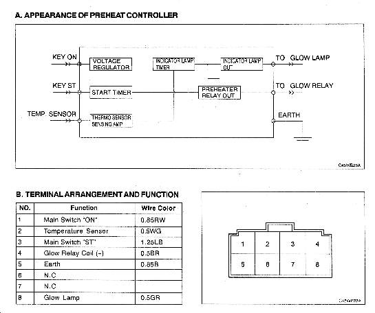

So the middle is the fuel shutoff solenoid?or the right one. When I unplug the right one my glow plug light on the dash will not come on. So I assumed the right one was glow plugs. Problem has been it’s in the 40s here and if I put glow plugs on timer with waiting till light goes off exhaust will smoke while cranking but won’t start, if I turn key past timer to manual glow plugs it starts right up. Could be the larger black box which is the glow plug timer box which is probably expensive to try first so I thought start with cheap relays

It is starting to sound like our tractors are not as similar as I thought. Mine is a 2008(serial # GC4900201) DK45sc, but I do not have a manual position for the glow plugs. Also, with either (or both) of the relays unplugged, when I turn the Ign switch on, the glow plug light still comes on normally, which makes sense to me because the glow plug timer box is what turns both the relay and the light on. I would check the fuse for the timer box; if it is good, it would seem to me the timer box is the most likely culprit since the "manual" glow plug position works. I'm sure that position feeds the relay, so the relay must be good.
Look at the front wire at each of the relays, if one of them is Black and Yellow - that is the glow plug relay, if one of them is White, that is the stop solenoid relay, the start relay should have a Red wire in front. If these wire colors are not the same on your relays, I guess we have very different wiring.

I do have the manual heat position on my switch, I've owned the tractor since new & never knew it existed. My switch placard does have a "Heat" position, but there is no detent, and the light does not come on. The only way I can tell it is working is that if you listen closely, you can hear the relay 'click', and you can see the voltmeter 'dip'. Can't find any mention of it in the owner's manual. The service manual does show this position, and gives a pretty good description of the "Glow Plug System". Good to know!
There are 6 wires going to the "PreHeat Controller", and they should be quite easy for you to check using a voltmeter, or a test light. First, unplug the controller, and unplug the starter relay, then check that the wires are connected as follows:
If I can figure out how to do it, I will attach a file showing the plug diagram and wire labels from my manual.
#1 wire Red/White should have battery voltage with ign switch on
#2 wire White/Green goes to the water temperature switch; should be grounded. (open when water temp is above 60C) * check this one closely; if your problem is a bad temp sensor, should be a cheap fix.
#3 wire Blue/Black should have battery voltage with ign switch to the start position (reason for unplugging start relay)
#4 wire Black/Red goes to Glow Plug Relay coil. Using same procedures as for #8 wire, you should hear the Glow Plug Relay 'click'.
#5 wire Black goes to ground
#6 wire - not used
#7 wire - not used
#8 wire Green/Red goes to dash light (I believe you've already proven this one is correct) To check, 1st use an ohm meter, and test for
around 100 ohms to ground, if at least 50 ohms, then using a small, thin wire as a jumper, touch this wire to the
Red/White wire gingerly (ign switch ON), watching for any sparks!! If no sparks, then see if the dash light is on.
I do agree with you on keeping the tractor with all functions working!
