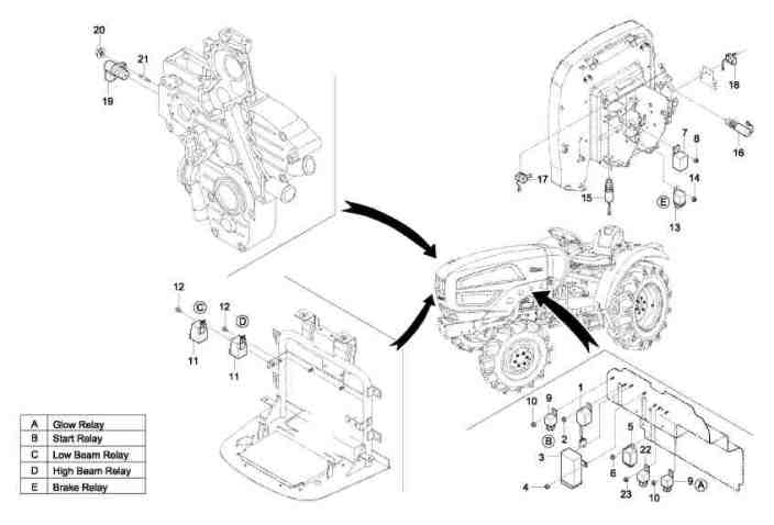

Does anyone no what the relay under the hood in the center of the firewall on the CK25 gear is for. Mine got stuck in the closed postion the other day and drained the battery.
Thanks,:rolleyes:
   / Relay #2
Pick out which one and if there is a letter buy it than look to the left and it will tell you.
If it's just the number let me know and I will tell you what it is for.
   / Relay
It is the first relay to the right of the large square box #4 so it must be #5 ?
Thanks,
   / Relay #4
#5 is a box not a relay and that controls your tach
right next to that is a glow relay.
   / Relay
Thank you, I figured it was a relay because I tapped on it with a screw driver and it stopped passing current through it.
   / Relay #6
CK30 hst I had the same problem, did the tapping thing. Better off replacing.
