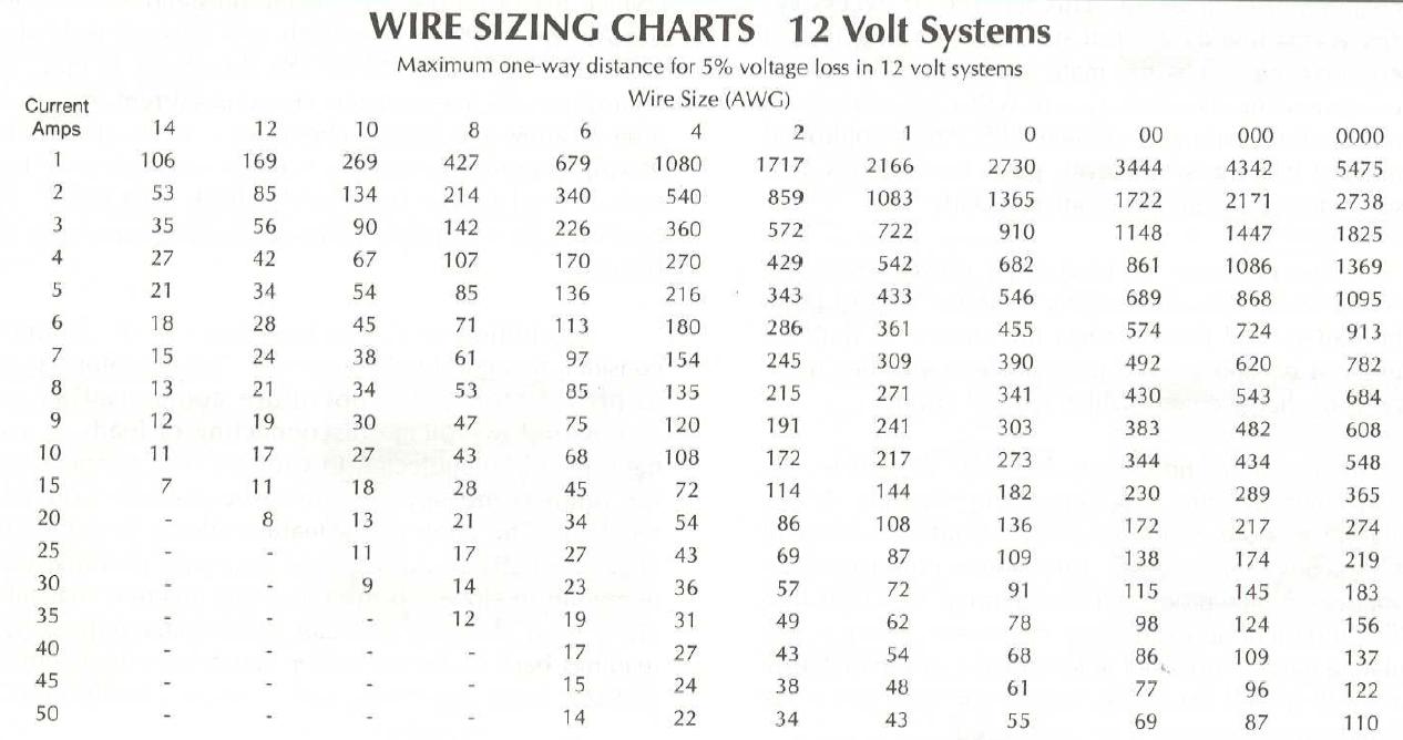

Where is the DC outlet located? Is it behind the seat? What are you using the outlet for? Out of curiousity, if it's already controlled by the light switch, why did you want another switch?
Wire gauge is critical in low voltage systems. See the attached wire sizing chart, which is based on a 5% voltage drop. 10 AWG wire will get you 9 feet @ 30 Amps. 12 AWG wire will get you 8 feet @ 20 Amps. Exceed these distances and your voltage drop will be greater than 5%. It's a conservative chart but it's a good rule of thumb.

Don't worry... For starters, I read your post backwards on my first reading. I thought you said: match the wire size to the wire on the fuseholder - not the other way around.
But as the last post said, wire size is a big deal on low voltage. For most folks, the lower the voltage, the smaller the wire, and vice versa. But, in reality, it isn't just the opposite, it is times four! For every time you cut the voltage in half you need four times the wire size, so in the 13.8 volt range, you need much larger wire than in the 120 volt.
The DC outlet is located eactly behind the seat, middle of the ROPS, just to the left of the rear hydraulic outlets on the 3320.
I am using 8ga wire from the battery to the relay at the back of the tractor and I will only minimal voltage loss @30 amps as total distance is about 10'.
