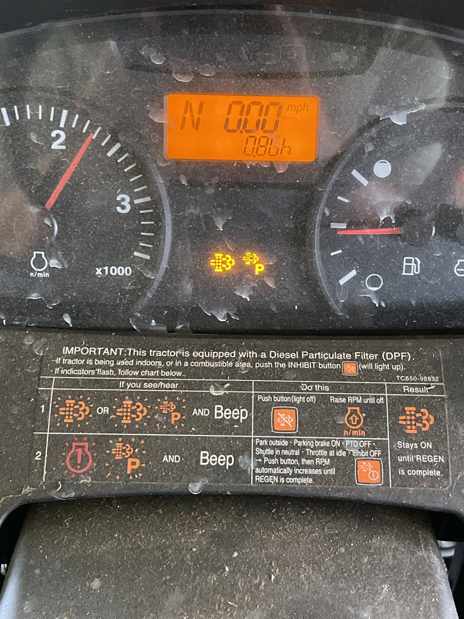

Kubota M7060
Hello I have a kubota M7060 and I use it for cows mainly bushoging and loader work and I’ve been waiting about 30 minutes parked and the regin is still not done any ideas
   / Regin time #2
Should finish in another 10 minutes or so. Do it when the light first comes on and increase to full rpms - then continue work. you only have to wait if the auto regen is declined. When the filter accomulates enough, it will require parked regen. Anyway, that is the case with my Kubota. Check your manual.
   / Regin time #3
Is there a reason you are doing a "Parked" regeneration? With my M7060 I have never done a "Parked" regeneration and I have nearly 600 hours on it now. While working the tractor I'll see the regen light has come on in the dash; I just continue what I am doing and in 10-15 minutes the light goes back off. No input needed from me. Actually, the only time I have had to react to the light is a couple times when the light came on and I had the tractor at idle rpms so I increased the rpms to 2000 till the regen cycle was done.
   / Regin time #4
I think 80% of the posted problems with regenerations is a lack of understanding the procedures by the operator.
A "parked regeneration" is only the plan "B" if plan "A" failed. Plan A is to do business as usual.
