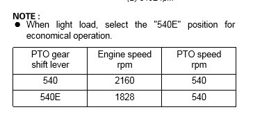

It is doing the regen cycle while you are brush hogging? Why r u running it at 2200 RPMs? Isn稚 PTO speed at like 2500-2600?
Here's a screen shot from the M7060 owner's manual as far as engine speed correlating to PTO speed:
So 2200 is about right if not using EPTO.
But I mowed 60 acres this summer already with my M7060, using EPTO the entire time, and only saw one regen cycle, very brief. So if the OP's M7060 is regenerating that often @ 2200 rpm, in the summer heat, then something is wacky. (My M7060 HDC12 is a 2016 model and has, if I remember correctly, about 250 hours on it.)
