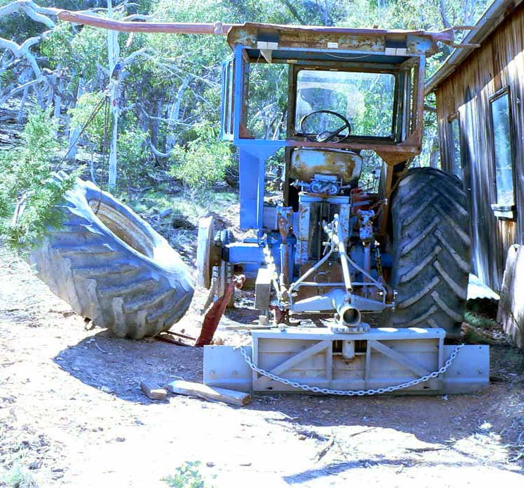

I can't be the only one with this problem so if anyone has worked out a system for replacing an enormous wheel on his own, please let me have your thoughts:
The monster is a 24.1.26 tyre on a 20" rim and I reckon it weighs around 120 Kg. It had a new tube fitted and I managed to lever it off the trailer so it is lying flat next to the jacked up tractor but the ground is not level. That was the good news. I'm on a remote property where is is difficult to get any help. Guys promise to come, then find any excuse not to do so, even when offered payment. I dug out under where the wheel must go and built a trolley jack on a rolling frame so if I can get the wheel upright onto the jack, lifting it into position should be reasonably simple. Three lashed posts and a chain block might work, so might another trolley jack and props to lift the wheel in stages but I'm concerned that if the bast%#d gets away from me and falls against the tractor, the weight could dislodge the jacks under the tractor itself - that might spoil the day.
Any ideas?
Cheers, Alan

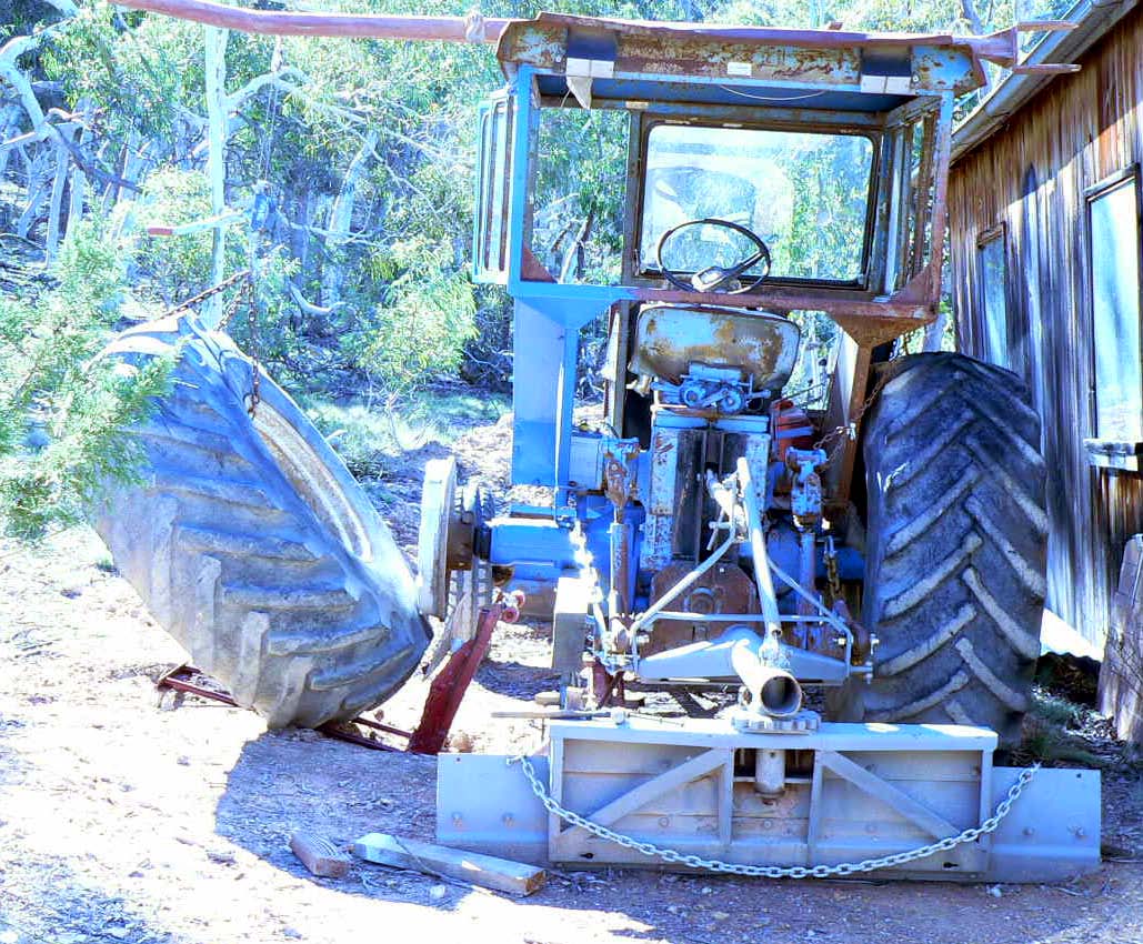

I should have put in a picture in the first place - now attached. You can see the problem is the location near the shed, so there is no room to get anything on the other side of the machine. The ground is also uneven and the downhill slope means that levering the tyre with a crowbar into a vertical position causes it to slide towards the rim where it jams. I tried chocking it but that did not work. Also tried the sheerleg idea but it is hard to get enough height to operate a tackle. The downhill slide also works against it.
A conventional forklift would never make it onto the site due to the steep and rough track (one of the reasons I need to get the tractor going again is to grade the road). However, I thinks another tractor would be the answer using the 3-pt linkage and my boom (not shown in the picture) Of course, that also would solve the problem if the driver came with the tractor and that is the difficulty as first explained - guess I'll persist in trying to find a cooperative neighbour, if such a thing exists! You would think my German Shepherd would help, but all he does is eat and s&^t.

Is that tire loaded with fluid ballast? Either with or without, I am sure it's quite heavy. I can't offer any suggestions other than to try inviting some friends again and this time include free beverages (beer) and food (grilled steaks)! If that offer works, make sure you get the tire on first BEFORE you give out the beer!
If that doesn't get anyone to help you out, then you might need to look at renting or building a portable tripod or A-frame with a winch on it, or maybe an engine hoist that could be used to suspend the tire up off the ground so you could manuever it easily. Just a thought to consider if all else fails.

Is the cab sound enough to pass a cable through? Maybe you could jack the side of the tire up using blocks or timbers to say a 45 degree angle. Then use a comealong attached to the tire and passed through the cab and anchored to the other side. The red jack close to the hub is going to be in the way. Good luck be careful.
/ Refitting huge rear wheel #8
If you can (or are willing to) spend more money, hiring an old fashioned tow truck with a boom can lift the relatively light tire into position. You'd need to set up the lashings first depending on the lift height to the hook of the truck, many are fairly low. But it drives up, has safety coverage, and if you set up ahead of time it shouldn't take too long or cost too much since pretty much everywhere has something to tow cars around.
If cost is a serious object and you want to do it yourself, the first thing I'd do is solidly block the tractor -- as you mention, if the tire gets away the tractor held up with spindly bottle jacks isn't too stable. Then getting the tire upright isn't as much of a risk (you sure the tire only weighs 120Kg? Seems light even only full of air). Getting upright shouldn't be too hard, couple of poles and a sort of jib boom (to hold the tire in position with each lift) using only muscle power should do it. But it will probably flop over to the tractor even with a limit rope to a tree or some other solid object, and that is the identified risk with the jacks holding up the tractor...

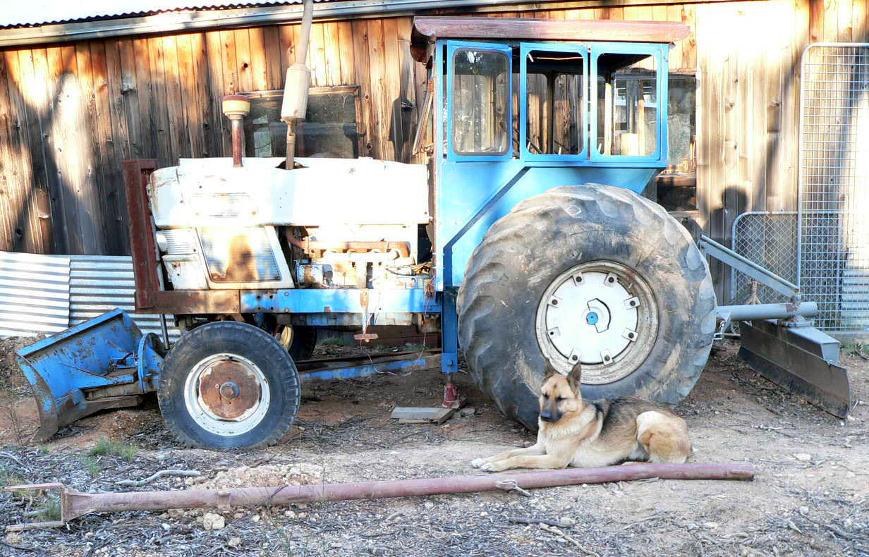

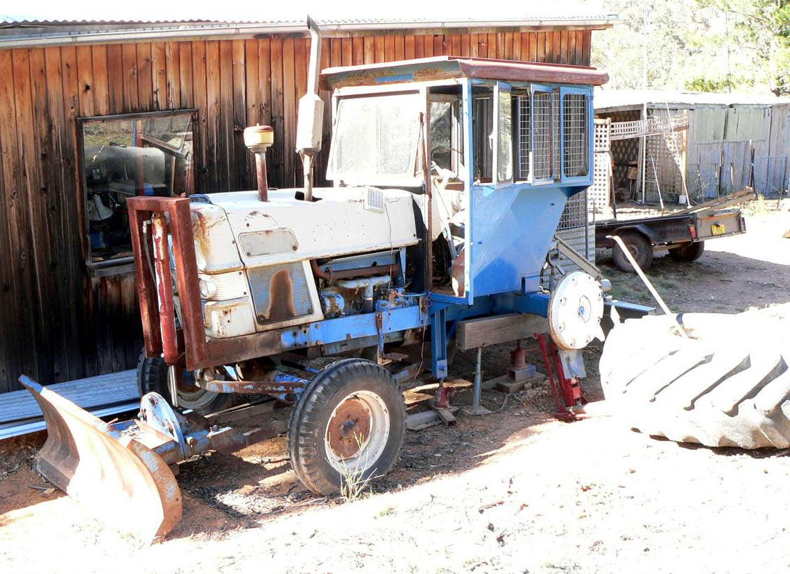

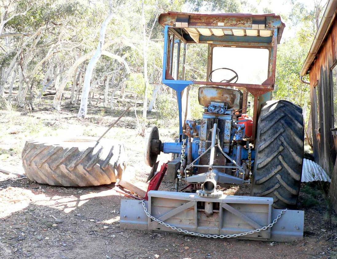

Right Ho Guys - all done!
The dog was lying close by licking his nuts when I was writing previously and he must have heard me mention the 3 Pt linkage jib. Next thing I know he growls something that sounds like "&#^@" meaning just stop thinking and get on with it. He was right.
I dragged the jib out, unbolted the swinging frame and hoisted it onto the cab roof, then chained it down to the chassis on the "good tyre" side. Passing a sling through the wheel enabled it to be lifted to a 45 degree position. Then by chocking it I replaced the sling with a chain so adjustment made it possible to raise it some more. The tricky bit was supporting the wheel to allow the chain to be removed after it was roughly in position on the hub. That done, a couple of shoves with the crowbar engaged it enough to get one bolt in and the rest was easy.
For interest, I'm going to bolt a permanent steel beam with an internal slider and rings at each end laterally across the top of the cab, so a sling around the wheel (not through it) will make this job easy in future.
The pictures attached are not real good but will show how it was done. The final shot with the wheel back on includes the dog in "thinking" mode. The moral of the story is that there is always a doggone way to fix a problem. No animals or sub-humans were harmed during the fixing of this stuff-up!
