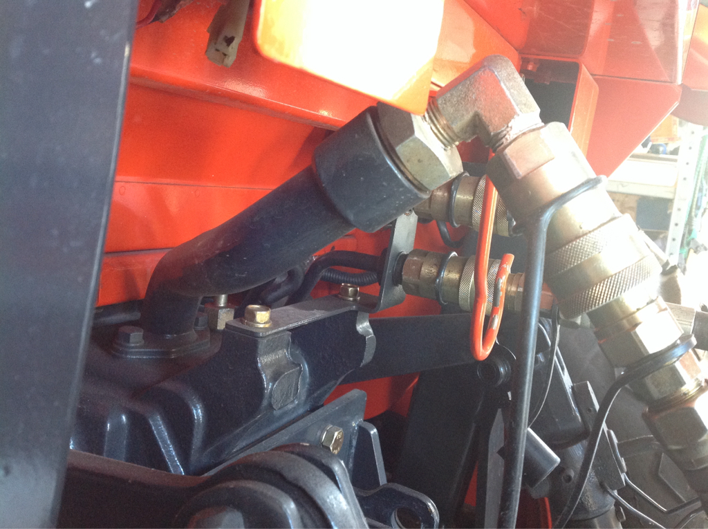

My CK30 hydrostatic is overdue for fluid and filters. Manual shows three drain plugs underneath, but for life of me I can't see where one would pour in nearly 8 gallons of fluid. Can someone point the fill hole out to me

On my CK35 I would remove the 90* fitting and fill through the grey tube. If you don't have a return kit like this I would guess you would fill where the 2 bolt flange of the grey tube is attached to the case.

Appreciate rapid reply....I went out to look at the CK30 to see if I had anything like your picture and low and behold, right in front of me on top rear is a tube coming out of the transmission case, with a screw on cap that says "OIL". Cap was once red but had turned gray and blended with gray paint on transmission so I completely overlooked it. Would have though the manual should have pictured this fill tube inasmuch as it showed the underneath three drain plugs. Will look for an inexpensive pump, or either I can put the fluid in smaller containers that I can more easily handle. Dealer wanted $350 for this which included pick up and delivery. I'll check out our source for filters also. Thanks again.
