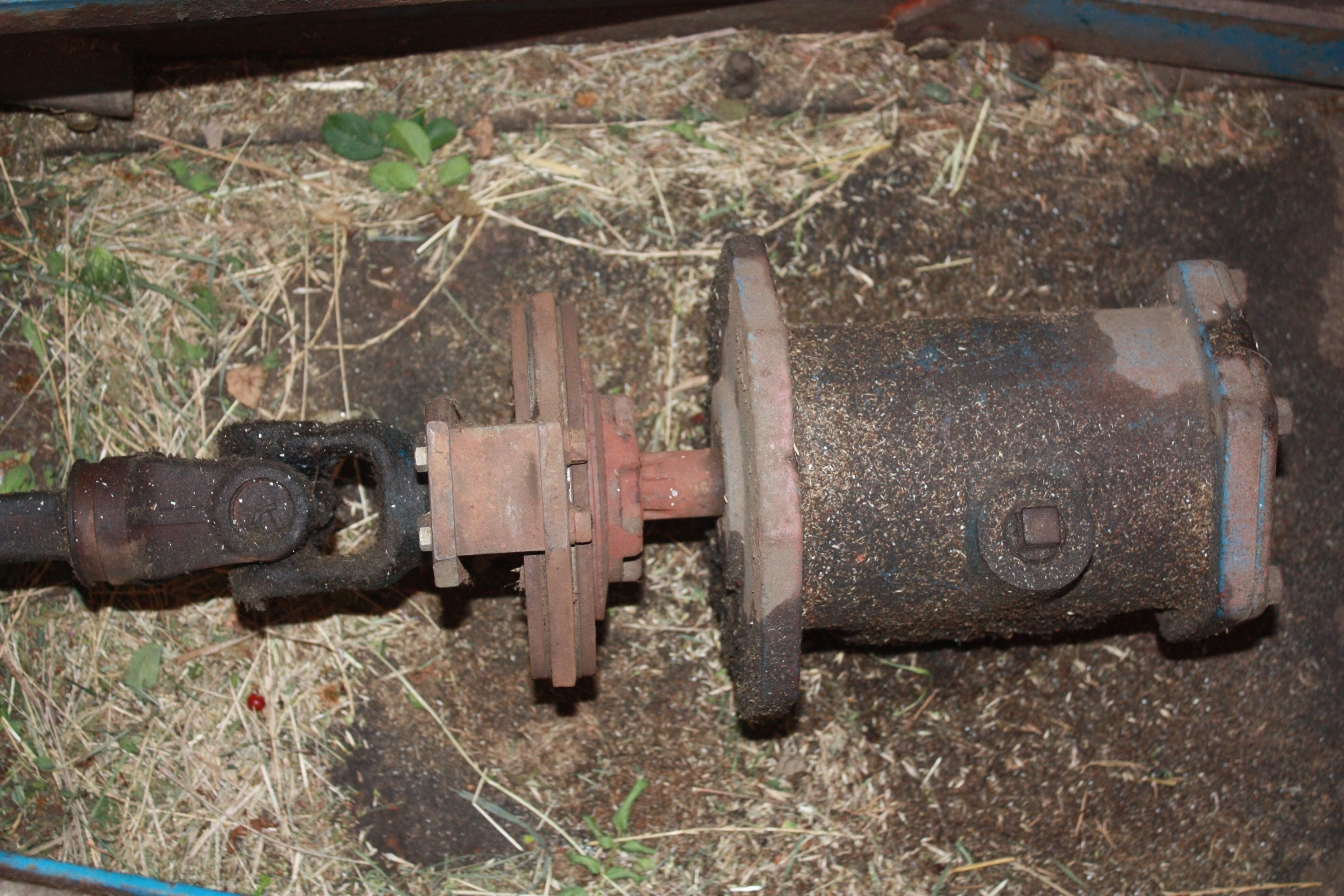

Burned up the disks in the slip clutch on my rotary mower. Before I put in the new ones, what's the best way to clean up the face of the clutch plates? It looks like the friction disk material melted itself to the face of the clutch, now it's covered with burned on, glazed asbestos covering a layer of rust.

Cleaned up the faces with a combination of straight edged razor and brake cleaner, then a belt sander. The surface is pretty badly pitted with rust, to the point that the belt sander leaves large splotches like a leopords spots where the rust has eaten away steel and left a slight depression. I guess it makes sense that moisture will get in there and eventually cause this rust. I'm wondering if I should coat it with something like XO rust to stop future rusting. The rust must reduce the effective surface area between the disk and the plate, causing it to slip more easily.

Have you considered just replacing it? Depending upon the horsepower rating, they start down around $85

When I acquired my used tiller the slip clutch was rusted to the point that it would not slip with bolts loosened. Once I chiseled it apart I simply put it back together with bolts loosened and ran it for a few seconds letting the clutch slip. Then tightened the bolts to spec. The slipping will remove surface rust. A few pits are not going to stop it from working. The important thing is that you check it from time to time to ensure it is working properly.
//greg//
Yes I did think of that, but check out how the slip clutch is made, see photo. Part of the yoke is manufactured as part of the slip clutch, so I'd also have to replace that half of the yoke. This thing's 50 years old, I wasn't sure I could find part of the yoke, so that would mean part or all of the PTO shaft. Anyway, for better or worse, this is where I landed.
