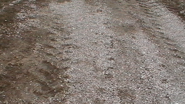

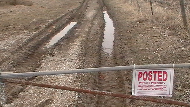

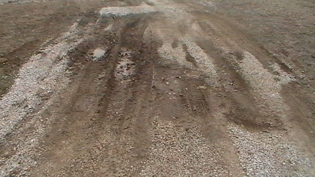

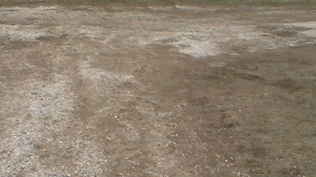

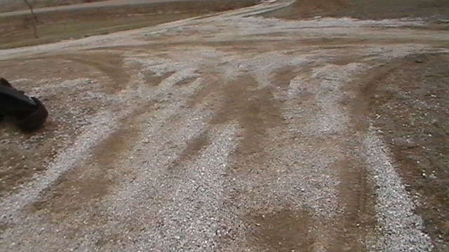

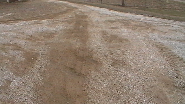

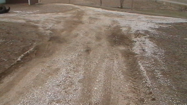

some photos of the driveway.
last year, i ran new eletrical, water, telephone, security, internet out to the shed. and in another direction ran a new gas line to the same shed.
November / December 2010 i got 3 loads of 16 tons 1/2 AC6 ((crusher rock)) to redo the drive and to go back over the trenches.
the last couple weeks have been the worse for me. all the snow melting and more so slowly allowed a lot of water to soak into the ground.
when i put the new rock on. i most likely at most put on 3 inches over the trench spots. and maybe 1/2" to 1" on other parts of the drive way.

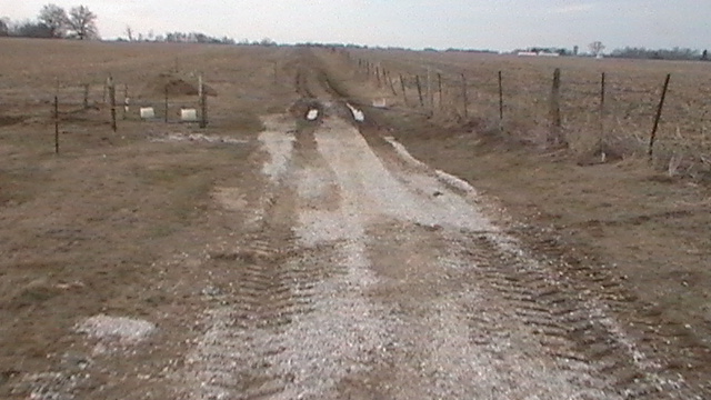

i also tossed some rock down the one lane. near the gate. i had to get into the back of the farm to check on things since it been a month. and ended up making some pretty big mess of things in the 555c loader/backhoe. as you can see in some of the pictures.
it doesn't matter how stable the base is around here at this time of year. ground is just to soaked with water. and best you can do is try to only use gravel driveway when things are starting to dry.
and then once dry, regrade things.
the trenches were ya see the ruts and were ya see mud on top of rock. will most likely need some additional rock say 1" to 2" thick. and i should be good to go for a few years. and then keeping a little more gravel in a pile some place to fill in a spot or 2 here and there. ((mainly the 2 drives that go down to road (u shape drive way), no ditches, and water runs straight down the drive way. washing a portion out in extremely heavy down pours.
besides were the trenches were. there is a good i would say 3" to 6" layer of rock below it. that has just accumulated and sunk in as more and more rock was put on.

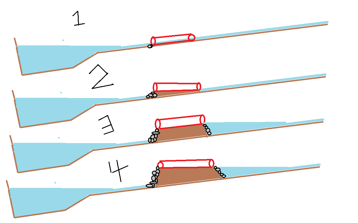

still have not decided how to place the 60 feet of 12" diameter culvert.
i like the easy idea of just tossing some rocks in current creek area. then placing culvert over. and just start bringing tons and tons of dirt to fill things up.
but, i also kinda like idea of building kinda of a make shift settling pond. so run off from the fields and field drainage tile that might have any silt or dirt or other in it. will settle on one side, before it goes through the culvert and into the lake. nearly everything is clay around here. if ya don't provide some sort of run off for water. it just sets and evaporates away.
my only worry. is if culvert plugs up. and flooding right over the road way. i suppose i could place some grating. in front of it. to help catch sticks. and keep pesky animals out of it. and if the grating every plugs up. i guess i will be going snorkeling. to remove the plugged up mess.
