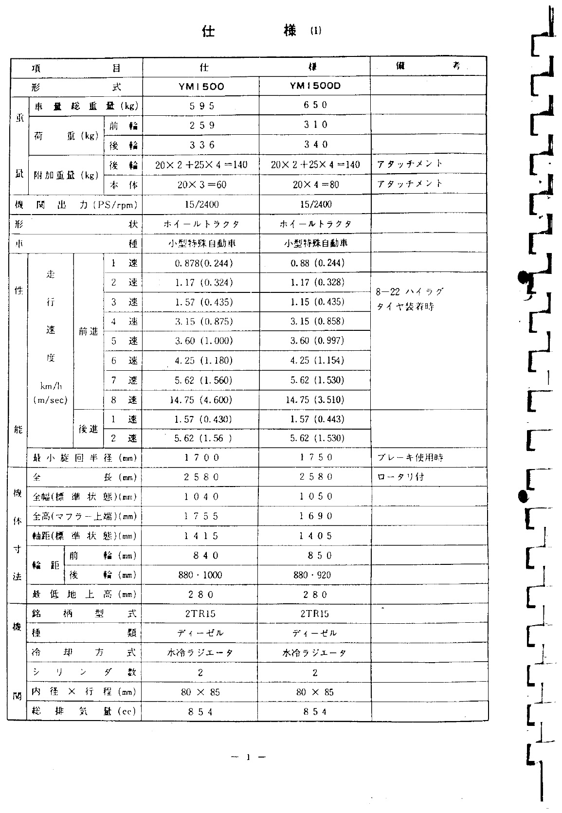

Does anyone know where the redline is on the ym 1500 diesel engine?

Does anyone know where the redline is on the YM1500 diesel engine?
In the YM1500 Parts Manual, the specification sheet on page-3 shows 2,400rpms. There is usually a safety percentage of 200rpms on engines as the gauges are not 100% dead-on. Are you setting the throttle limiting screw to stop right at the top limit?

No, just purchased a 1500 and want to know my running parameters

Just from memory I think 3,000 is the absolute maximum allowed going downhill or something for YM240, a slightly larger similar 2-cylinder from that era. I think the governor max - the manual calls it 'fast idle' - is 2,800. 'Working rpm' 1800-2400.
This is just to give you a general idea. It needs more research.
The YM's are built for low to medium speed torque, they don't get their HP rating from high rpm's like a lawnmower engine. (HP = rpm x torque).

See attached, it is 2,400 rpms.
Line-8 in the chart ...
I think that 15 @ 2400 is just rated Horsepower. Above that torque is diminishing, and it risks excessive wear (some stresses go up with the SQUARE of the rpm increase) and/or you are exceeding the designed cooling capacity. But I don't think 2400 is redline like you see in a car which cautions about immediate disaster.
