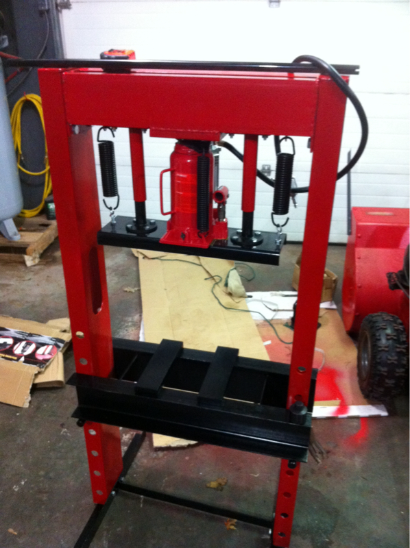

Our local TSC had a 20ton shop press on sale 4 months ago.
Regular price $449+tax for $249+tax.
I finally received it yesterday after calling the manager last week to see where my press was.
Anyway I assembled it yesterday and will be modifying it to accept a Mastercraft Air/hydraulic 20 ton bottle jack.
Here are some pics.

Will do! It depends on your stores policy (all independently owned); my local store is quite difficult at times. I was thinking of welding angle iron to the plate where the jack sits to sort of keep it in place. It just sits there; is that common?
   / Red Torin 20 ton shop press mod #4
------------ I was thinking of welding angle iron to the plate where the jack sits to sort of keep it in place. It just sits there; is that common?

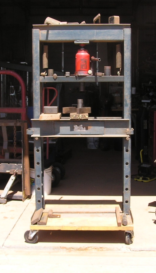

Yep, my 20 year old Carolina has a ridge around the top, but nothing at the bottom. Makes it easy to remove the jack for use on the floor.
I was thinking of tracing out the jacks bottom plate on a 1/4" piece of plate and cutting it out.
Adding a small flat stock piece all around and welding (like a tray for the jack)
Putting tabs on the bottom of this tray to keep the jack/tray in place relative to the u channel it sits on.
Like the wheels. Was also going to make a buggy to raise up the press to a better height.
I'm 6'5"" and find it low.

Yes the top only on mine is boxed in. A couple of tabs welded around the bottom could never hurt for what it would take.

I used 3, 2x12's, with 6" casters. The best thing about it is now when I drop a heavy piece of metal, it lands on the wood, instead of chipping out a chunk of the floor.

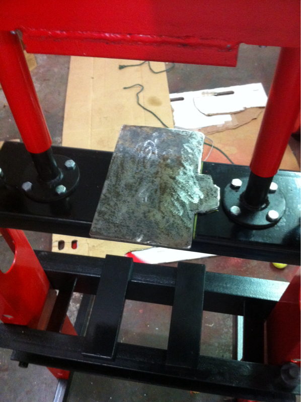

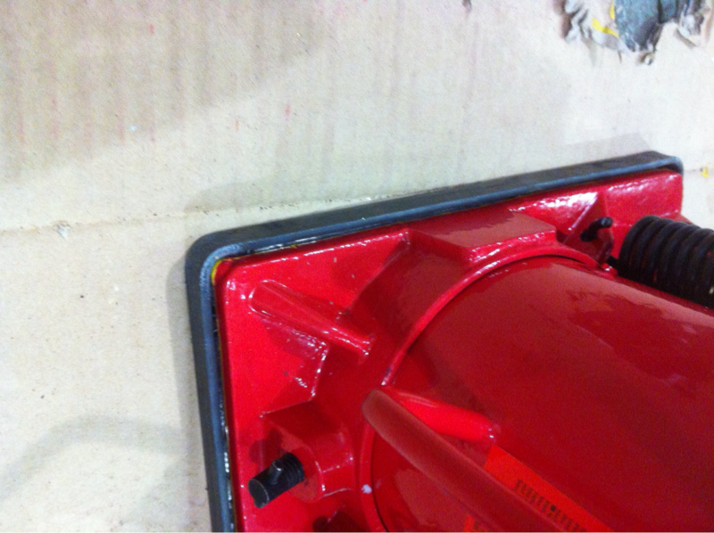

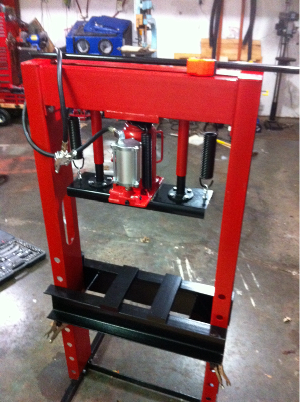

Well I managed to cut my 3/16 plate with an angle grinder and super thin cutting wheel (who needs a plasma cutter)
Bent a flat stock pieces of 1/8x 1/2" around to create a border so the air/hydraulic jack doesn't fall out when the press is moved.
Only tacked into place but will burn in tomorrow and make bottom U Channel to jack plate indexing tabs then prime and paint.

What you've done so far looks good. I thought you were going to get a different jack though? Why go through making the base for this one if your getting a diff one? Or that thought has passed?
