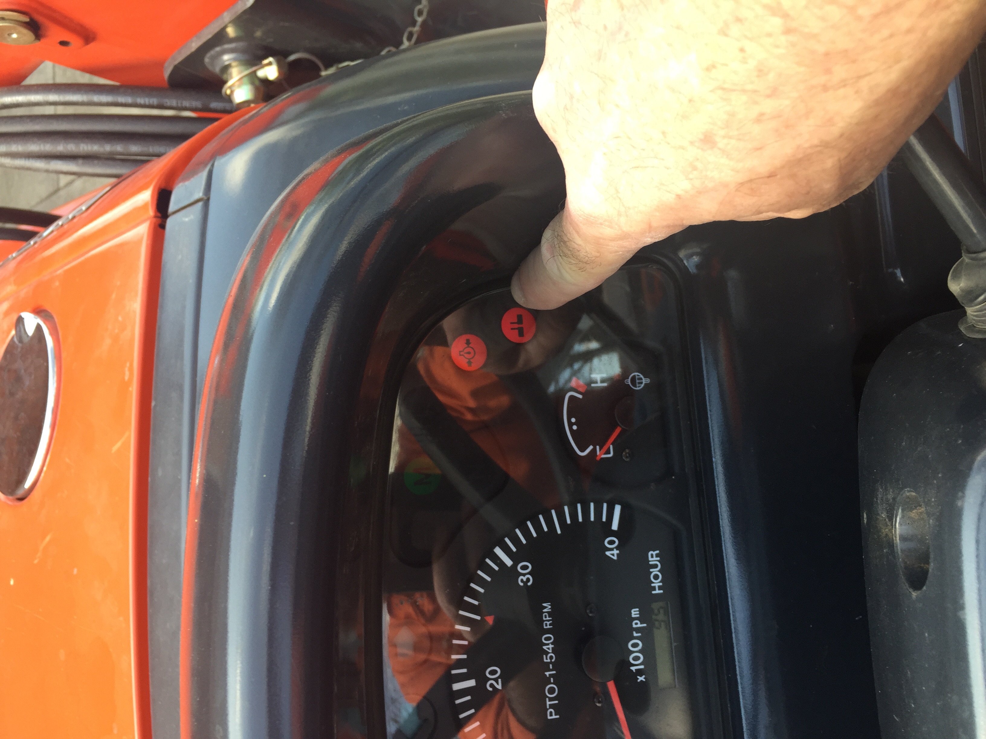

Red indicator light, right side second one down? Dk40 hst
   / Red indicator light, right side second one down? Dk40 hst #1
Illini22
Gold Member
Aug 14, 2007
472
Northern Illinois
2013 Kioti dk40 hst, wright stander zero turn
It looks like two "thumbs up" facing in. I looked in my owners manual and don't see it in there. I'll try to load a picture.
   / Red indicator light, right side second one down? Dk40 hst #2
That's the light that alerts you that the left and right brake are not locked together.
On the pair of brake pedals, you'll find a swivel lever that connects the two brake
pedals together.
With the two brake pedals unlocked, you can use either the right or left brake
to assist in steering (making a sharper turn).
Trails end, thanks for the tip!! I let a buddy use my tractor and the light was on when he returned it. I immediately shut it down (red light vs an amber or orange one) and started thumbing thru my book. I never did find a description of it. I don't think it should be red thou, that is usually reserved for a more serious problem with tractor. Thanks again.
   / Red indicator light, right side second one down? Dk40 hst #4
Cruise control will not work when brake pedals are not locked together either.
