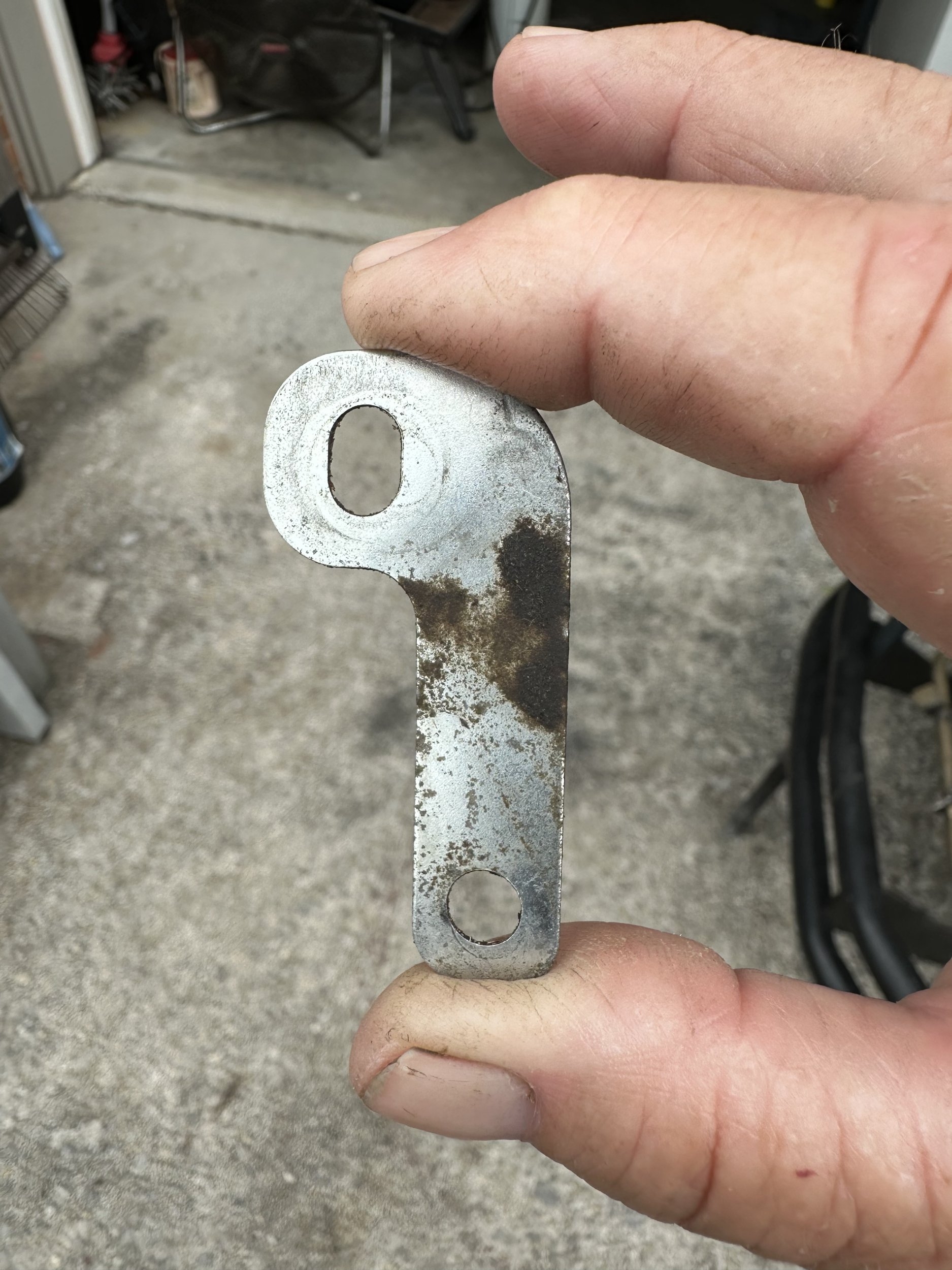

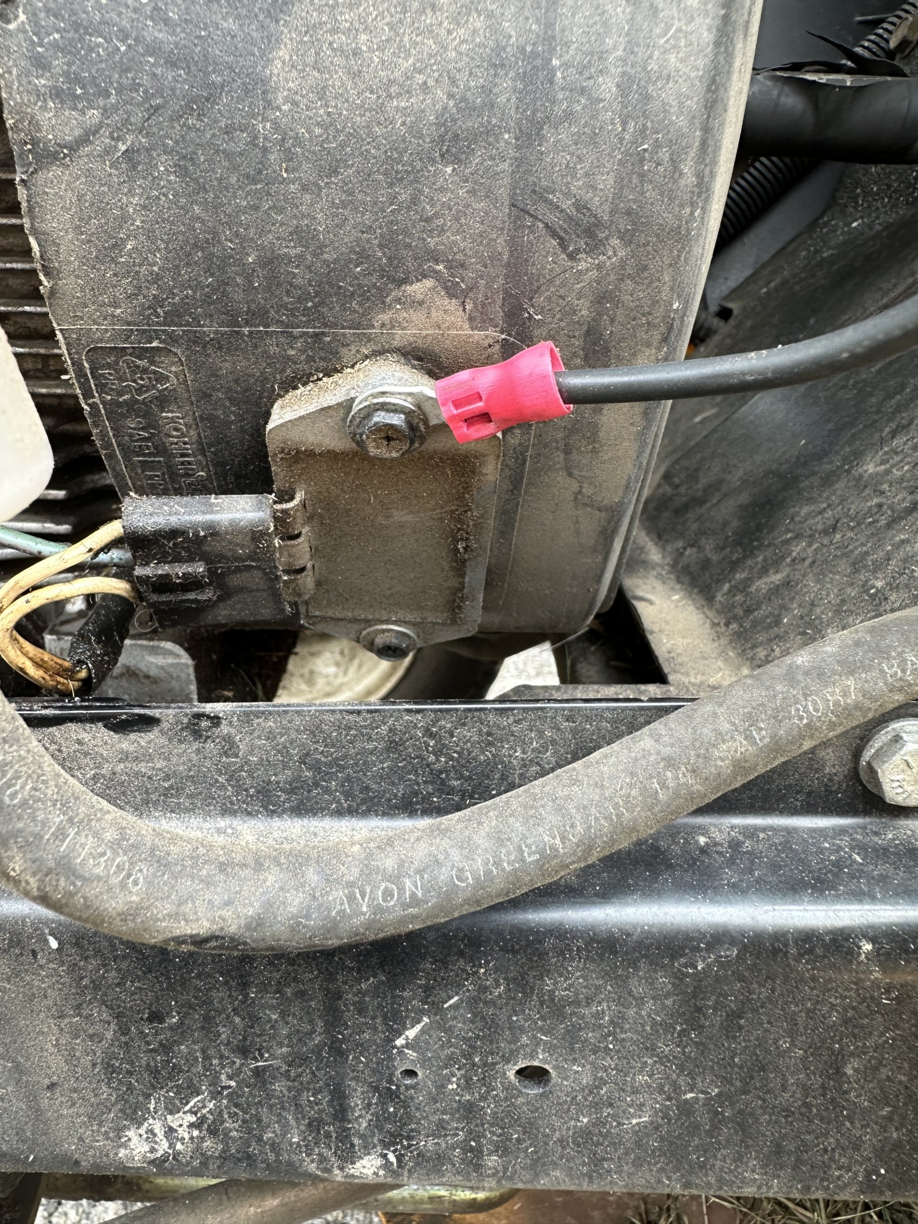

What is the location of the ground strap bracket for the recttifier mounted on the rear housing?

On Kohler the strap would go from the right rectifier mounting screw to the blower housing bolt just below the rectifier. Same with the ground wire that some of the engines use instead of the strap.
   / Rectifier ground strap bracket
That fixed it. I had to replace front and rear seals on the engine and I completely forgot where the strap was located. Thanks a lot.
