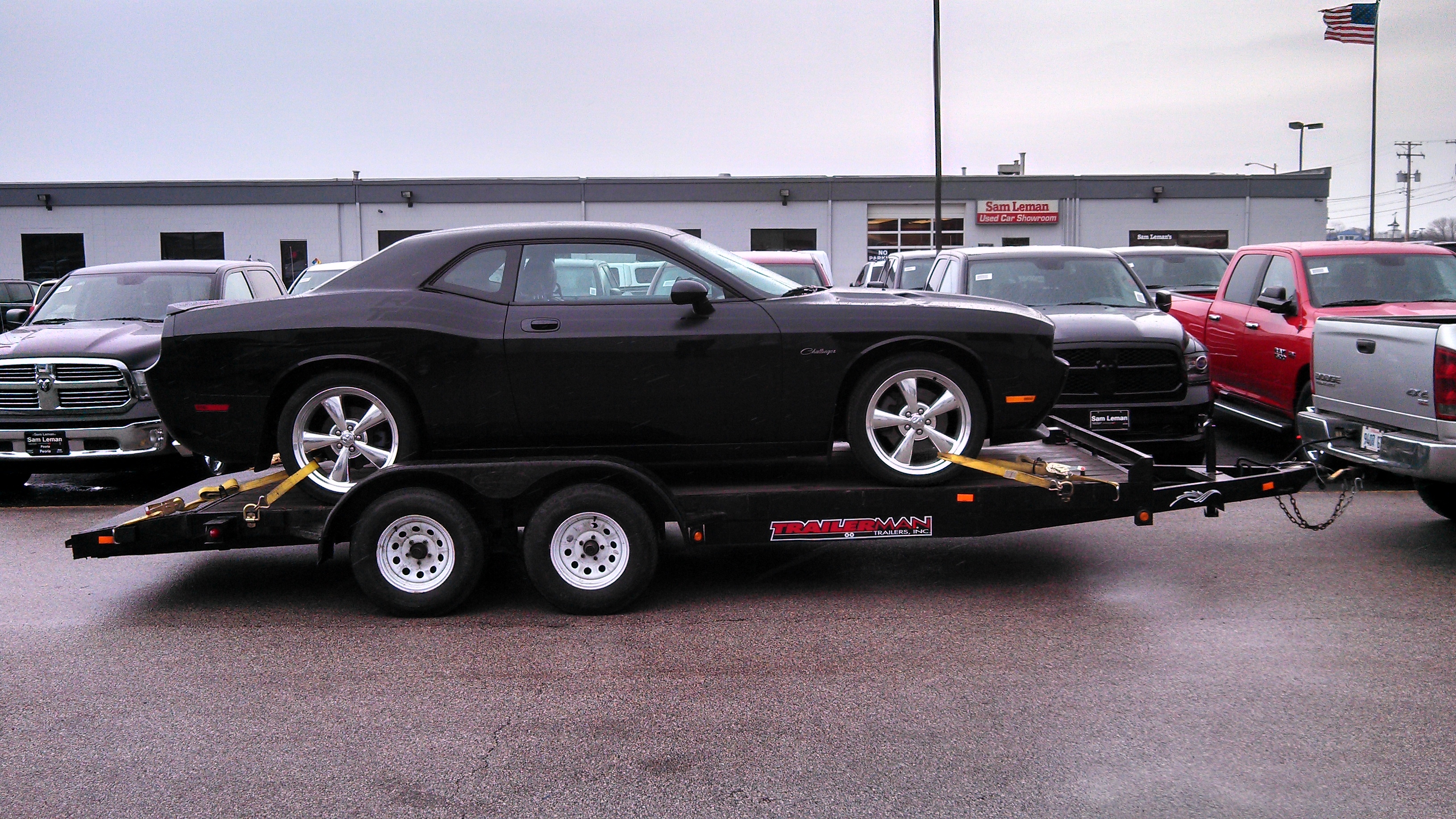

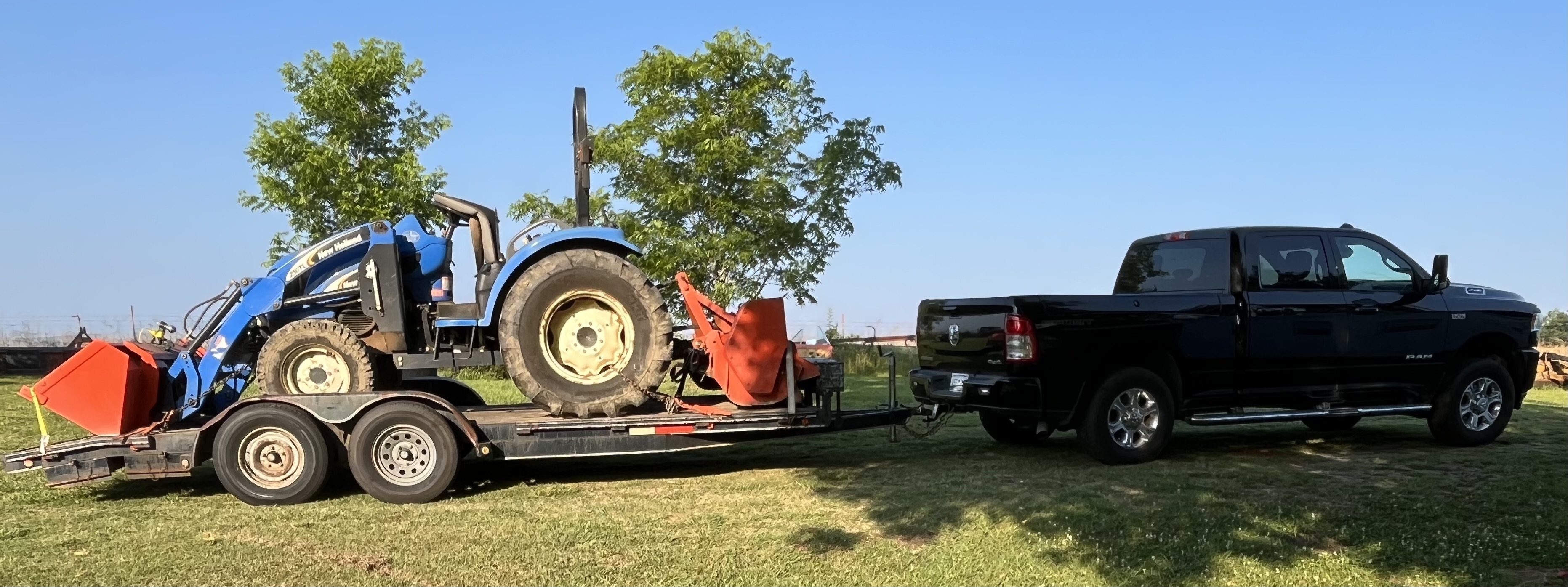

I've been using a 16 foot utility trailer but the sides make it difficulty to haul vehicles. (The tractor is OK because I have D-rings in the deck.) I just bought a Big Tex 18 foot car hauler. With the stake pockets, I've built 16" removable sides and I think it will work well for all uses.
   / Recommended Trailer Type for Materials Hauling and Occasional Vehicle Transport #4
That’s what I have other than the manufacturer and the fenders get in the way when loading from the sides.

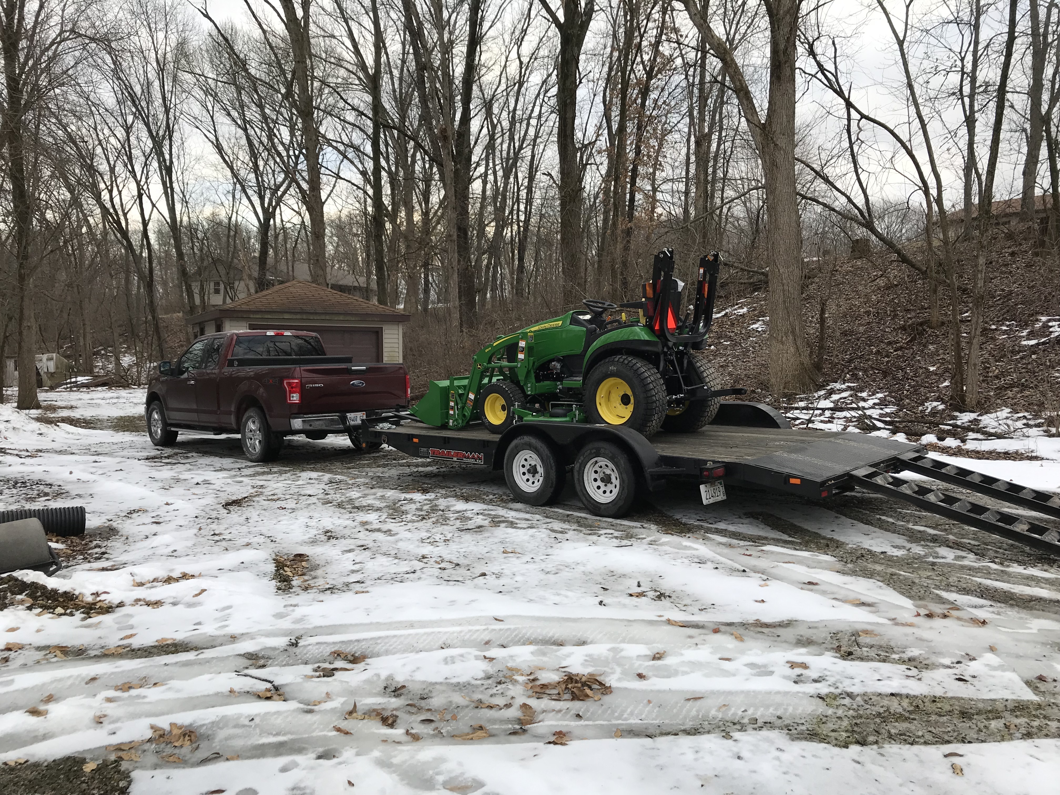

The cargo you are listing is most easily loaded/unloaded with a forklift or pallet forks, and for that, I really like my 10,000 PJ 20' deckover.

Thanks. Lots of work to do here.....
