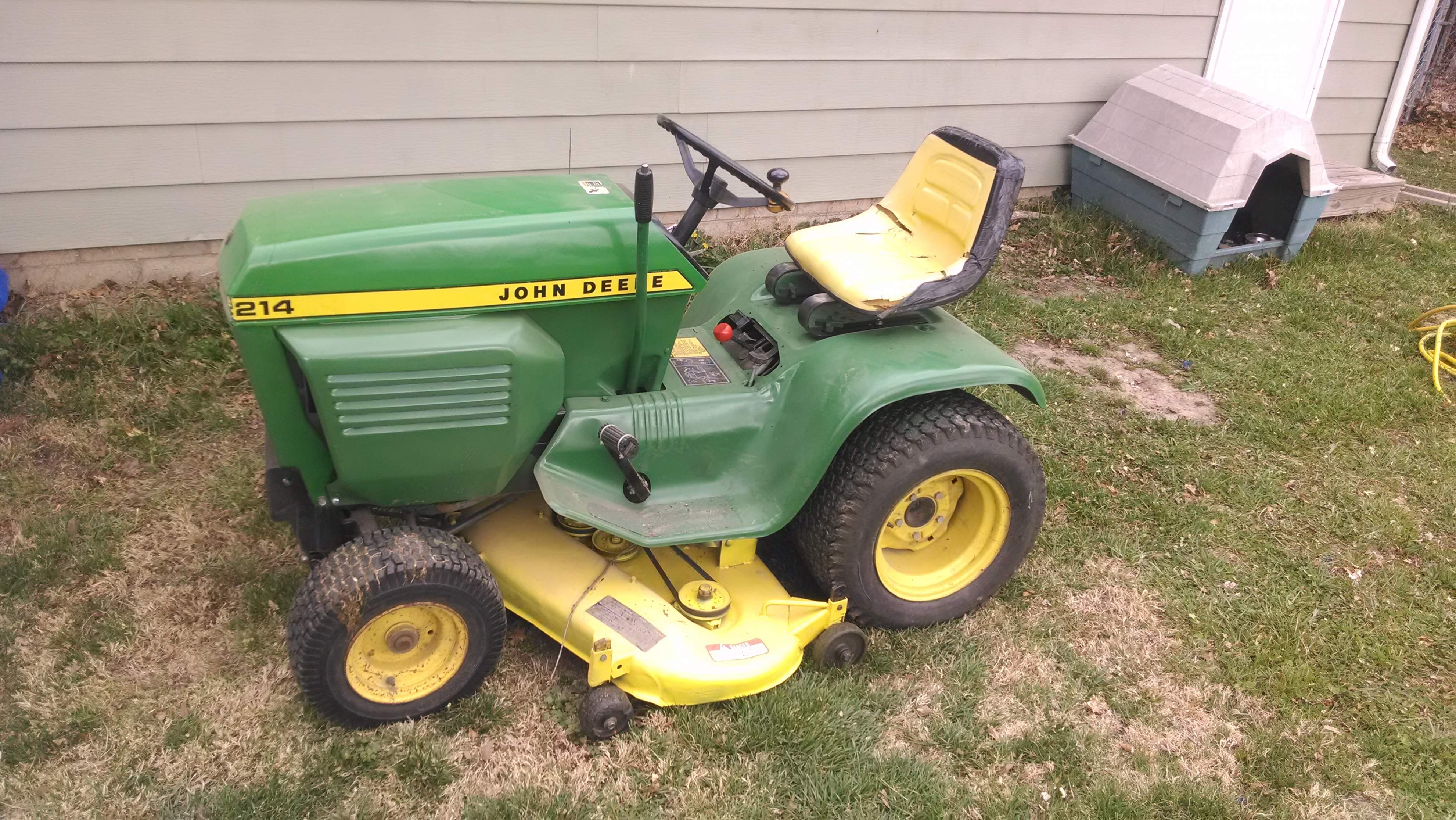

Well, with some good luck and advice, the JD 214 is put together and got her first work out today. Paid $ 300 for her, spent another $200 on maintenance, cosmetics (a replacement hood/used) and paint, a little welding on the deck and a new pto/deck drive belt. I probably rushed the first yard mowing by a week, but what the heck. Anyway, she performed great for a 30 year old lady.
   / recommended start of service for my JD 214 Lawn n Garden? #5
nice looking ol girl!
sounds like you did ok.
