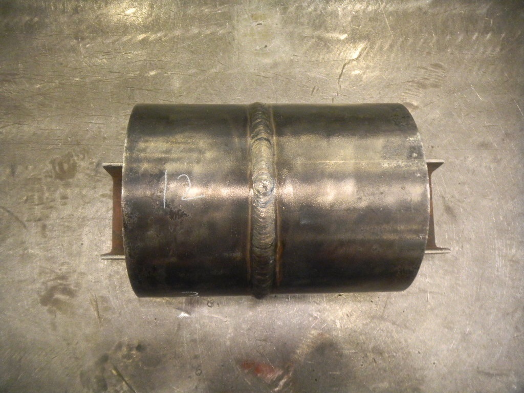

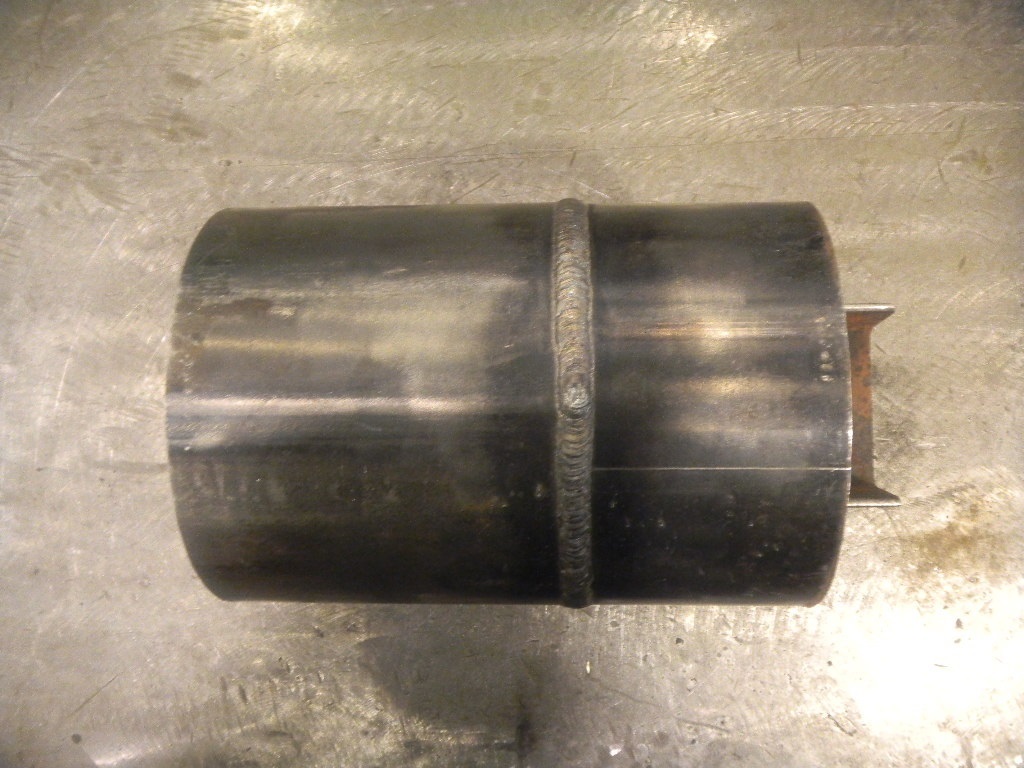

   / Recommendations on Welder for Beginner for Farm #4
