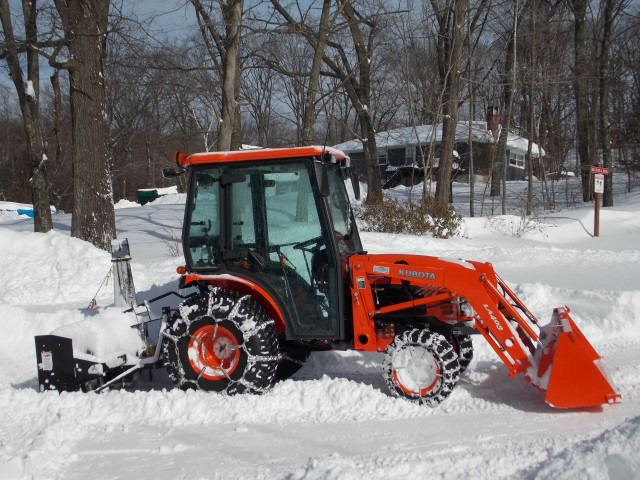

I bought chains for my BX-25 from the Kubota dealer. I view chains as money in the bank. If you ever need em, they are far cheaper than a tow truck. Here's a pic of my B3030. The first and only time I had to chain up the fronts as well as the backs, was when we got clobbered with 30" in one storm last year.
I forgot to mention: In the land of snow and ice, the man with chains for his tractor is king!

Nice pic! Looks like your front chains have nice tight spacing but the rears have a bit of gap. Did that matter at all? I will be on steep slope and I am worried about slipping sideways if the chain is not always in contact with the ground.
