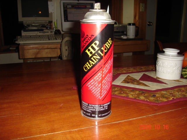

   / Recommendations for Front mount snowblower Chain Lube? #5
Ditto Toad Hill!
I've had good luck with Honda "HP" chain lube; it drips a bit, but not very darned much- I just put a piece of cardboard under the chain section of blower to keep any drips off concrete floor.
