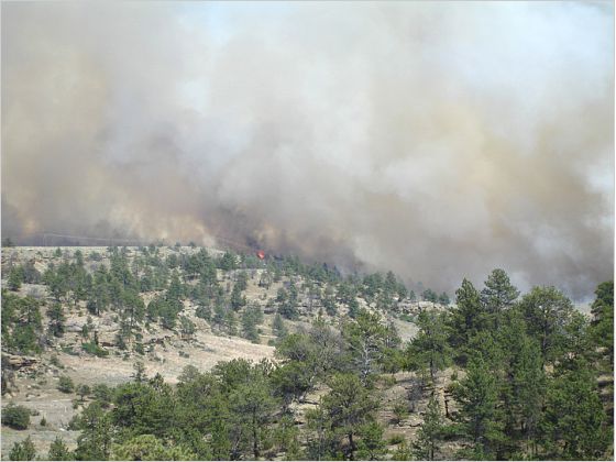

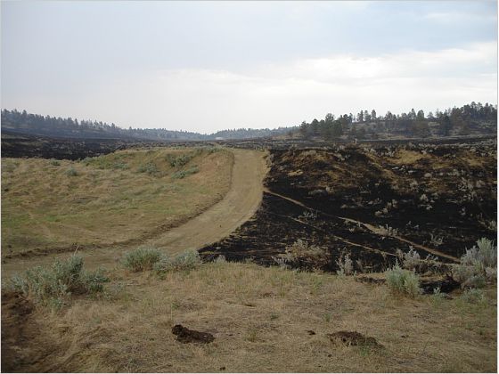

First of all, thank you for such a knowledgable and active forum. I was looking for a tractor a year or so ago but did not go for it for a number of reasons. Well now I am back at it... We had 2 wildfires get within a couple of miles of the house this year and that was enough. I have been loosing the war against the weeds this year with the roundup, weedwacker and mower- it is time to make a stand!
Here is my deal. I have 18 acres prairie, sage, STEEP hills- typical central Montana terrain. I have a bunch of dead pine trees and branches that I cut that need to be carried out. I will brush hog at least a third of the grass (mostly along the hill where the steep stuff is) and realistically I'll probably attack the rest of it as well. I have a very long gravel drive that needs to be graded on a regular basis. I also have no landscaping around the house so I'll need to address that at some point. In addition, I'll need to shovel snow when the occassional storm dumps on us.

Welcome - bigsky. Thanks for the pics. (A little too smoky for hot dogs - IMO - but that fire sure'd keep the mosquitos outta your potato salad!)
