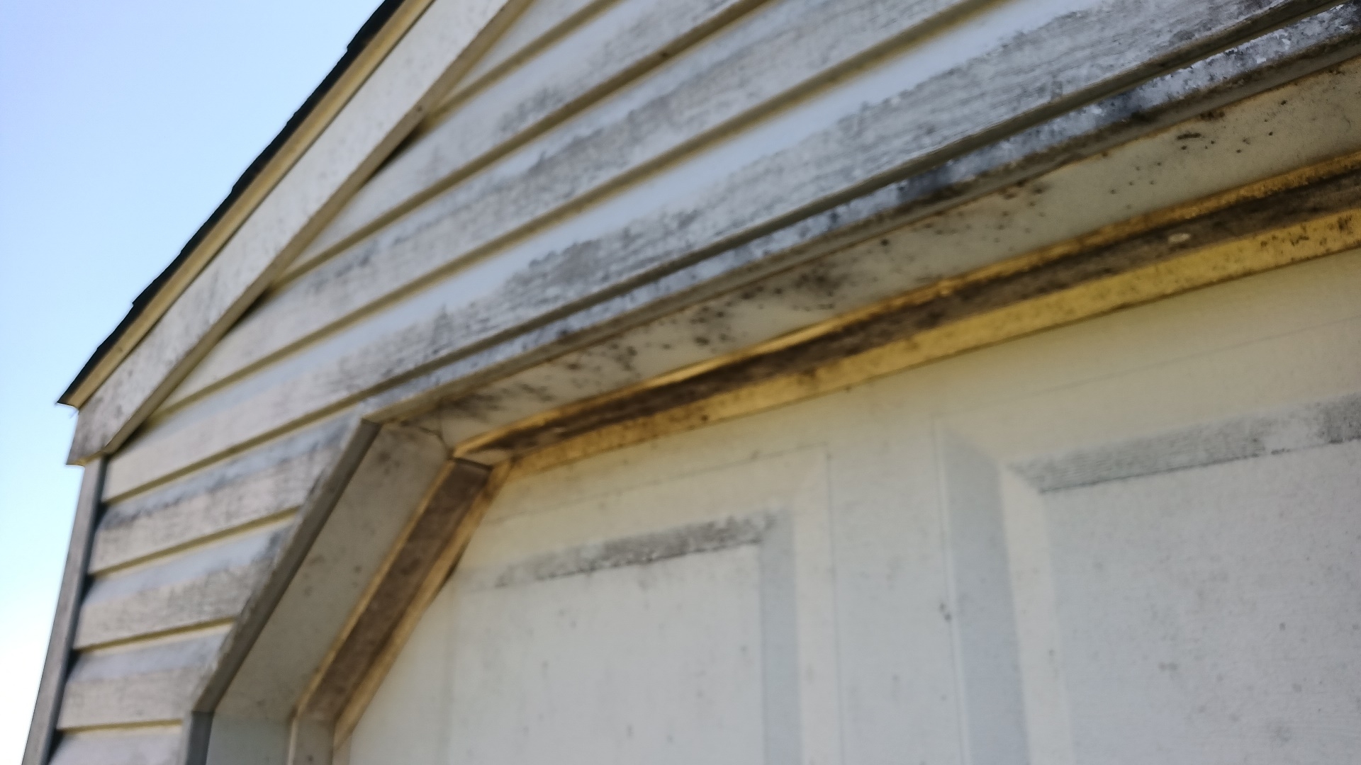

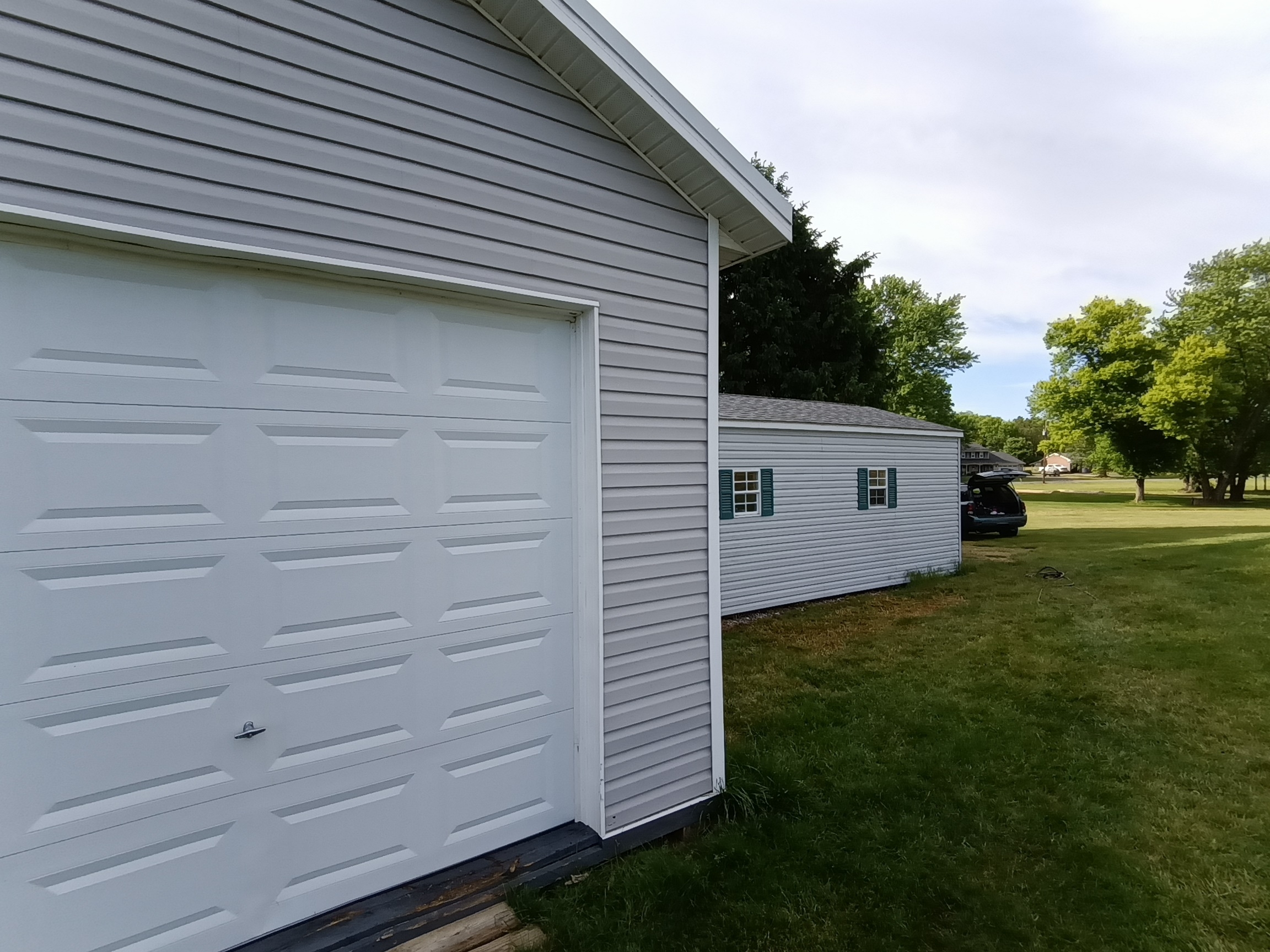

Here's the difference it made on my sheds 2 years ago. I did work in smallish areas so it would stay wet. A little brushing with the car wash brush and rinse off. Since it does have bleach, wear old clothes and something over your eyes. My baseball cap brim got lighter spots when enthusiasm kicked in:)
