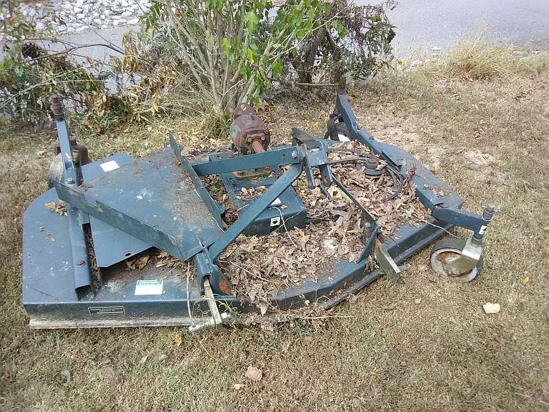

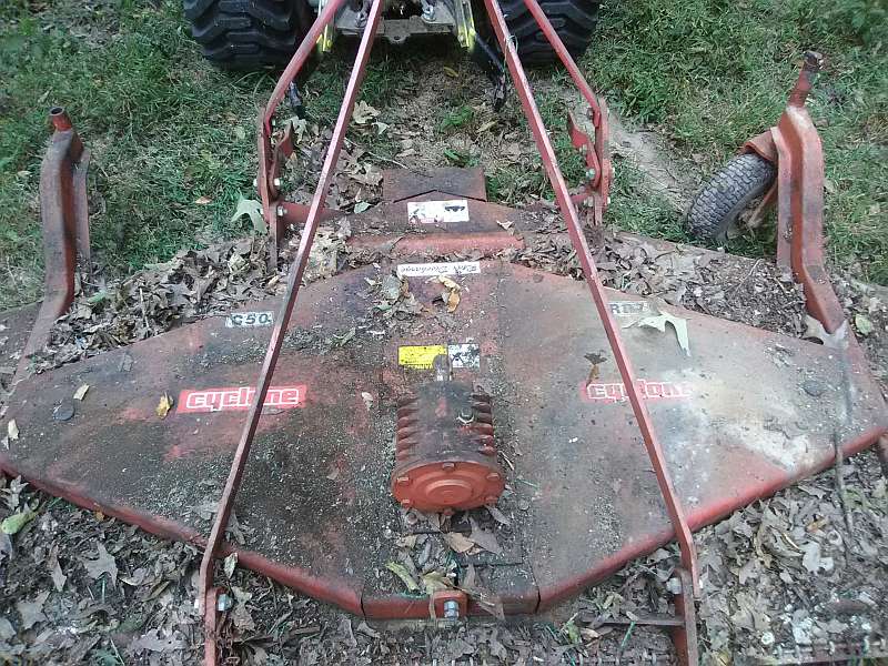

OK, they're all finish mowers. The grey is the only one where the gearbox rotates. The yellow and red do not. Blade spin doles don't rotate on any of them, but none of that is surprising considering where they've been for so long. Sheet metal is all intact and not too heavily rusted. Couple of gauge wheels missing, but I think they have those inside their shed, so I'll have to ask. One is all torn up, but I think the $5 HF pneumatic cart wheels will work.
Red says Cyclone C50 RD7. I'm guessing that means 7 foot, which is too big for mine.
Yellow says Walton, but I haven't found any other ID yet. Measures 6 foot wide and appears to be side discharge.
Grey says Modern Manufacturing and a serial number but I haven't found a part or model yet. Also measures 6 foot wide, but is a rear discharge.
Replacing spindle bearings is one thing, but I don't pan on replacing gearboxes unless these things are somehow odd or unique and hold some value which I don't expect they do.

The Cyclone C50 RD7 shows as a Befco in web searches with a 'new' pricetag of a little under $4,000.00
I see used 5 and 6 footers for sale, but no 7s so far.

Freed up most everything on the grey one. All three spindles now rotate. One belt is OK while the other is worn, but intact. Got them back on the pulleys and I can rotate the deck by hand turning the PTO shaft. I can tell the gearbox is all but dry, so I'll need to fill that. Will probably use motor oil for a small bit of testing before changing to gear oil, once I find out what type it needs.
One blade is broken off completely. I'll probably get a new set of three and use the two old ones for spares.
Yellow one will take more work.
Haven't even looked at the red one yet.

I think you scored, they look to be in good shape.................Mike
   / Reclaiming Long Abandoned Rotary Cutters. #9
I agree. Good cleaning up could reveal some absolute steals
   / Reclaiming Long Abandoned Rotary Cutters. #10
Did you find all the gauge wheels that are missing in the photos? Even without them, free is always a bargain.
