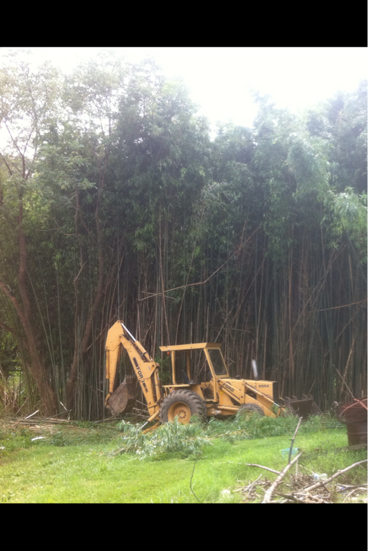

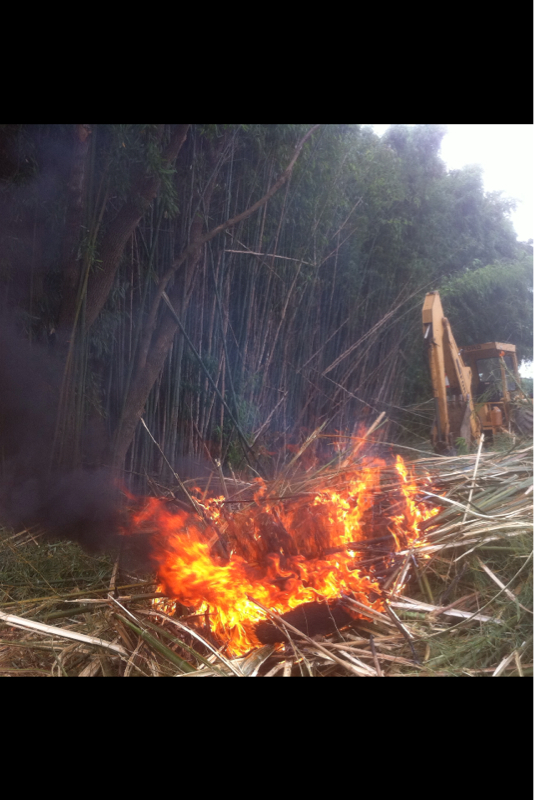

The guy we got ours from had an excavator dig a hole, dig it up, burn, and bary. He had zero regrowth it's all grass pasture. I am in the process of tearing ours out. When done I will just continuously mow so if it keeps sending chutes up it doesn't matter.
