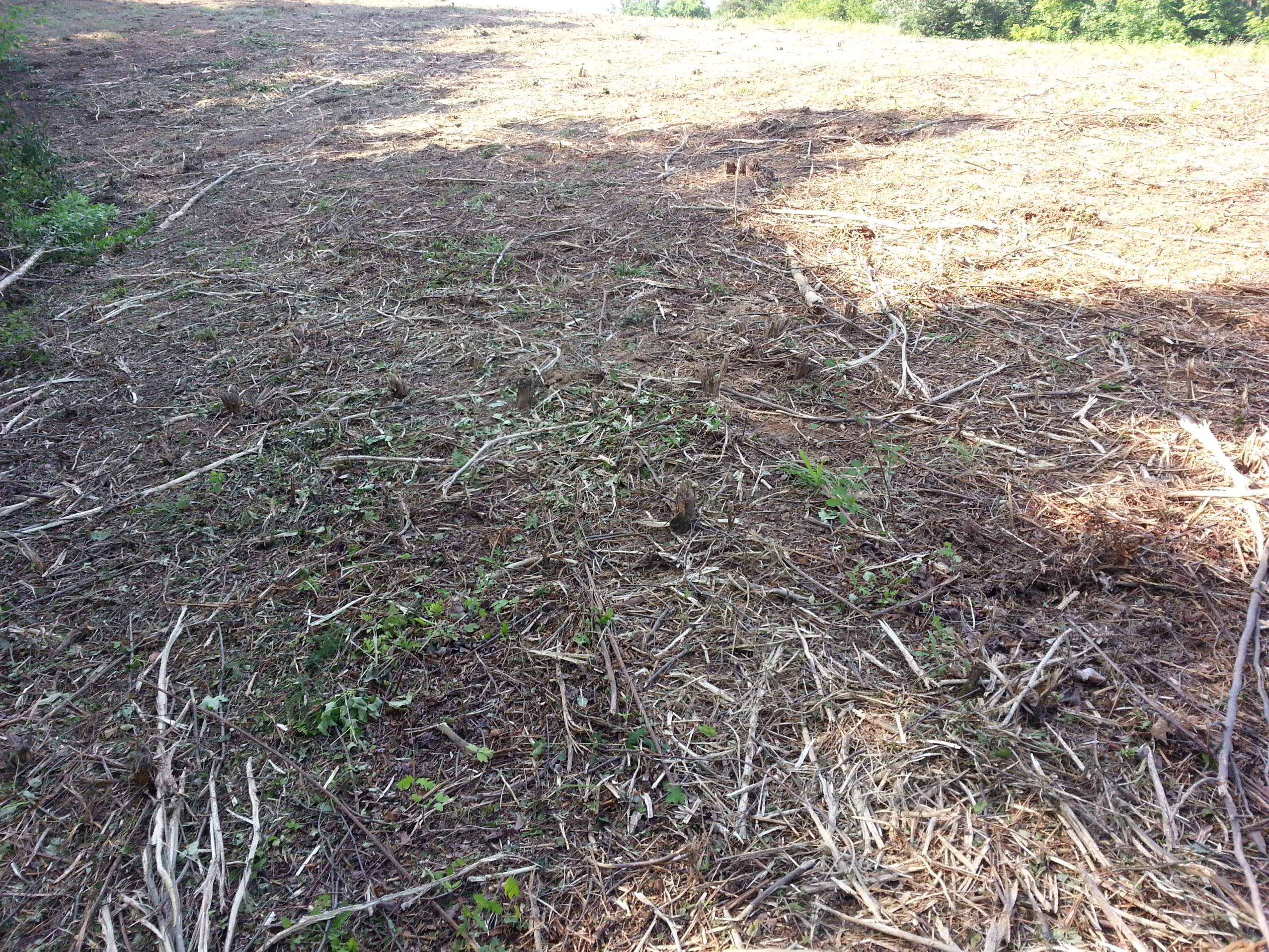

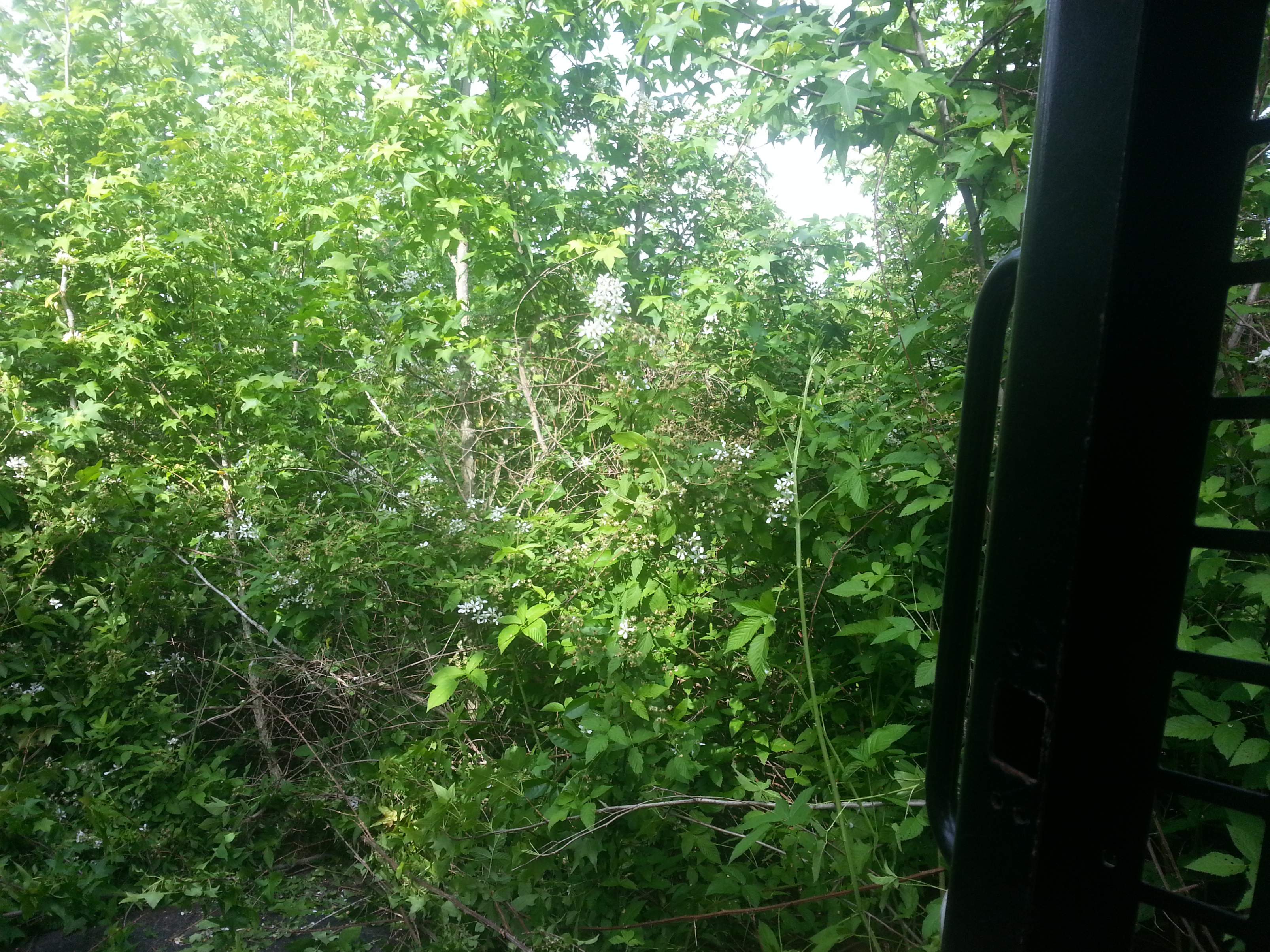

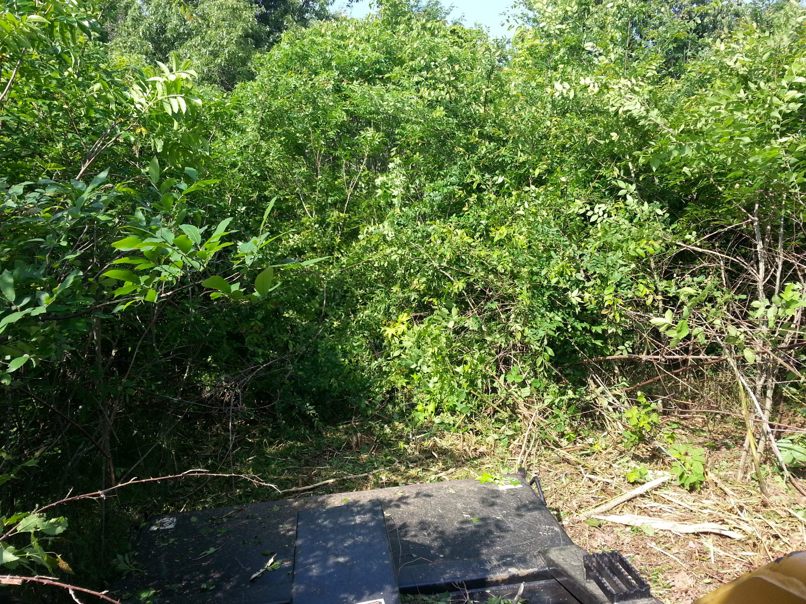

I closed on the 19.5 acres on April 29. Since then I have been trying to get the fields opened back up so that they can be used for pasture. I started out using my tractor & bush hog & it got to the point I decided it would be better if I rented a brush cutter for my skid steer. So I rented one for the long weekend. There is a total of about 17 acres that needs to be cleared. I finally have it down to about 2-3 acres left.

The skid steer is slower than the tractor & bush hog but it does a better job of cutting closer to the ground & cuts the pieces up better.

Looks like I won't be able to finish up until the weekend. A blade broke on the brush cutter & they will have to order one. It will be in Wednesday & the rental place will put it on & I will pick it up on Friday.
