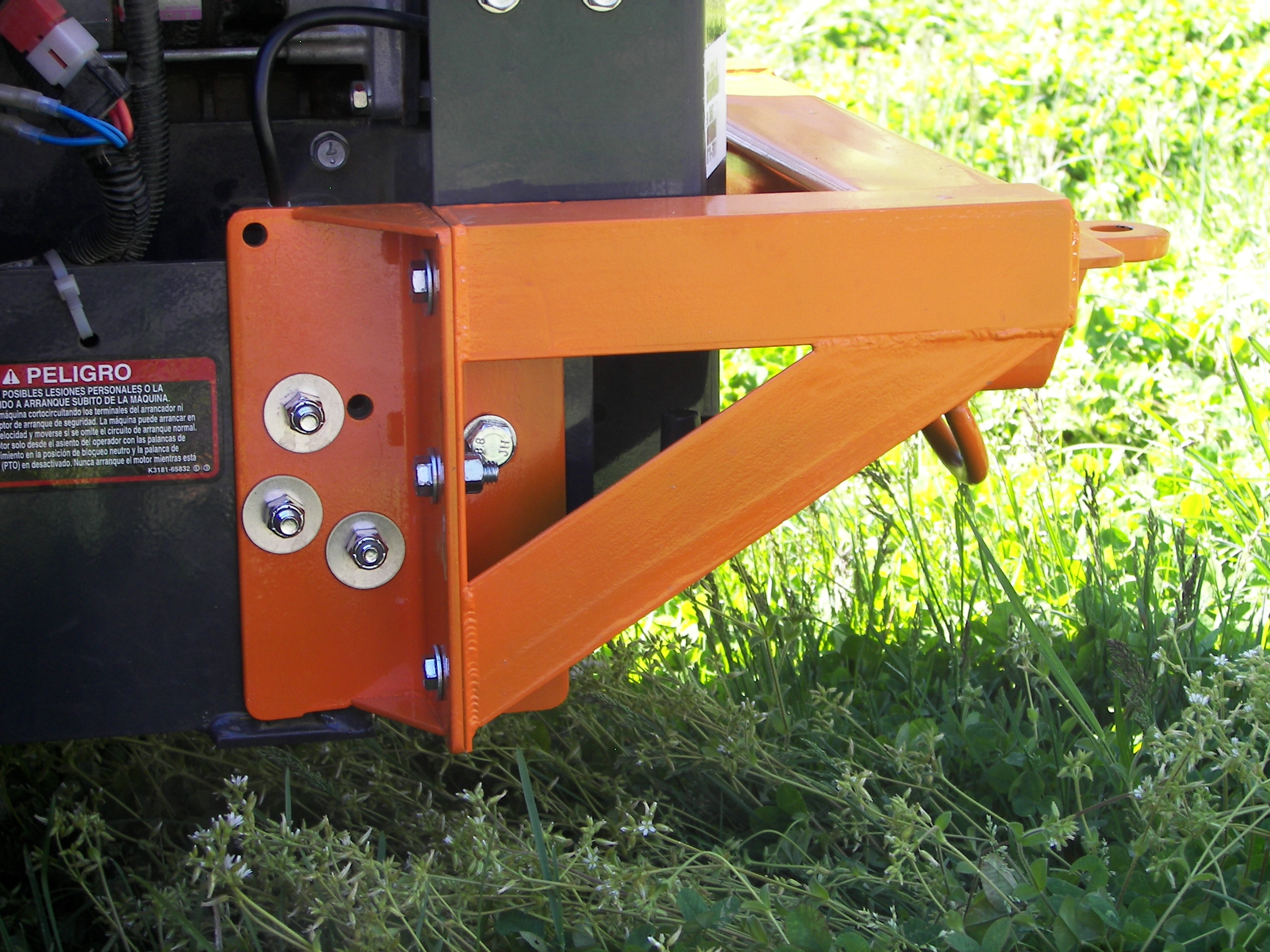

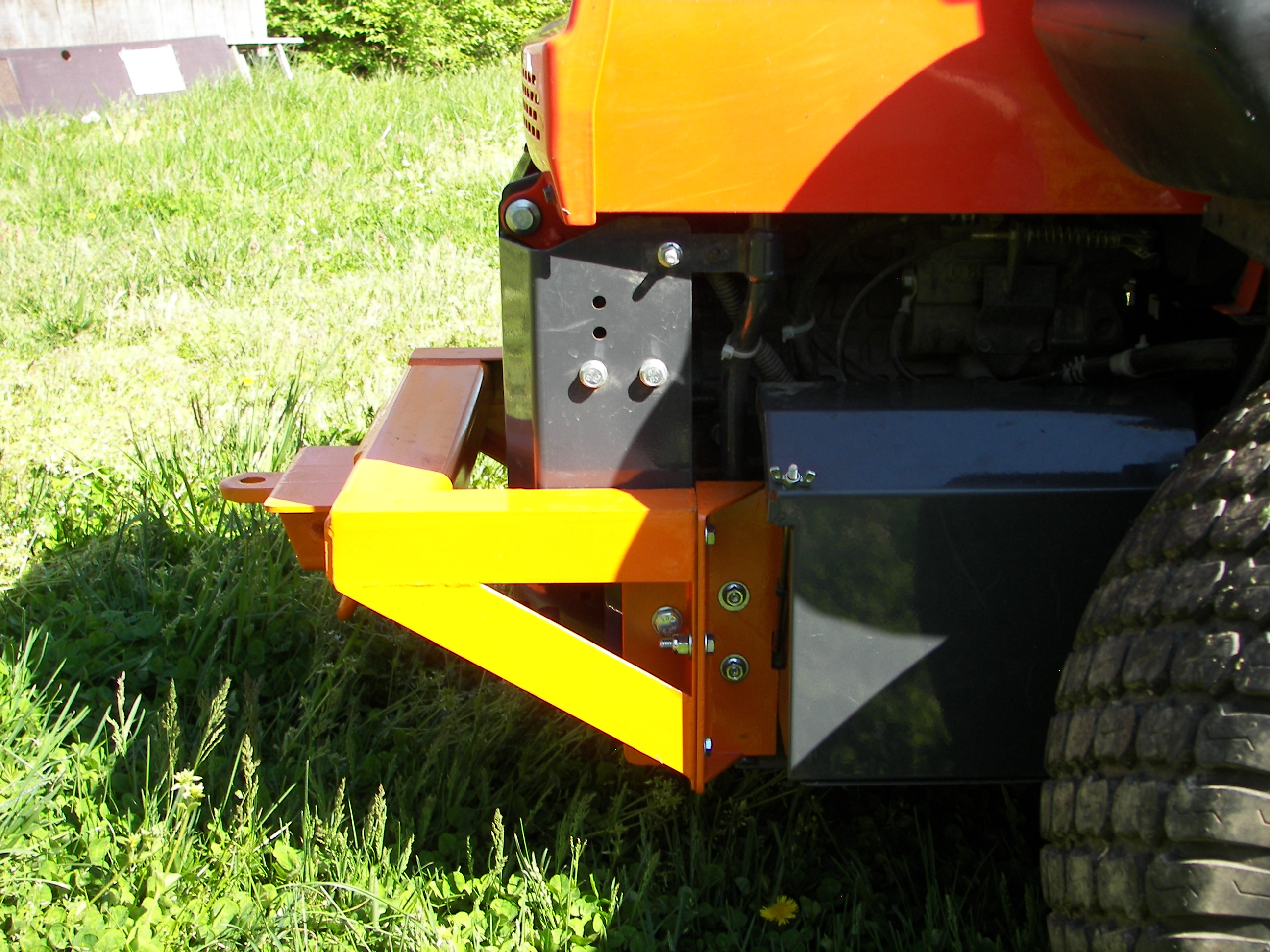

I saw this on a friends ZD 326 Kubota mower. I always wanted a way to pull my fertilize spreader, aerator, and other small implements behind my zero turn.

That sure looks nice, never break that.

I guess he needed some extra weight for traction. No need for it to be that strong otherwise. I used a piece of scrap 1/4" thick x 3" or so wide for mine. I just bent in in an L shape and bolted it to the existing crash bars in back. It works great for pulling a fertilizer distributor and leaf sweeper and even to hook a tow strap in to pull the ztr out of the mud with my RTV when I get too close to the pond.
Heck, 1/8" material would be strong enough for anything a zero turn would pull.

The hitch looks great. I wonder if he discovered some plans to build it. I wouldn't mind buying a copy to create a hitch for my ZD 326.
