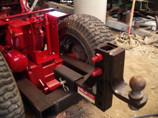

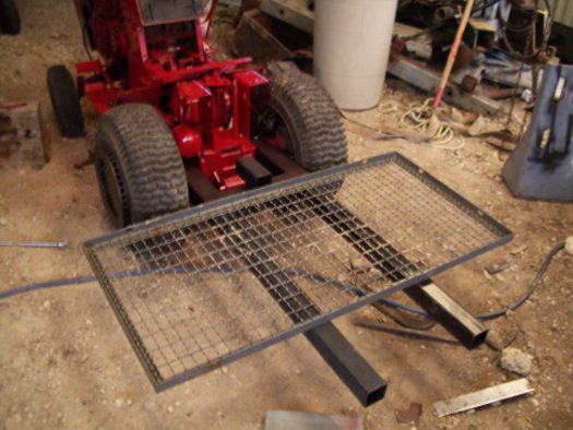

Needed a better way to haul around trailers and haul tools back in the trees where a trailer would get hung up. Here's what I came up with for the hitch and then realized how well it would work as a carryall receiver. I'm not finished with the carryall but you will get the idea.
