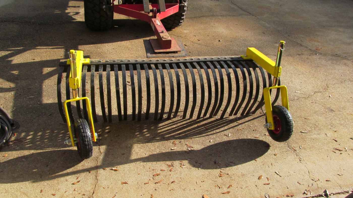

Here is how it looked before.
This is how the angle bent.

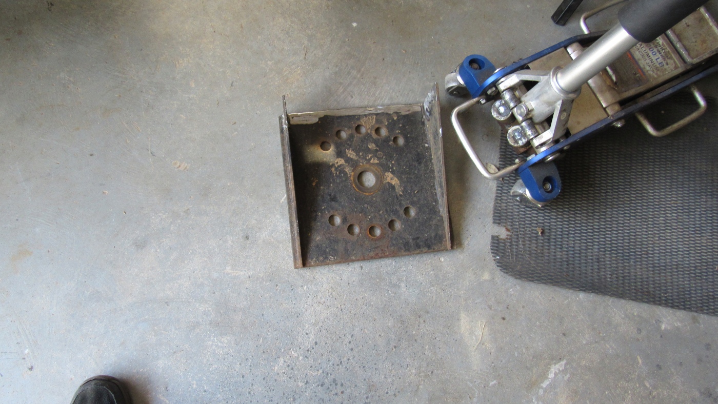

I had to cut the pad off that mounts it to the main frame.

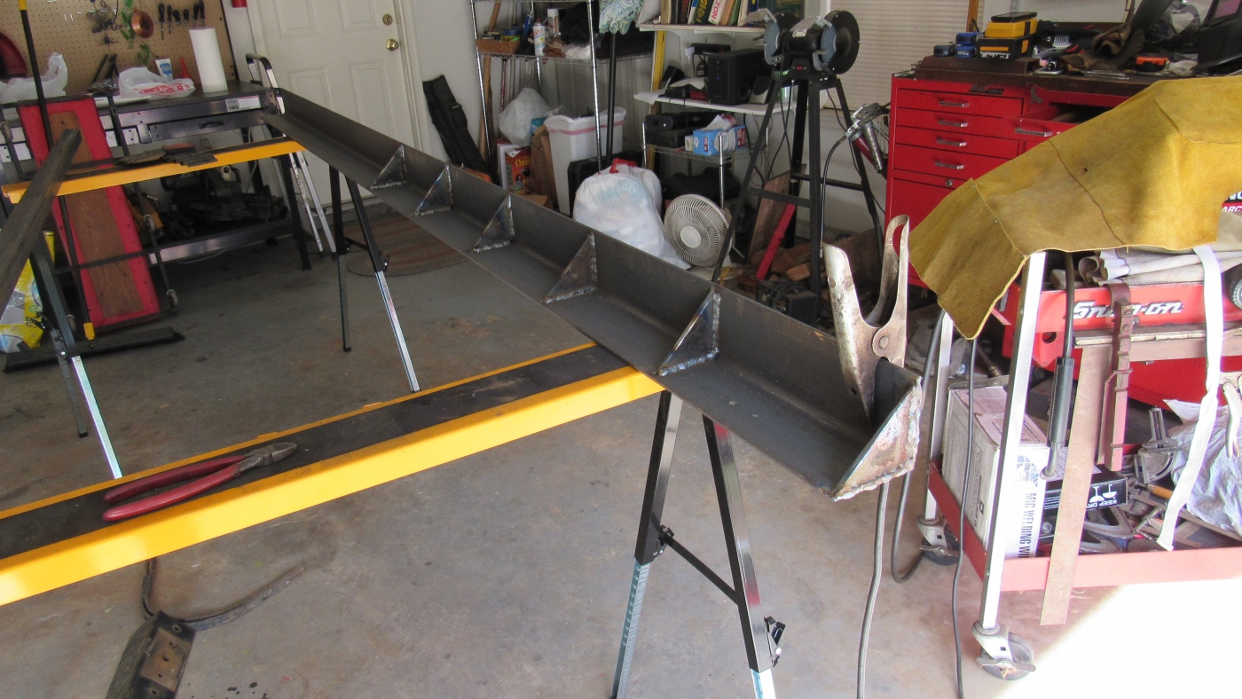

The metal supplier I use only sells 10 or 20 ft lengths. I left it the full 10 ft while I welded the gussets in. I cut the gussets from the straight part of the old angle.

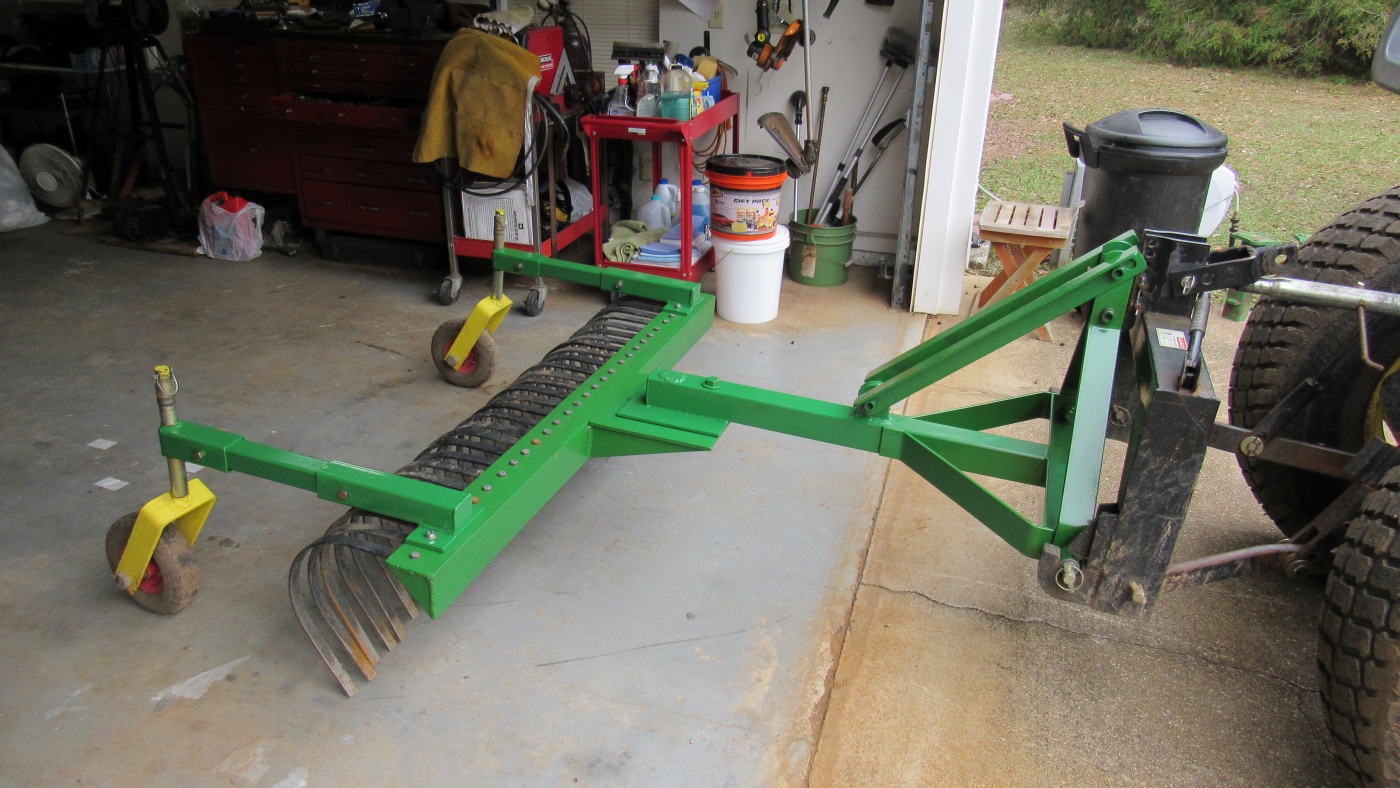

Here is the finished product.
Finally, instead of having it swing loose on the pivot with a locating pin I bolted the pivot bolt down tight and added a 3/4" bolt to the locater hole and tightened it for added strength. If I want to angle it I will just loosen the pivot bolt and relocate the locater bolt and tighten it all back down.
I'm pretty happy with the finished product. I was able to set the tines right at ground level and use it as a rake on the first test. Before it grabbed and pulled a lot of soil no matter how I set it. It should be more useful for grading at a lower setting also.

That should last life time. :thumbsup:

Consider moving the gauge wheels inward. When you swing the rake out to 45 degrees to eliminate roller coaster effects, the wheels will be outside the tine area. Best to have them inside the tine coverage area.
