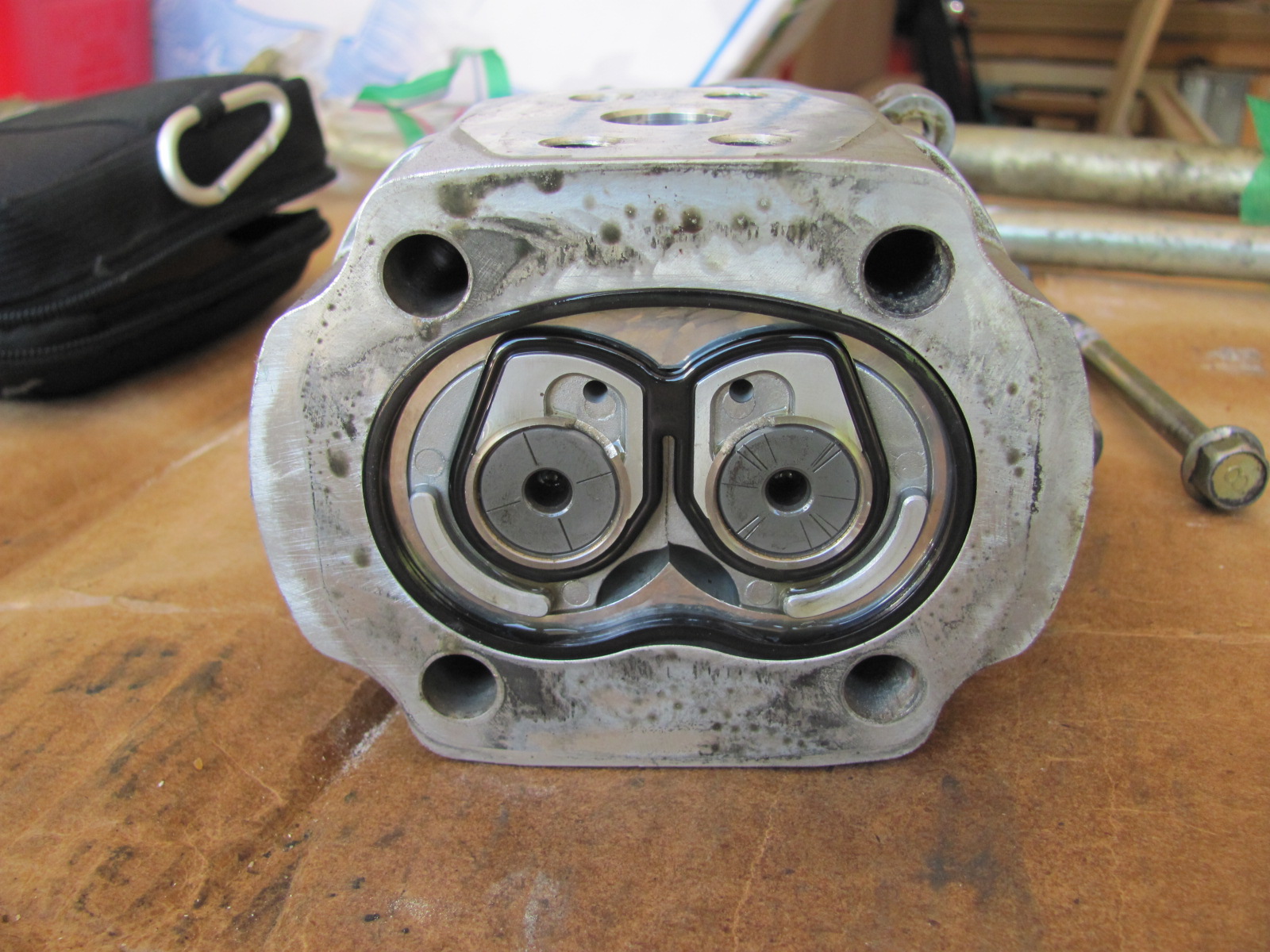

One of the seals inside the hydraulic pump was blown which blew the front seal forcing the hydraulic oil into the engine. I removed the hydraulic pump of my TC45D and had it rebuilt with a new seal kit (SBA340293698). I just installed the hydraulic pump and now the pump is not pumping. The FEL won't move, either will the 3PH or the PTO. The fluid levels in the engine and the trans are full. I'm wondering if I need to prime the pump? How should I prime it? Any help would be appreciated!

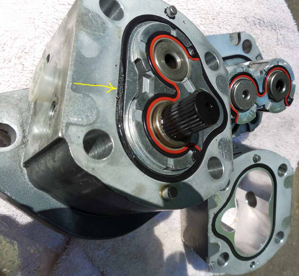

Since you have done a lot already, I suggest that you remove the pump and open it up. The
rotor seals in it are complex and need to be installed properly. If the dealer's mechanic did
not send the pump out to a hyd shop, then it certainly may have been rebuilt incorrectly.
I have not done many of these, but here is what they look like inside.

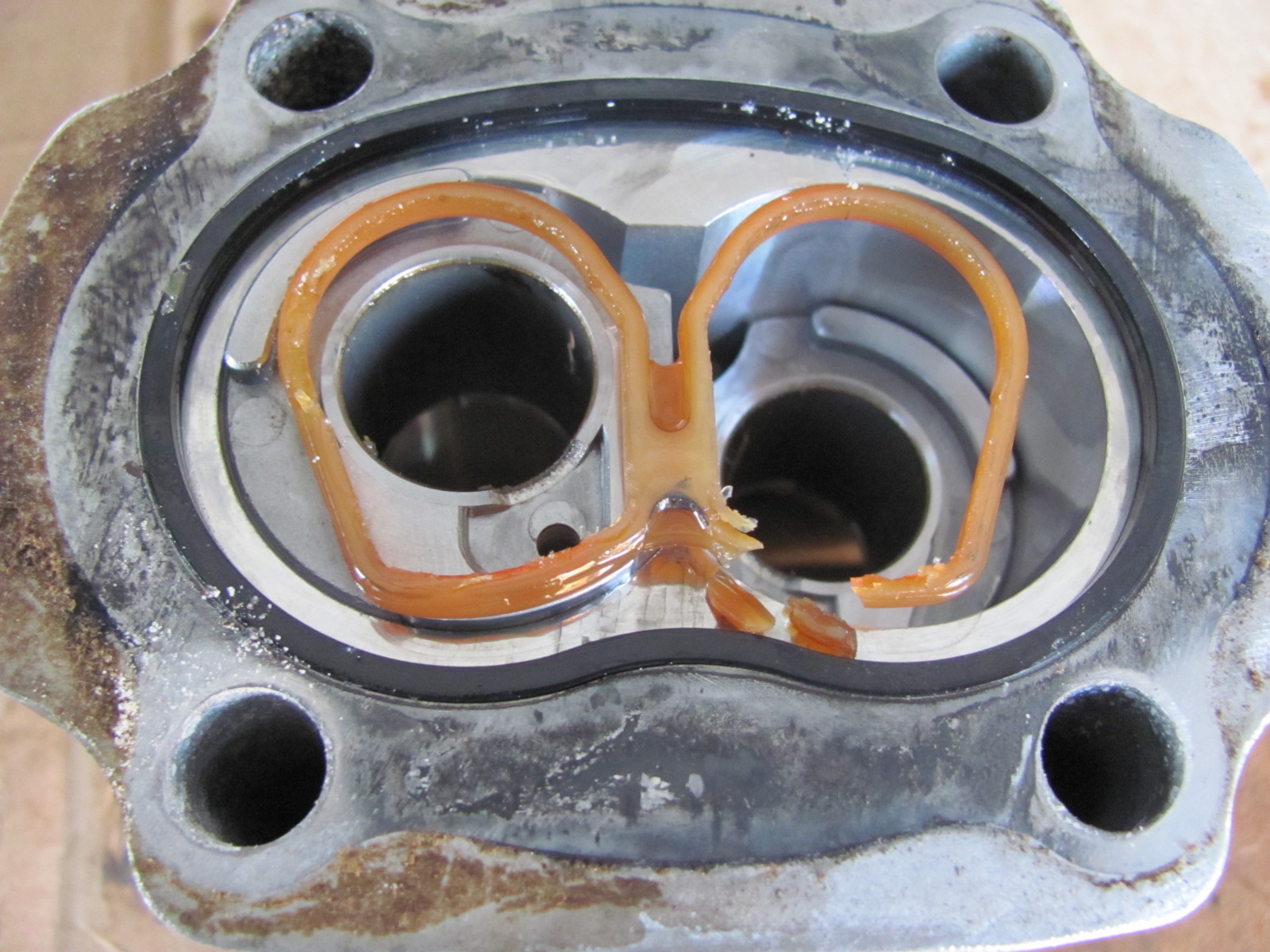

If I can figure out how to post pics here, I have four pics, an illustrated parts breakdown (IPBD), the front seal pic, which is broken then the rear seal pic. The last pic is the Messicks parts list. What I don't understand is what is part 10 and 13 and 12 (on the IPBD) and why I don't have them in my pump. There is only one seal in front of the bushing for the front and rear bushings. I need to remove the pump again and open it to see what seals the dealer replaced. I can only assume this seal kit is for other model pumps. I know my power steering pump has the same exact rebuild kit. Perhaps these seals are used in the PS pump. My only problem with that is you know what happens when you assume!
Is there anyone out there that has rebuilt this pump? What do I need to know to rebuild it myself, other that replacing the seals? Is this covered in any repair manuals?
Messicks rebuild kit.jpgHydraulic Oil Pump.pngIMG_6710 Back side orings.JPGIMG_6715 Front side with broken oring.JPG

Main problem with running these pumps dry are the plain bearings seizing to the shaft. I believe some of this style gear pump use rubber seals under the plastic seals for better life? This may be a design change.
