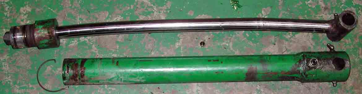

Hi all,
I have a John Deere 855 tractor with a 420 FEL.
One of the lift cylinders has developed a leak.
I tried replacing the seals but no success.
There are a few youTubes on this which are helpful but lack detail.
Can anyone point me to a shop manual, or other reference, that covers this topic?

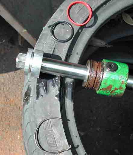

Two of the o-rings in the kit look identical, but have different part numbers. The kit has no indication as to which-is-which and on my first attempt I couldn't get the gland seal assembly back in the cylinder. I swapped these two o-rings and it went back together. I may have just man-handled the rings a bit too much.

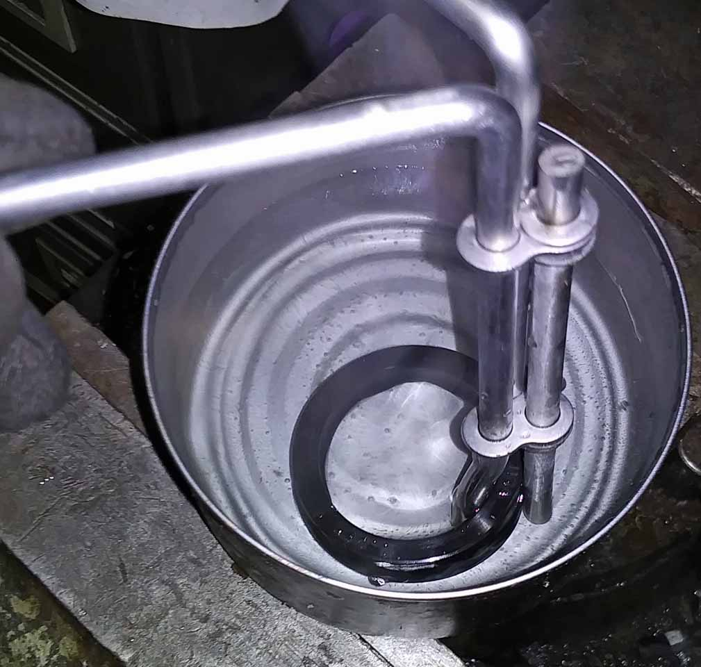

The seals inside the gland for the 420 FEL cylinders are about the most difficult to install, due to the tiny 25mm rod diameter. I have done several of these. Before I went out and bought the right tool for the job (photo).
Before I bought some gland seal-bending tools, I used to take three rods to forma a U-bend in the the seal while heating it in hot water. Not easy!
You could also make this tool.

The problem is that the seal kit came with no instructions or diagrams. I made a pencil drawing of the old seals as installed. All I have to go on is that drawing and the exploded line drawing in the JD parts catalog.
View attachment 748780View attachment 748781View attachment 748782
Yea, I bought one of the seal installer tools. Makes it much easier.
