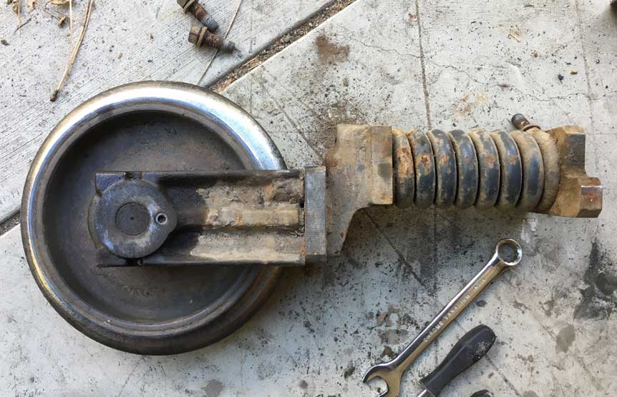

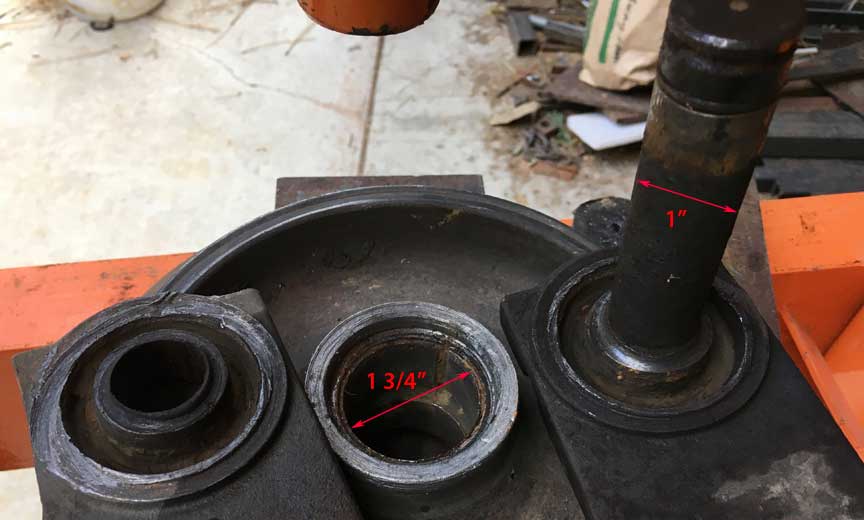

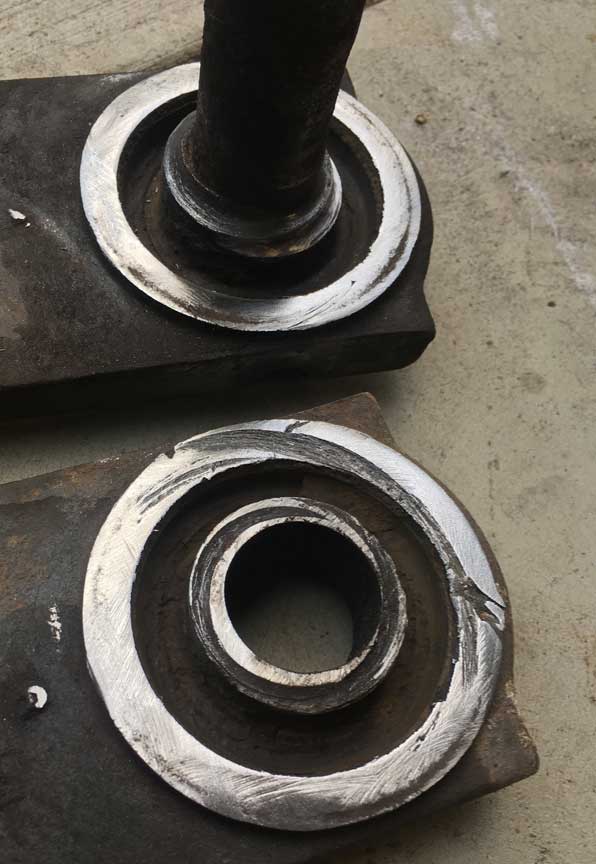

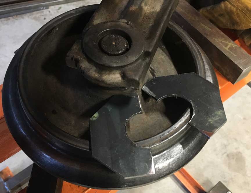

I wonder what kind of lube it uses. Or dry? No serviceable parts, there is no grease fitting, simply is a "2,000 hour" wear part. It has 1363 hours on it, total failure, 3/8" of slop in the wheel bore to axle. The wobbling wheel/roller destroyed every surface, even the seal bores and the yoke support arms.
Of course I'm thinking I can get a new one and put a grease fitting on it. I ordered the new idler parts, I suppose they will arrive in a week or two. Very easy install.
Anyway I "powered on", invoking my dear old Dad. Pics below. Word of warning, if you're squeamish, or just ate your lunch, turn away from the computer screen NOW! Don't say I didn't warn ya!
481874d1474486768-rebuild-track-idler-help-kubota-kx41_track_idler1-0-jpg
Heres the idler wheel unit. It simply slides out of it's slot, held in by track tension.

I can't even tell what kind of bearing was in there. The hole is 3/4" bigger than the shaft.
481876d1474486768-rebuild-track-idler-help-kubota-kx41_track_idler1-8-jpg

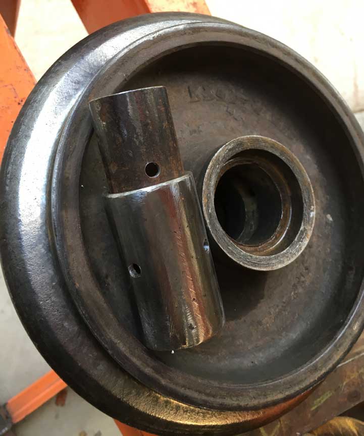

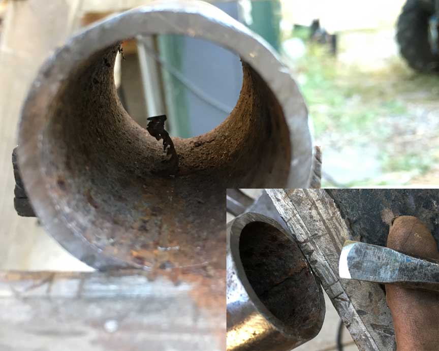

OK now get this. My iron pile is only about 6 years old, and for the 1st 3 years was basically NOTHING when I had curtailed my desires to drag stuff home, and quit for awhile. So how in the HECK do I have two pipes in stock that make up this slop almost perfectly? GOOD CLEAN LIVING that's how !!! And bringing a little stuff home, good materials only. I highly recommend it. But be careful what you drag home, everything is a project.
Anyway the bigger pipe had to be sanded down a little and it pressed in. Note the predrilled grease holes. The little pipe has about 1/16" slop on the axle, and about 1/16" slop to the bigger pipe.
481880d1474488421-rebuild-track-idler-help-kubota-kx41_track_idler1-7-jpg
I had to chisel the seam out of the bigger pipe. I ground a chisel round first.

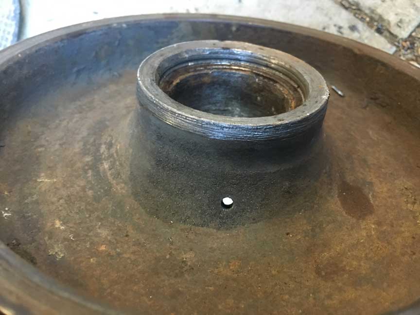

481877d1474486768-rebuild-track-idler-help-kubota-kx41_track_idler1-9-jpg
Ground the thrust sides flat.
481881d1474488945-rebuild-track-idler-help-kubota-kx41_track_idler1-6-jpg
Drilled a grease hole.
481878d1474486768-rebuild-track-idler-help-kubota-kx41_track_idler2-0-jpg

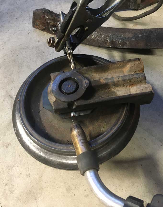

Put it all together with one thrust washer on the other side. But it still had 1/8" slop which couldn't be dealt with by adding a washer because of a nested snap ring. Not assemble-able if washers take up ALL of the slop. So I made a washer split in two.
481879d1474486768-rebuild-track-idler-help-kubota-kx41_track_idler2-1-jpg
Welded the washer halves together and now I'm out in the woods diggin again!
Thanks Dad!

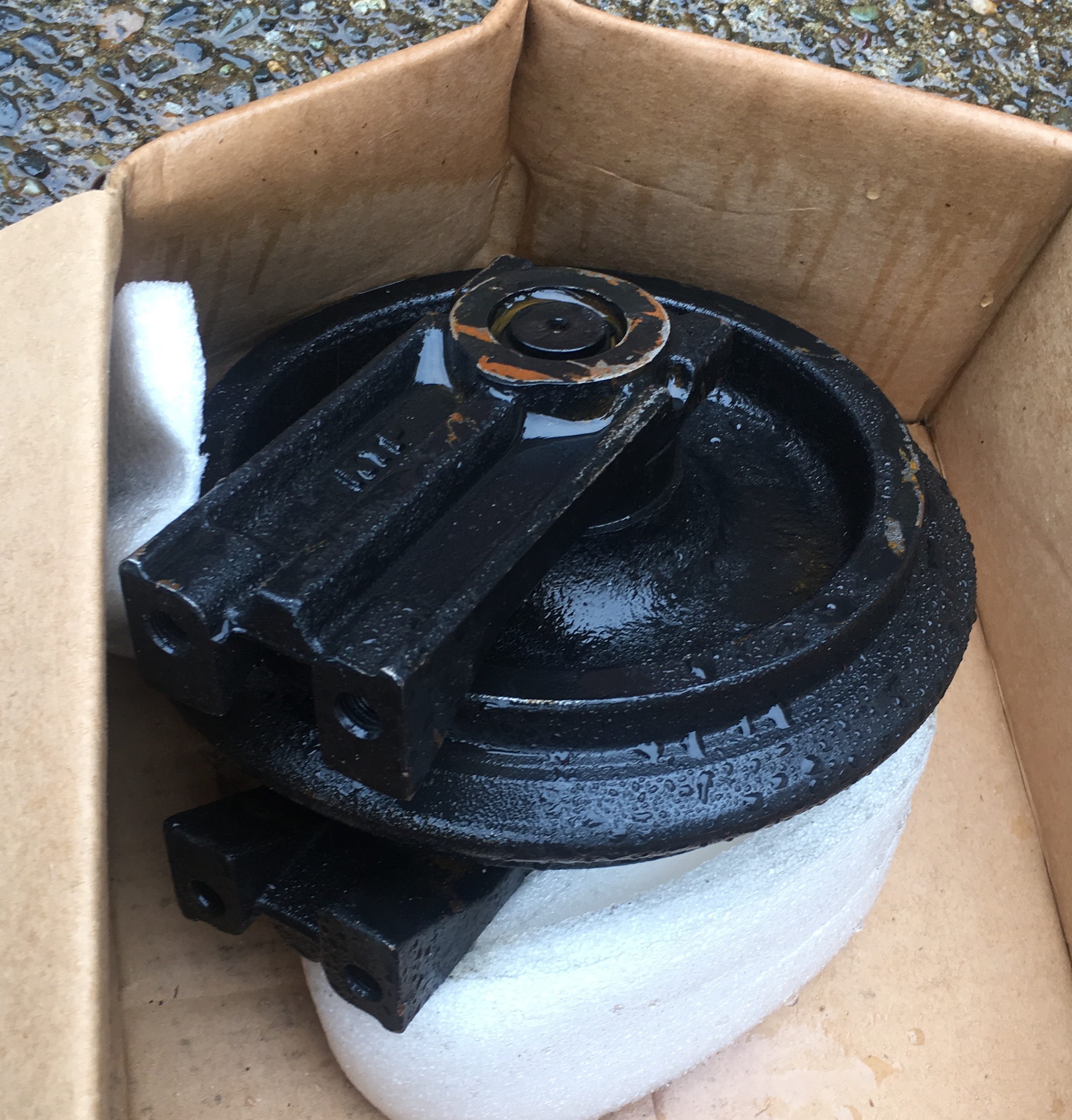

Got my new idler, next time the track is off I'll replace it. I'm interested to see how the shadetree bearing fared.
This, according to the maintenance schedule, is simply a "2,000hr replacement item".
I'm wondering if I oughtta drill & add a grease fitting -or- if its supposed to run dry. It has a rubber seal - I wonder if theres grease in there now? Prob no passage for grease to pump out, but as it wears loose there will be. Who knows about these things?

I didn't run it out, only dug a few days on it.
Which is not really normal for me.
I like to know how long my shadetree repairs might run, and especially if the replacement is in-hand, why not?
In this case...... because whenever a track comes off, it's kind of a hassle, and work :D stops in its tracks :D.
so I decided to install the new one.
Cost Sept 2016 was $230 + $45 shipping.

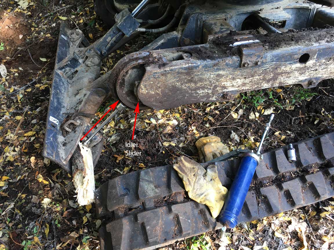

Incidentally getting a track back on,
I've used a crowbar, and loosen the grease fitting
but not actually take it all the way OUT, just relieve some pressure.
some grease comes out,cuz theres a relief slot in the threads.
Operate the track motor very slowly.
KX41 is small enough you can operate the drive lever while
holding a crowbar to guide/stretch the track back on.
I think I must have done this at the sprocket, but could have done it at the idler. Sorry I can't remember.
And wish I had a vid, but I only have two hands and this is a 3 or 4 hand job as it is.
It would be far better to have a 2nd person helping.
And somewhat dangerous too, think about where that bar could go.
