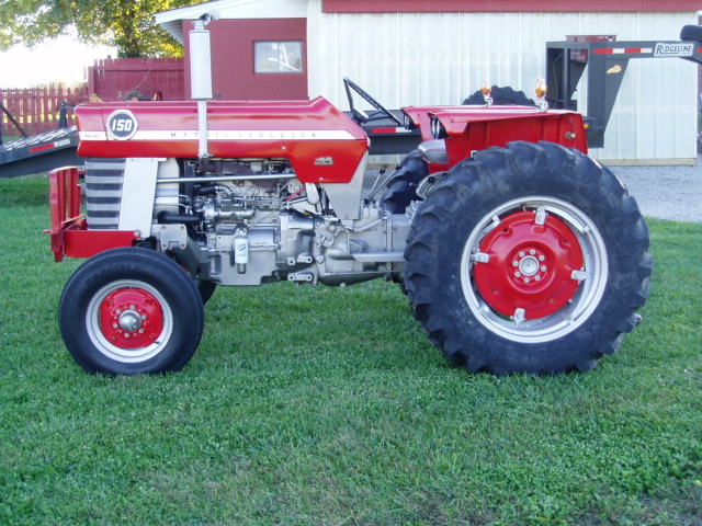

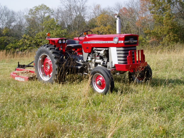

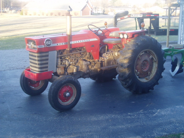

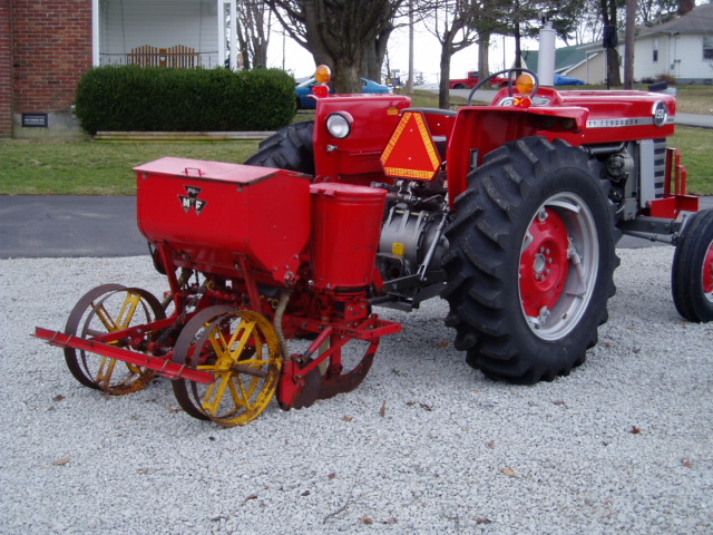

I started off with a tractor that was in near perfect mechanical condition. A few things got attention while I had various parts in disassemble. But over all, I didn't have anything major to do. (see photo #5)
Throw in an estimate of 250 hrs on ebay, craigslist, ect, looking for ORIGINAL parts, not REPLACEMENT parts. (ie, steering wheel center cap, top link, a gauge, and a few dozen other items)
Because the 100 series Masseys aren't "stone age" quite yet, there's still a better than not chance of finding used or NOS parts, and they are still popular enough that replacement parts are still VERY easy to get.
There was NO labor paid out on mine. There was a LOT of labor. Depending on the level of detail, there can be anywhere from a few days to several MONTHS of work. Even YEARS. No kidding....People spend that sort of time restoring tractors. My wife referred to mine as "his street rod" while I was obsessing over small details.
I still use mine quite a bit. The "resto" was 3 years ago. It looks like a 3 year old tractor... Oh well.
I'd start with a GOOD dealer in the area. (any brand, start by looking MF/AGCO, then ignore brand) They all like business. (should?) Most shops work on other brands. Find one that'll take care of ALL the mechanical issues. Cross that off the list. Then stand back and look at what you have, decide how much to spend on looks. That same dealer will probably know of someone in the area who paints tractors. (Lotta folks do that)
165's are great tractors. Sounds like it may be time for a clutch (pto & drive). A loader will be slow. The 100 series used a high pressure/low volume hydraulic system. (4.6/4.8gpm??) Loaders cycle slow. You CAN use a front mount pump, or a pto pump, but I'd learn to live with the slow cycle times.
As far as worth, I paid $4000 and change for my 150 in 1971. When I went through it 3 years ago, I spent about $3200 including a real bargain on tires. Again, ZERO labor cost. An "average" 150 will sell for about $4200/$4500 here. Nice ones bring $5500+. I've had a few offers, but don't consider some of them "legit". With 3 years work (450hrs), I could get "nice one" money still. Was it worth it in dollar terms? Barely, if at all. Your 165 should parallel that to an extent. Just don't look at it to be a profitable venture. It's not. It's just spending money.
I don't plan on selling mine. It's VERY reliable, efficient, and I'm familiar with it. Making it last another 38 years was important too.

Farm, that is a dang nice looking 150! Dont put that thing in a dirty old field, lol. TB

Too late...It's piled up over 450 hours since those pictures. Mostly bush hogging, but also hayin', about 25 acres of plowing, some discing and hauling a lot of firewood. I figure I'll paint it again in another 38 years.
Thanks!
