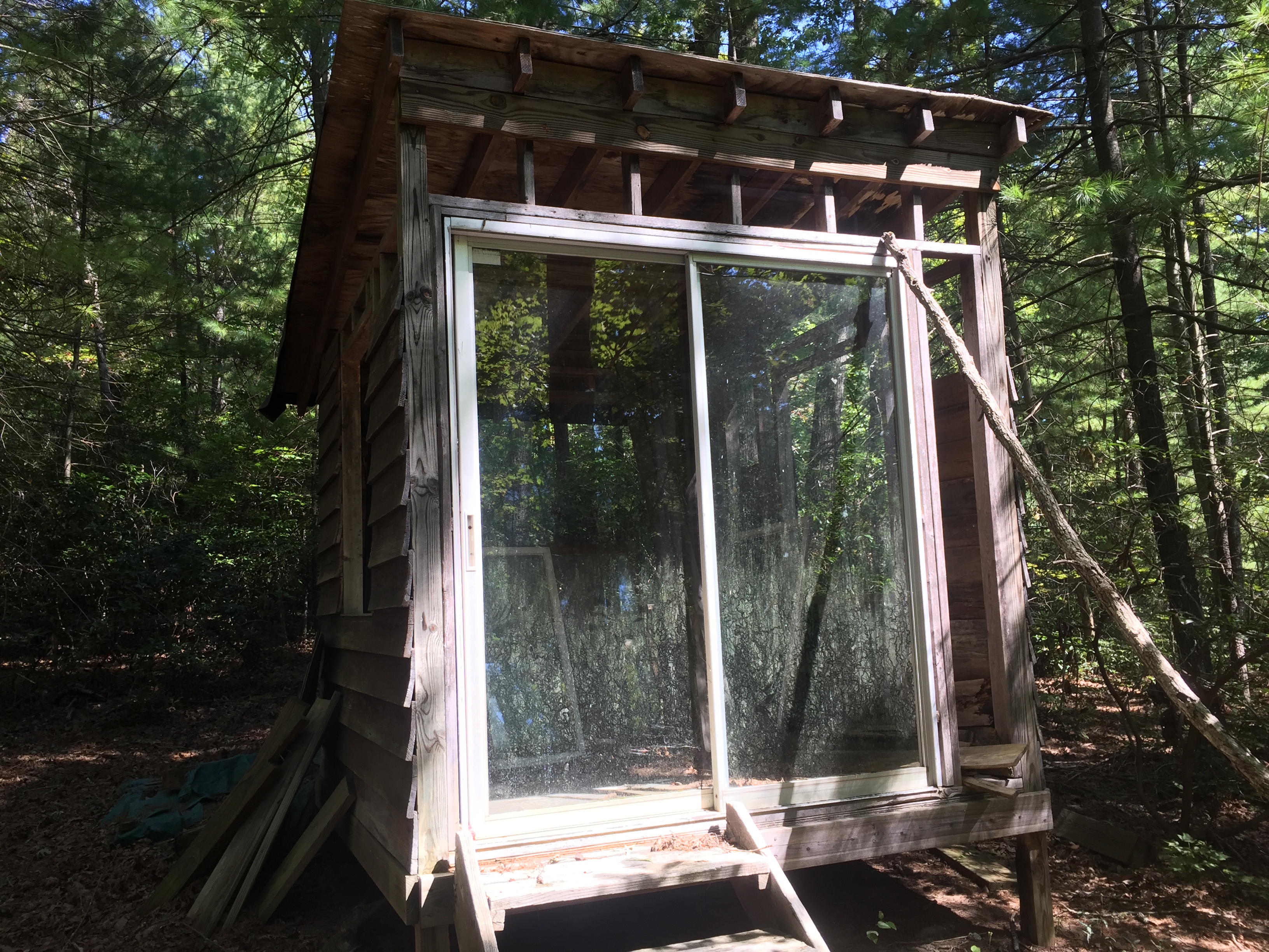

When we bought our land, there was an old shack on it, about 30 yds from the road and 75 yds from the pond. I spoke to the adult daughter of the man who had purchased the land, and had the pond built, more than 20 years before and she said it was built by one of her brothers to be a hunting cabin. It was built with dimensional lumber and reclaimed materials. A patio door had been installed and the windows were present but looked to have never been installed. Two of them were broken the third looked to be damaged from rot. When it was built, I imagine that it had a view of the pond, and since it was situated facing roughly south, it probably had decent solar gain with glass front, but over the years, pines and mountain laurel had basicluy covered it up and it got no sun at all any more and was barely visible from the road.

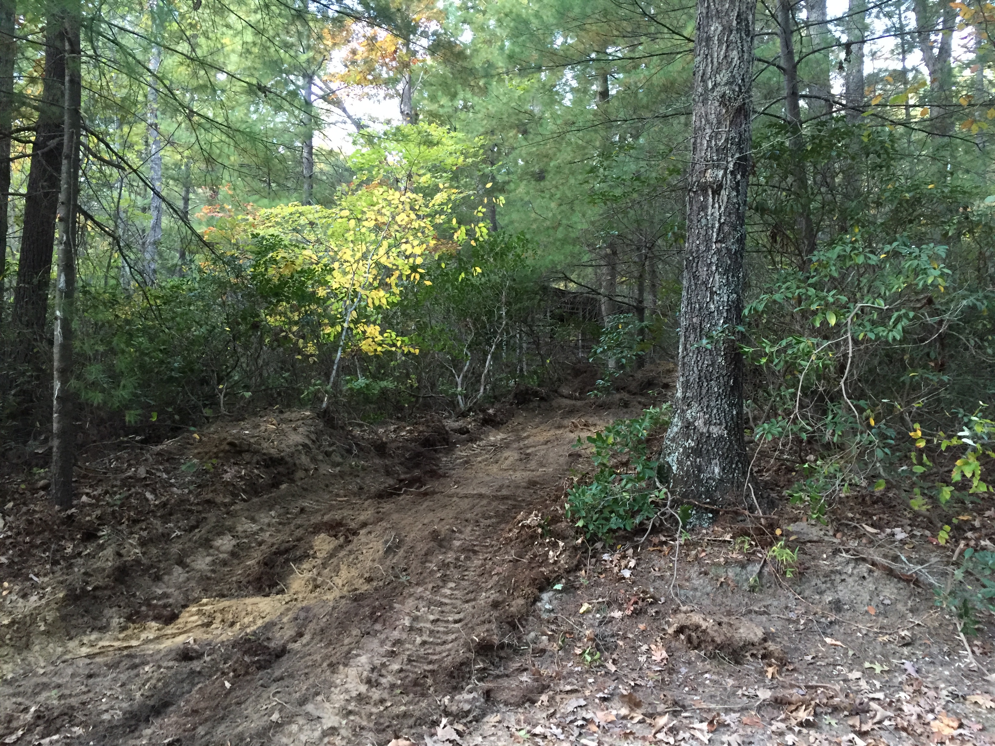

were planting our first group of trees for the orchard, we actually used the shed to store the trees from weekend, to weekend. But it was very quickly obvious that the shed was falling down. The roof was rotten thru and if you stepped on some spots of the floor they would break thru as well. One of the first things I did when I got my tractor was use the loader bucket to push back some of the mountain laurel between the road and shack, to create a spot to park the tractor. Even with that material removed, you could still hardly see the shack.

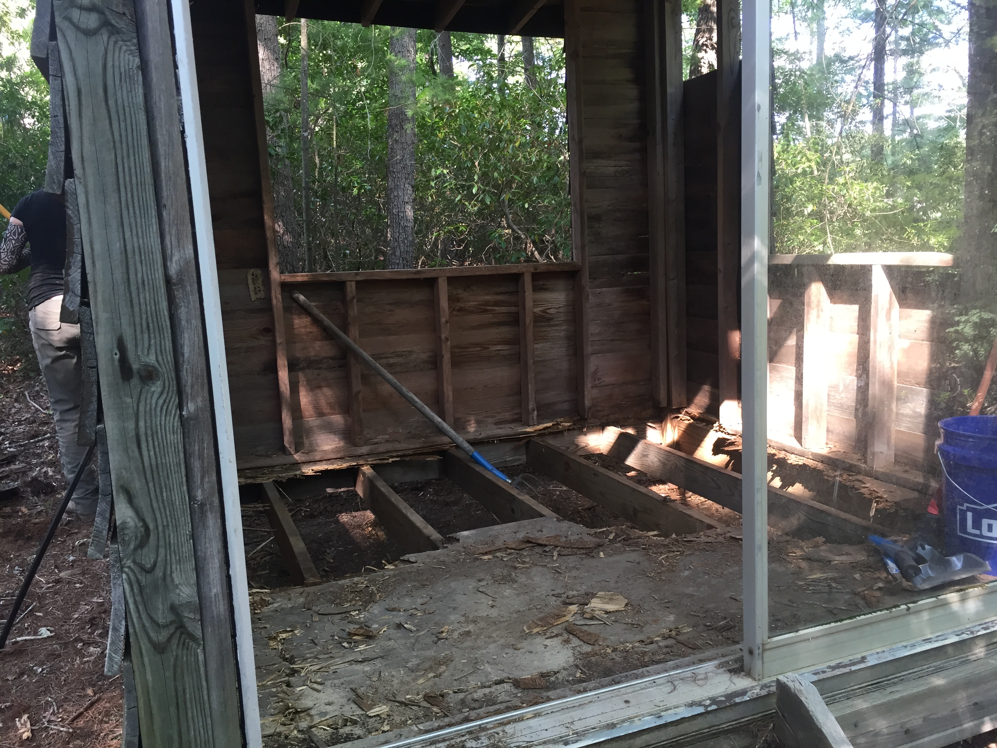

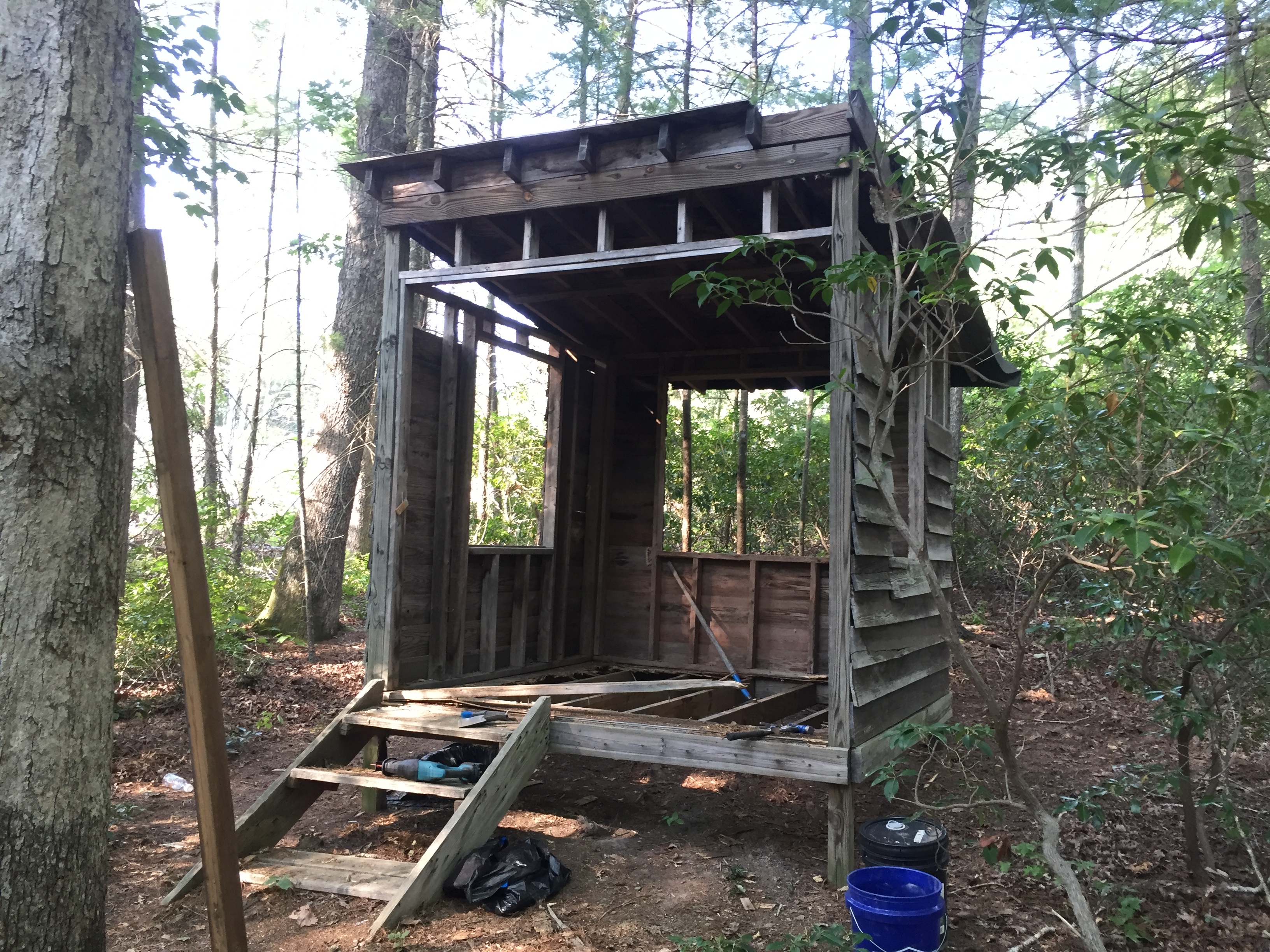

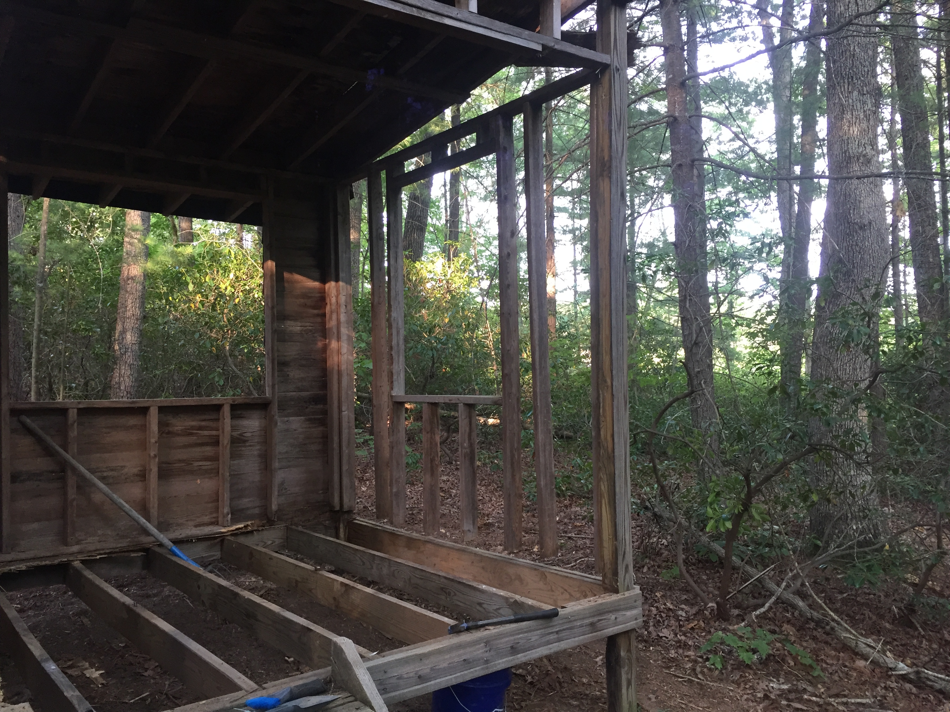

As we tore into the shed a little more it began to be apparant that the floor joists were still good, most of the roof joists were still good. But there was significant insect damage and rot to the cedar siding and the wall studs. The more we dug, the worse it seemed to get.

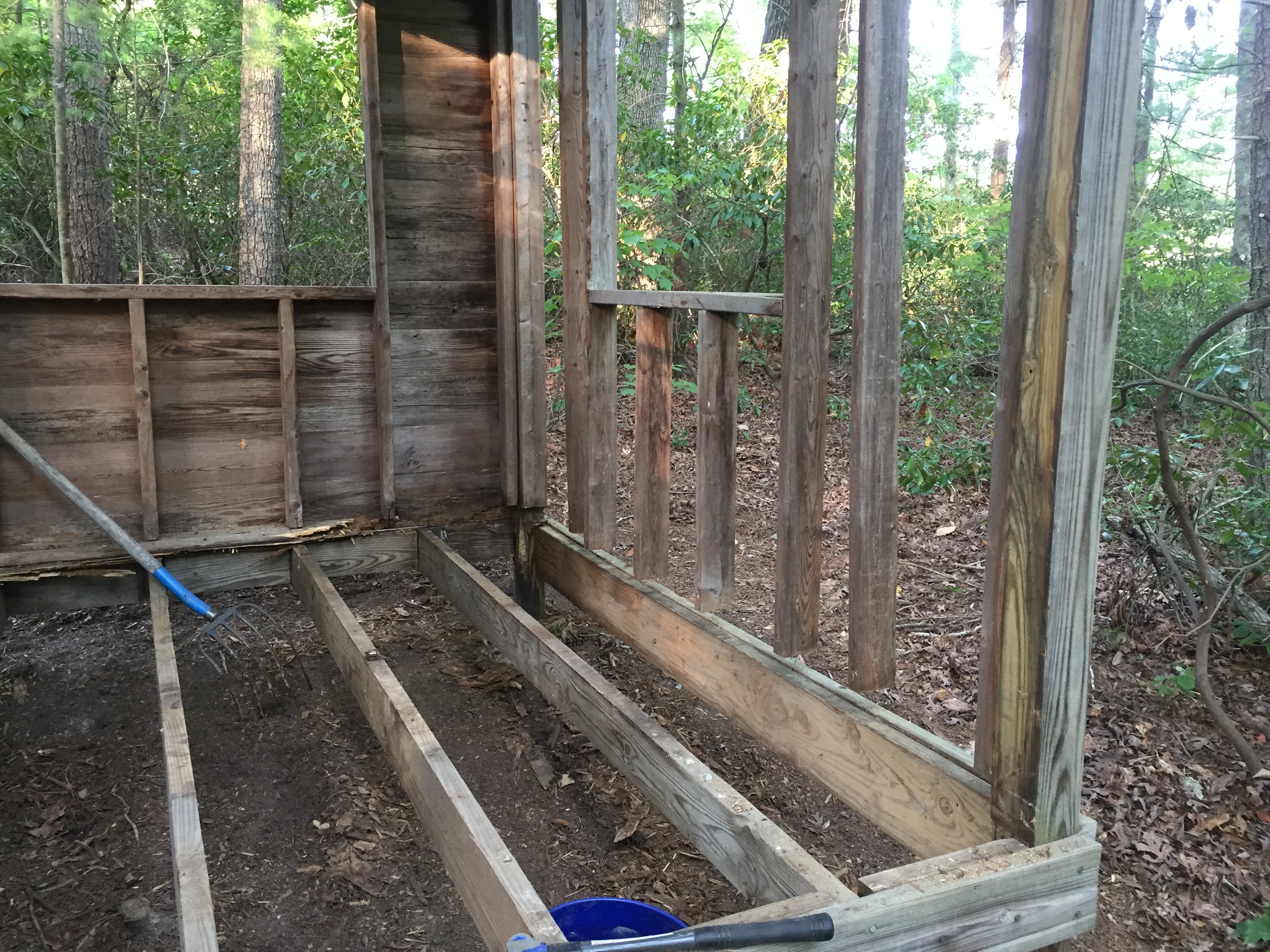

There was also evidence of an animal chewing it's way into the shed from underneath. Not sure if it was a squirrel or racoon, but something had chewed on the 4x4 supports to get into the structure. Part of the problem with the building is the materials that were used. The posts and joists were treated lumber, but studs were not so they were more suceptible to rot. Also the plywood that was used for both the floor and the roof was not exterior grade plywood. The roof was done with rolled asphalt paper and under the best conditions probably would have only lasted 15 years, if that.
So, instead of just new roof and floor, I now needed to rebuild the walls. But I still felt it was better to rebuild this instead of starting from scratch.

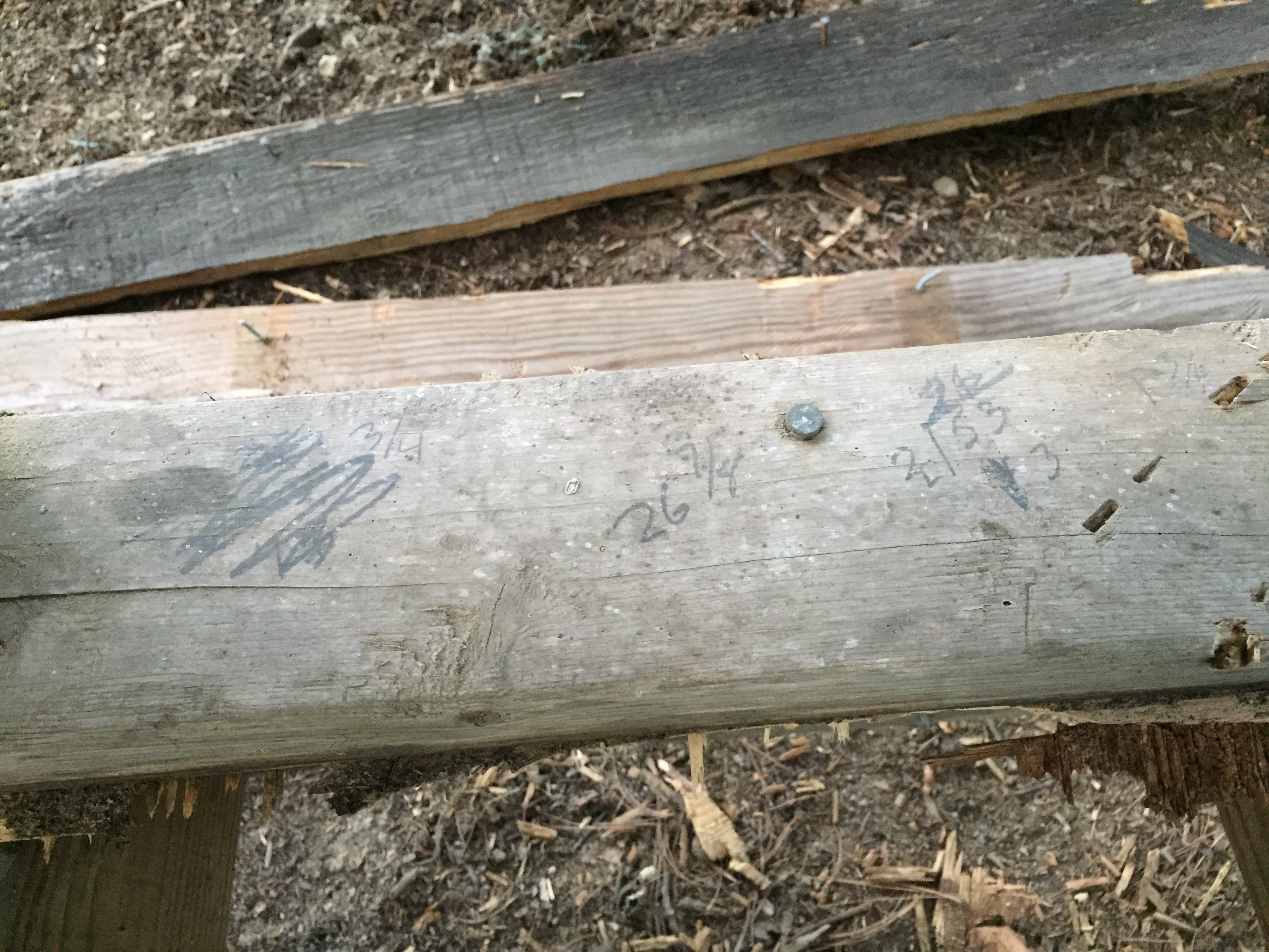

While tearing out some of the old siding, I found a piece that looked like it had been used to do some of that math for building the structure in the first place. There is no significance to this, but it was cool to find.

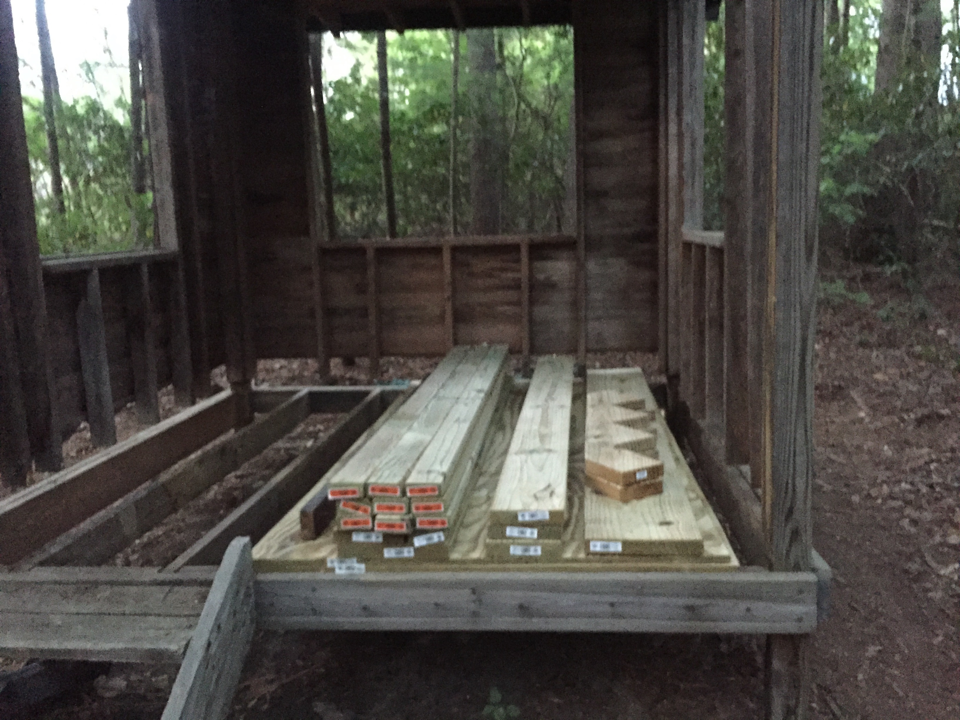

So I went to the store and got some materials to put in a new floor and rebuild the wall studs.
The area behind the shed was logged in 2016 so it gets a lot more light. As I was sitting there looking over everthing I got the realization that if I cut down a couple smaller pine trees I could expand the foot print of the shed and make it much more useful. I was already going to be doing more work to it that I originally intended so I might as well make it something that will be useful for a long itme.
I decided to follow the same general lines of the existing structure, even though I didn't like the way it had been designed and built. without any written plans, I just flowed with it. "Be like water". That quote went thru my mind many times while moving forward with this build.
