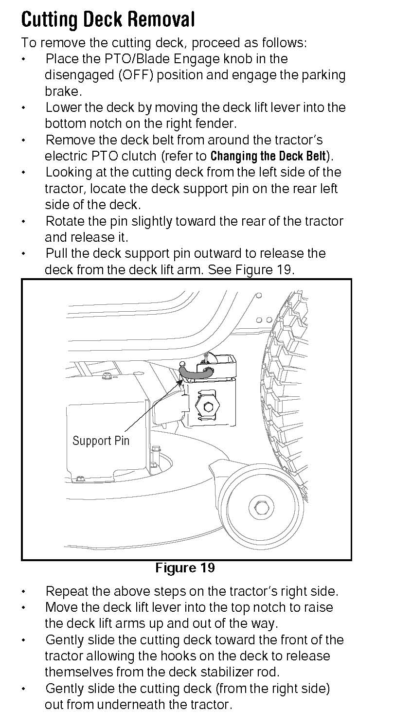

can someone please tell me how to attach the deck lift pins,(looks like a question mark bolt with spring and pin) attaches.

The SLT 1550 deck removal, might be the same for your Cub deck.

Thganks Tankman A Great help! I thought that may be the way I diassembled but wasnt real sure. Thanks again.:)
