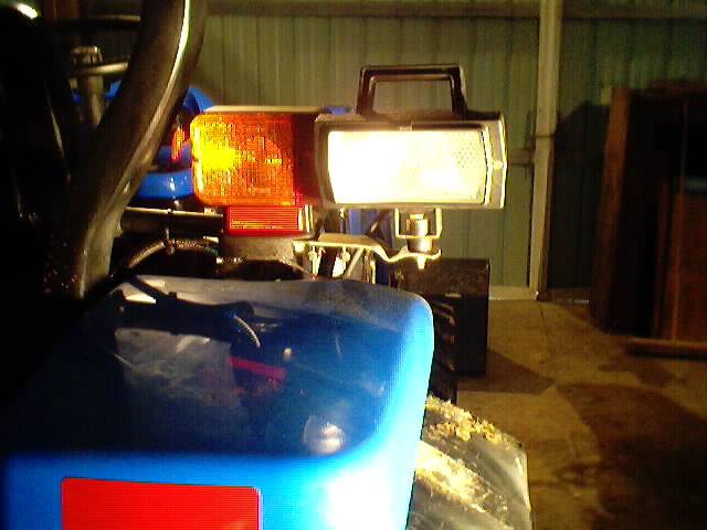

I am considering the purchase of a TC40D and do not see anywhere that factory rear worklights mount on the ROPS and the salesman was unable to tell me. Therefore, where do the factory rear worklights mount on a TC40D?

I can't say for sure on TC40, but on TC45, two dealers mounted them two different places. First dealer mounted them on the notch at rear of fenders. I presume he had to drill holes for the lights. Second dealer mounted them beside the flasher lights with a strap iron bracket that looks like it bolts to the flasher lights. This is the setup I have. Will try to get photo soon and post it if you're interested.

Bill--thanks for the info--a picture would be very much appreciated.
   / rear worklights--where #4
Let's see if this works. I don't have much experience with camera or attachments either one.
Bill

My TC service manual (for the 35D, 40D & 45D) shows it mounted on the opposite side of the ROPS from the flashers (inside) & at the same hight. I don't know what they charge for it as a factory option, but it is just a single 50 watt light. I just installed extra lights & an accessory power outlet on mine this weekend & am just itching to put them to the test on a long snowy night time workout. I chose to install them on the bottom side of the top of the ROPS because the factory headlights are pretty useless when you have the loader on & in a carry position. (if you put them on the top side of the ROPS you can no longer fold your ROPS down fully) I put four lights on total. Two facing forward & two rearward @ 55 watts per bulb. I have one flood & one trapazoid beam facing each direction for close & more distant illumination. Works pretty well as near as I could tell from the short trial I gave them. If you do it yourself, be prepaired to spend some time if you want to make it look nice & clean. I think the money & time I stuck into mine is well worth it. FYI the alternators put out 40 amps & the setup I described above pulls just over 18; so you can still run the factory head lights too & everyting should still be all right. I don't think I would want to add too many more than I did though without looking for a more powerfull alternator. Happy lighting.

NH also makes a bracket that mounts just to the other side of the flasher in the picture you have. so that the light mounts behind the seat between the rops bar its in the parts book under work lights if your dealer can not find it
